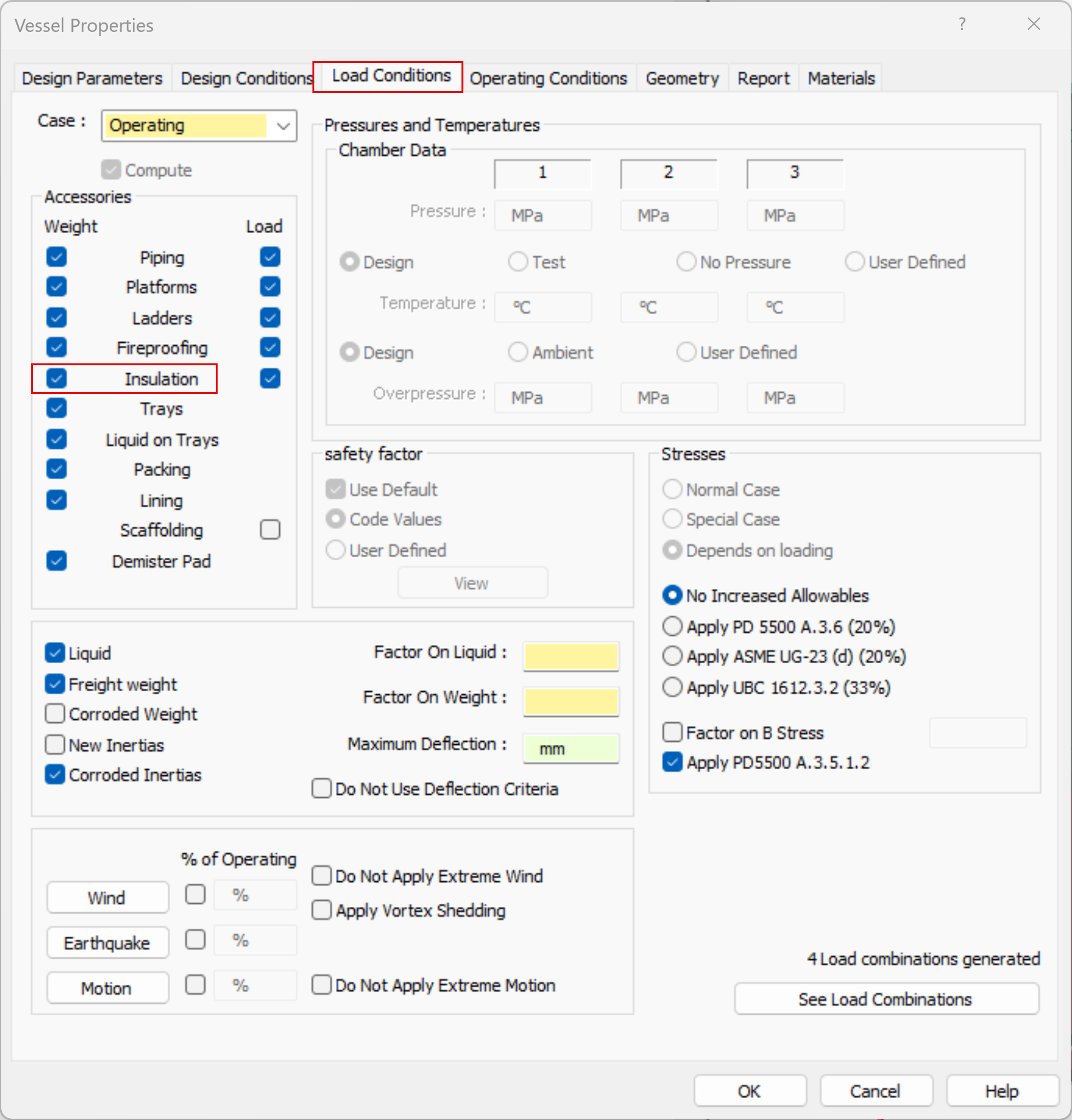

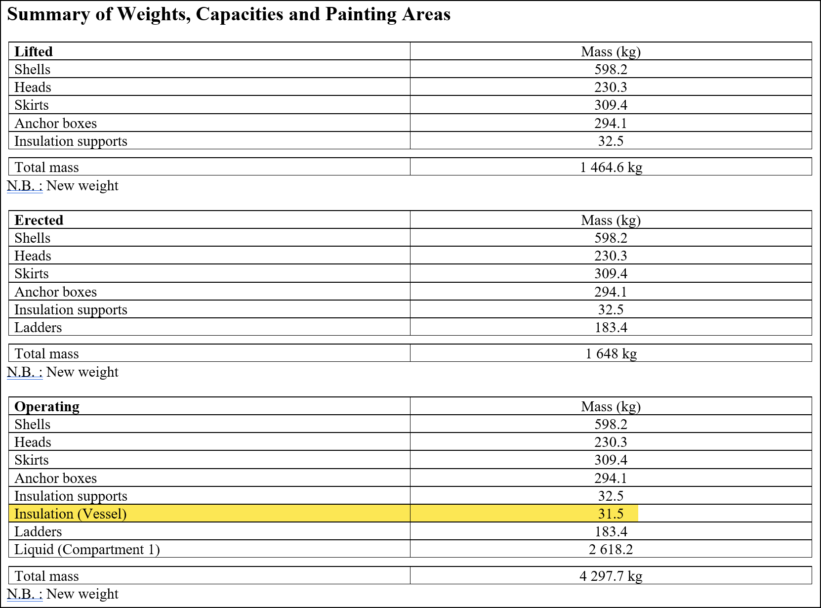

2. Where is insulation mass reported, and in which load cases is it included?
The calculated insulation mass is reported in the Summary of Weights section of the calculation report under the load conditions where insulation weight has been enabled.
The inclusion of insulation weight is controlled through:
Vessel Properties > Load Conditions
If the Insulation Weight option is selected for a specific load case, AutoPIPE Vessel includes the insulation weight in the corresponding calculations and reporting.
3. Is insulation mass included in operating mass, test mass, foundation loads, and vessel combination loading calculations?
When insulation weight is enabled for a load case, it is included in:
  • Operating Mass
  • Foundation Load Calculations
  • Support Reaction Calculations
  • Vessel Combination Load Calculations
  • Global Vessel Analysis
For Hydrotest/Test conditions, insulation weight is generally not considered because insulation is typically installed after hydrostatic testing. Therefore, hydrotest load cases normally exclude insulation weight.
