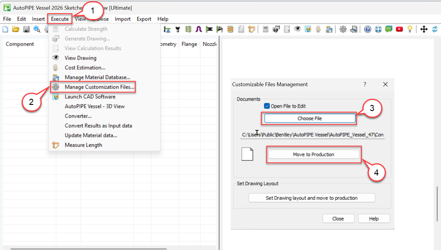

4. Can users add custom gasket materials?
Yes. Users can add Custom gasket materials.
This allows organizations to maintain gasket information consistent with their engineering standards and approved vendor data.
5. How can custom gasket materials be added?
Custom gasket materials are managed through AutoPIPE Vessel's customization functionality.
Procedure:
- Open Execute > Manage Customization Files.
- Access and modify the gasket.xlsx file.
- Add or update gasket records as required.
- Move the updated customization file to the Production environment.
- Restart AutoPIPE Vessel if required to ensure the changes are recognized.
