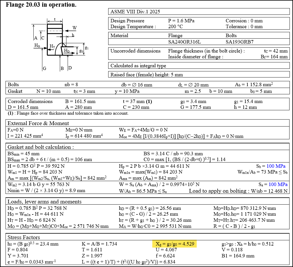

When analyzing a model in AutoPIPE Vessel the following warning number was reported.
369    FLANGE 25.01: the hub thickness ratio is > 4.5.
Why and how to avoid it?
Answer:
This warning is generated when the flange hub taper ratio,
Xg = g1/g0
is greater than 4.5. In the displayed calculation report:
Xg = 15.4/3.4 = 4.529 > 4.5
therefore the warning is issued.
