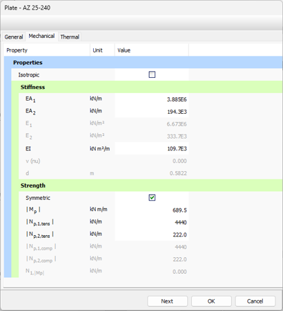

PLAXIS material dataset
Figure 1. Material dataset for the anisotropic elastoplastic plate model showing the derived AZ 25 parameters entered in PLAXIS 2D.
Summary of derived parameters
The table below summarises all derived input values for the ArcelorMittal AZ 25 section:
Table 1. Required input parameters for the anisotropic elastoplastic plate material model in PLAXIS 2D.
Parameter Value (AZ 25) Unit
w 1.42 kN/m/m
EA1 3.89 × 106 kN/m
EA2 1.94 × 105 kN/m
EI 1.10 × 105 kN·m²/m
Mp 690 kN·m/m
Np,1,tens 4,440 kN/m
Np,2,tens 222 kN/m
