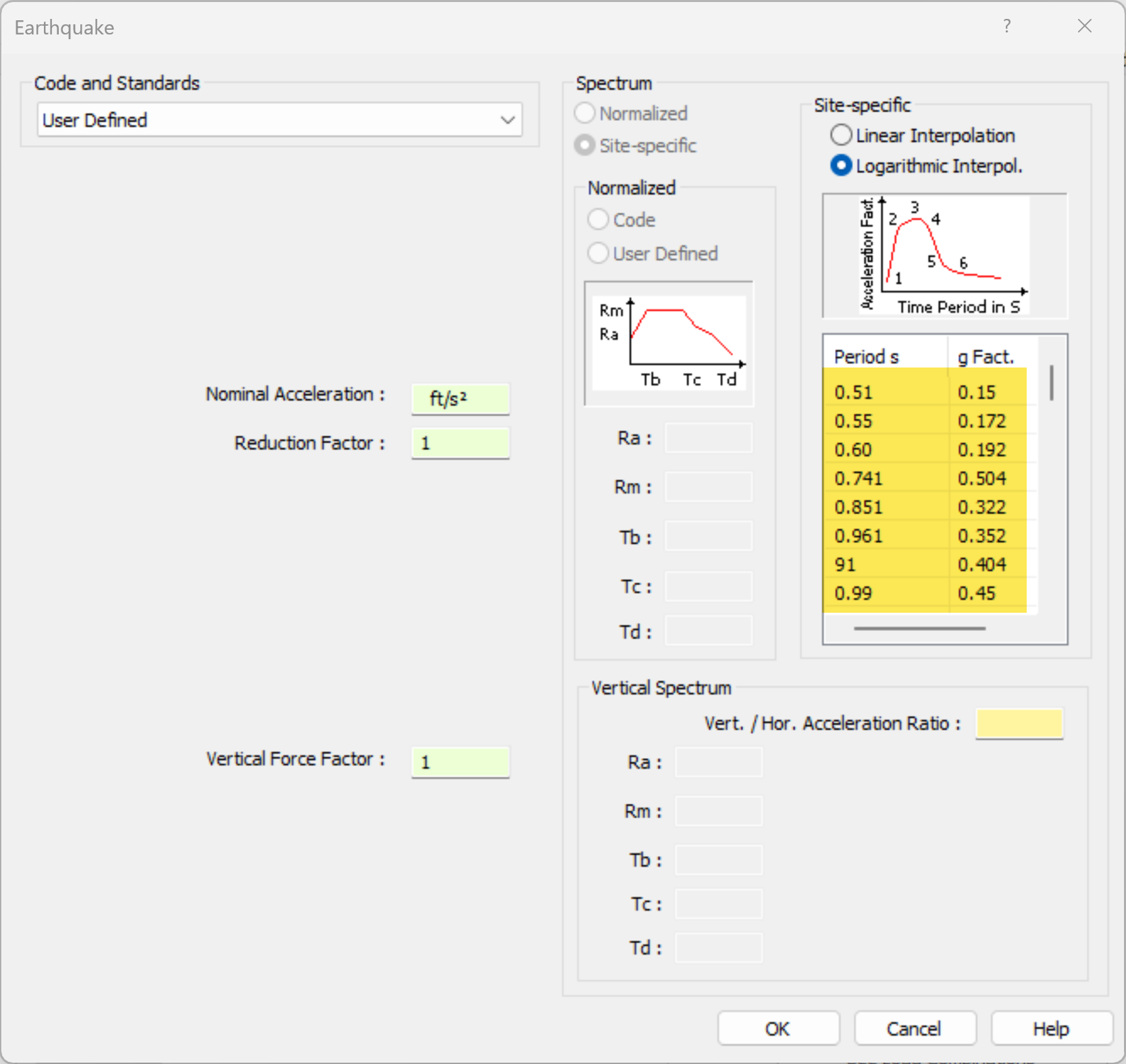

How many rows can be entered for User Defined Site-Specific Spectrum Seismic Data in AutoPIPE Vessel?
A user has a spectrum consisting of 960 data points (rows). Can all 960 rows be entered into AutoPIPE Vessel?

AutoPIPE Vessel allows a maximum of 50 rows for defining a site-specific response spectrum.

Currently, there is no workaround available within AutoPIPE Vessel to increase the maximum number of spectrum data points beyond 50 rows.
If the source spectrum contains more than 50 points, the spectrum must be reduced to 50 representative points or fewer before it can be entered into AutoPIPE Vessel.
Steps
    1. Review the original site-specific spectrum data.
    2. Identify key points that define the spectrum shape, including:
      • Peak values
      • Changes in slope
      • Critical transition regions
    3. Reduce the dataset to 50 points or less.
    4. Enter the reduced spectrum data into the User Defined Site-Specific Spectrum table.
