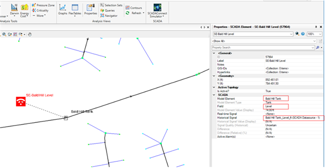

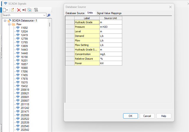

Below an example of the SCADA signals name/tags and units in WaterGEMS (that need to match those defined in the sensor administration page of WaterSight)
Below an example of a SCADA element created in the WaterGEMS model and mapped to the associated model element (in this case tank level).

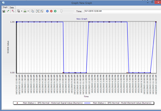

Imported overrides are defined in the WaterGEMS model and allow the user to have the system operate as it did at the time of the specified historical simulation (inferred from the historical scada data). By default, Imported Control Overrides take precedence over 'Regular' Controls. If there is a conflict between a Regular and Imported override, the Imported override will take precedence. If you want the "Regular" Control Override to take precedence, you can increase the priority.
When the calculation option Automatically Import Control Overrides is set to True and the SCADA calculation simulation mode is Historical or Historical (Live Training), pump status and valve status will be imported to Active Control Overrides. First, the existing control overrides are cleared. Then, new control overrides are imported from SCADA data and used in SCADA calculation. When there is conflict between pump (or valve) control and SCADA signal, SCADA signal pump (or valve) status are used in control pump (or valve) status. Only pump and valve statuses within simulation time range are imported.
The following is pump status result comparison with SCADA signal when Automatically Import Control Override is set to false in SCADA simulator Historical calculation. At some calculation time steps, the pump status is different from SCADA signal.
The following is pump status result comparison with SCADA signal when Automatically Import Control Overrides is set to true in SCADA simulator Historical calculation.

  1. Create SCADA signals in the WaterGEMS model, and the tag names need to match those defined in WaterSight
  2. Create SCADA elements and map signals to model elements

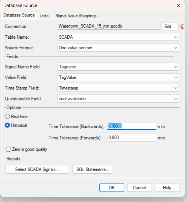

1. Create SCADA signals in the WaterGEMS model (or updating existing tags)
The SCADA signals created need to have the same tag names as the sensor tags defined in WaterSight which match the tags or ID used in the data source (database or API). To add new SCADA signals to the model or to update existent SCADA signals tags (to match tags in WaterSight), the easier method is to use ModelBuilder tool inside WaterGEMS. Video below describes both use cases.

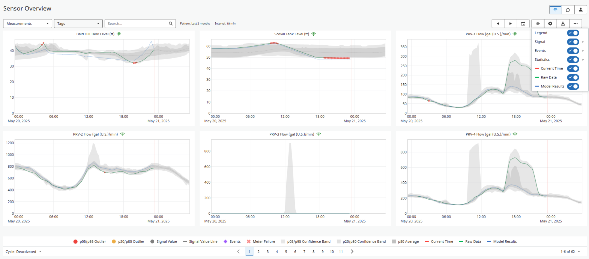

Comparing sensor data with modelled data
As mentioned above, it is also possible to directly compare measured data with modelled data (in case SCADA elements are created and mapped in the WaterGEMS model file, see above). Once sensor elements are configured in the hydraulic model and associated to the model element, then it is possible to directly compare in the same graph the real sensor measurements with the modelled results to check the accuracy of the hydraulic model. It is important to highlight that this comparison can be done for any sensor that is associated with a hydraulic model element - any sensor type that is contained in the table 1 above.
To see the comparison between the modelled and measured data, the simplest workflow is to go to Network Monitoring >> Sensor Overview >> and turn on model results. Model results will be displayed as a blue line in the graphs.
More detailed information can be found here - Comparing Modelled data with Measured data.

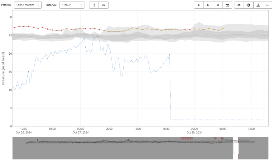

Why model data does not match sensor values for the boundary elements?
In case it is noted that the model values in WaterSight do not match the sensor values for the boundary elements (for example tank levels, PRV settings) please make sure that the units defined for the SCADA signals in the uploaded WaterGEMS model matches the units defined for the sensors in the WaterSight in the Admin >> sensors and are the same as in the database. More information here - Why Model data does not match Sensor values?
Fig 1 - Model value at blue does not match sensor measurements (black line) for the PRV boundary element due to mismatch of units defined in the hydraulic model and in the sensor configuration template
