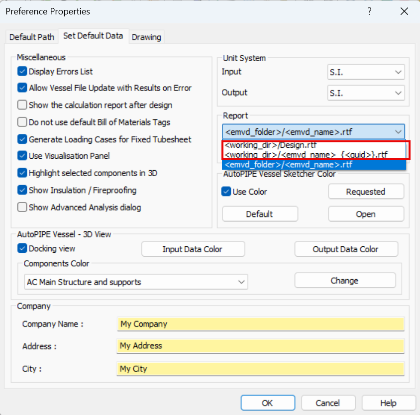

2. Optimize Report Generation Location

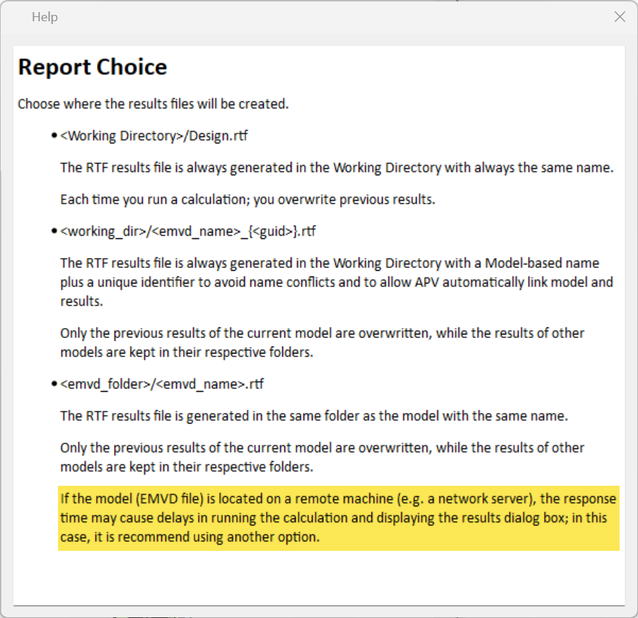

If the model must be stored on a network location, configure the report output path to use one of the first two report generation options available in Preferences.
Menu Path: File > Preferences > Set Default Data
Using a local report output location minimizes network traffic during report generation and can significantly improve performance.
Refer Help Section for details:

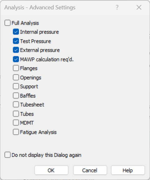

3. Run Only Required Calculations

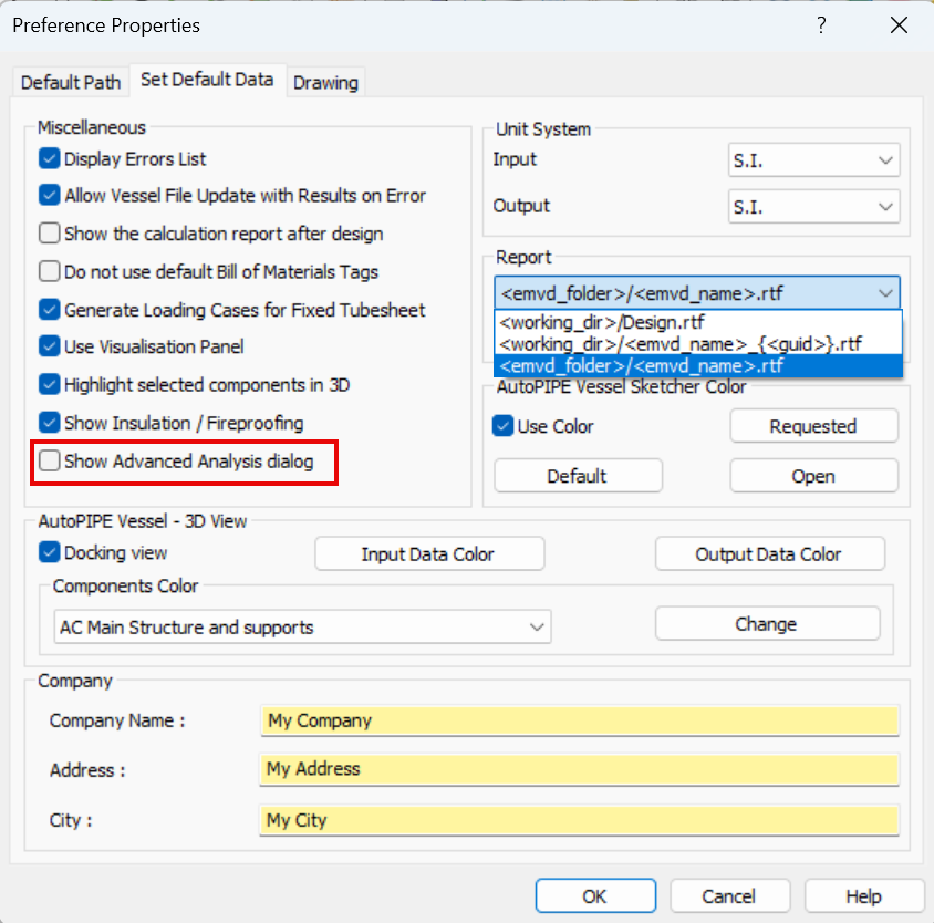

For faster analysis, configure AutoPIPE Vessel to run only the calculations currently required.
Enable the Advanced Analysis Dialog
      1. Go to File > Preferences > Set Default Data
      2. Enable Show Advanced Analysis Dialog
This option allows users to select only the required analysis modules before starting a calculation.
Benefits

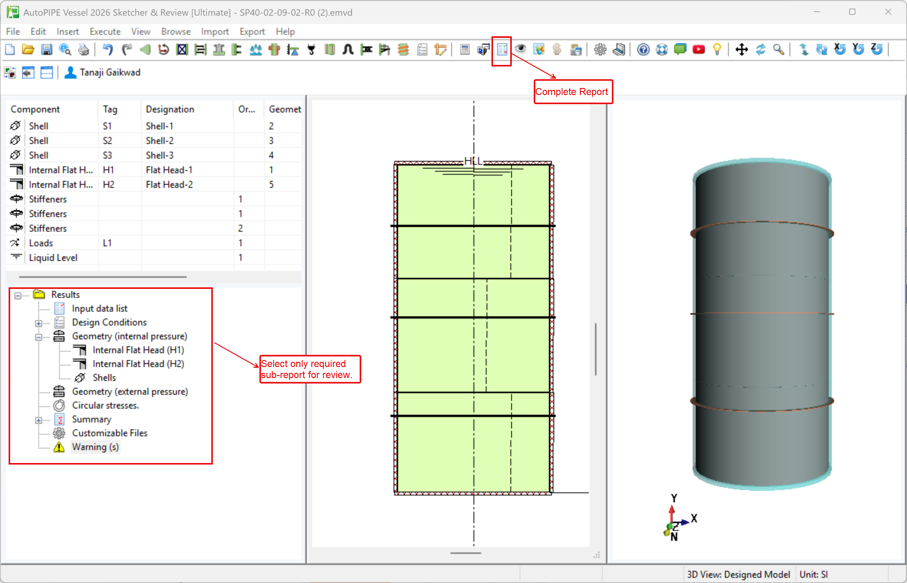

6. Use Insight Results for Quick Reviews:
When reviewing results:
This approach reduces report generation time and improves overall responsiveness.
