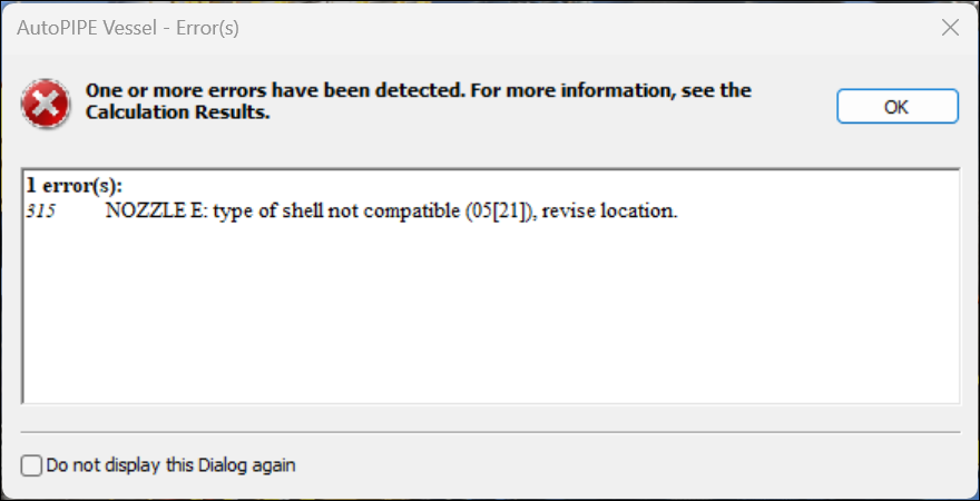

Error Code 315 - NOZZLE E: type of shell not compatible (05[21]), revise location.
The following Error message appears when running the program:
315        NOZZLE E: type of shell not compatible (05[21]), revise location.
How to avoid this error.

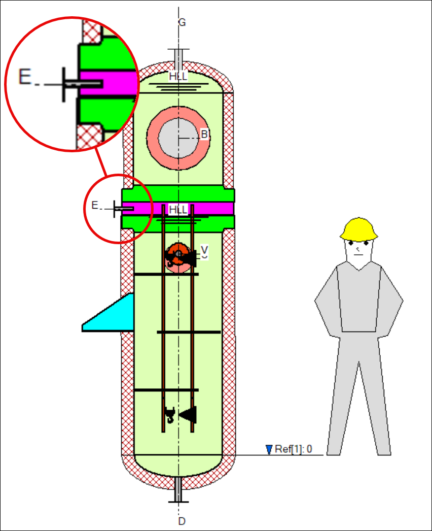

This error occurs when a nozzle is placed on a parent component that is not supported for nozzle attachment.
In the reviewed model, Nozzle E is connected to a Tubesheet, which is not a valid location for nozzle placement in AutoPIPE Vessel.
The software restricts nozzle connections to specific compatible shell types, and Tubesheets are not included in the supported list.
To resolve the issue:
      1. Relocate the nozzle from the tubesheet
      2. Place the nozzle on a supported parent component, such as:
        • Cylindrical shell
        • Head (e.g., elliptical, hemispherical)
      3. Re-run the analysis

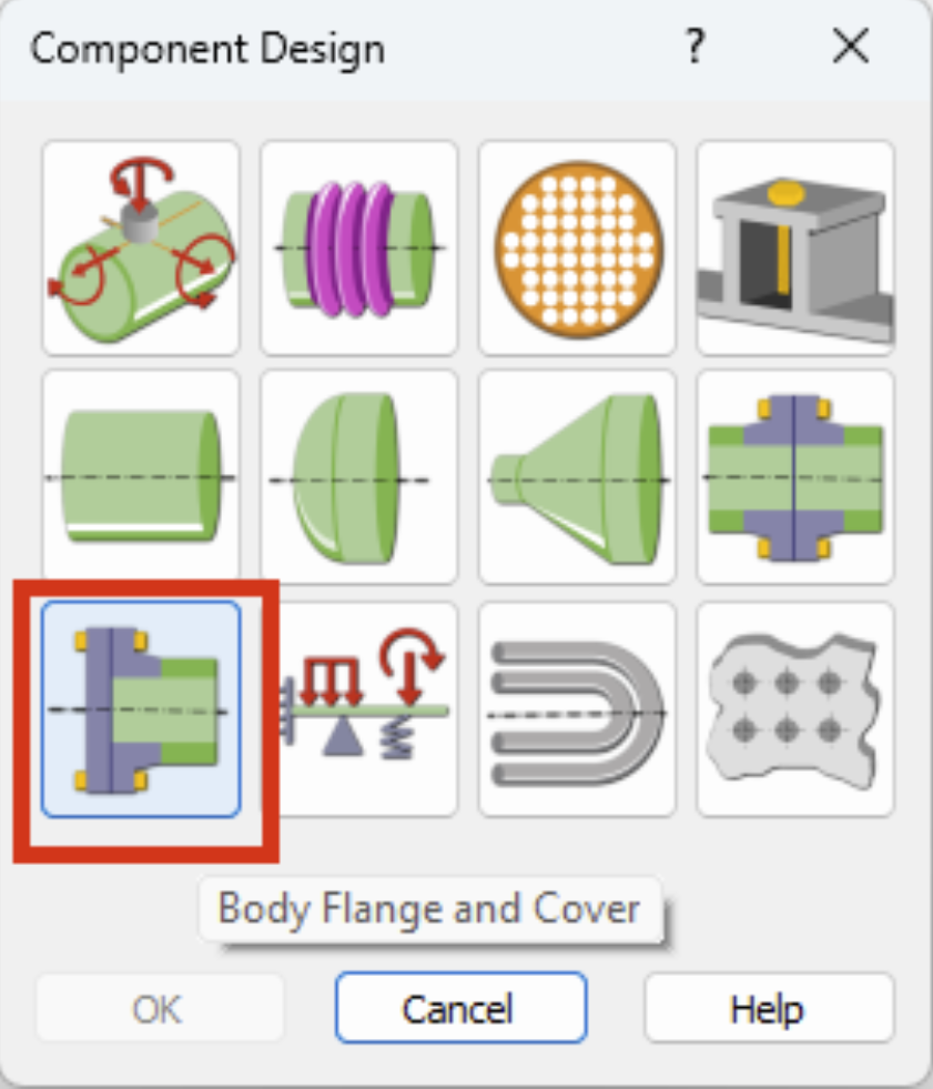

Workaround:
Use Component Design to evaluate:
    • The nozzle neck as a cylindrical shell.
    • The flange attached to the nozzle.
