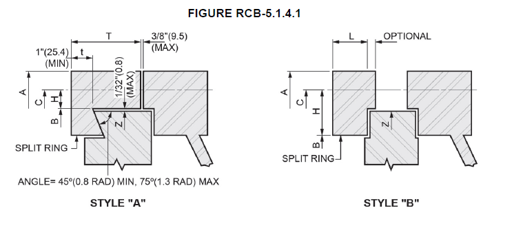

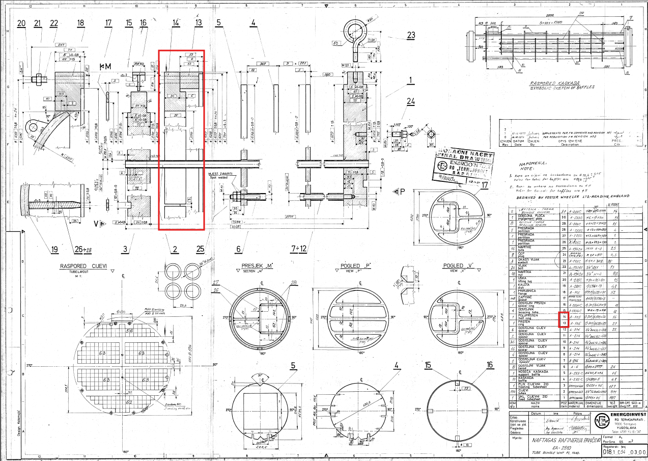

Is it possible to create a model for a split-ring configuration used in a floating head heat exchanger (as shown in the reference drawing)?
If yes, how should the geometry be defined in AutoPIPE Vessel to accurately represent the highlighted component?
Yes, it is possible to model and perform calculations for a floating head heat exchanger in AutoPIPE Vessel.
For this configuration:
- The exchanger can be modeled as an AES-type heat exchanger.
- The split ring can be represented using the B-type split ring configuration available in the software.
Important Limitation:
While the analysis can be carried out correctly:
- AutoPIPE Vessel does not support creating an exact geometric replica of the split ring as shown in detailed fabrication drawings.
- Split Ring Style A & B can be modelled in AutoPIPE Vessel.
- The software uses standardized design representations based on code-compliant configurations rather than exact fabrication geometries.
