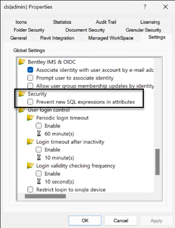

  • ProjectWise Administrators can now enable a Security Setting: Prevent new SQL expressions in attributes.  Once enabled, this will require ProjectWise CEL to be used for any new attribute configurations or editing existing attributes.

  • The transition will occur in stages:
    • May 2026 – Administrators can enable the setting “Prevent new SQL expressions in attributes”
    • August 2026 – ProjectWise will default to having the setting on.  An Administrator can toggle this off if more time is needed
    • November 2026 – The setting will be permanently enabled
5) Do we need an updated version of ProjectWise Administrator to enable/disable this setting?  
  • Yes.  Administrators will need ProjectWise Administrator 26.00.00.8017 or later
