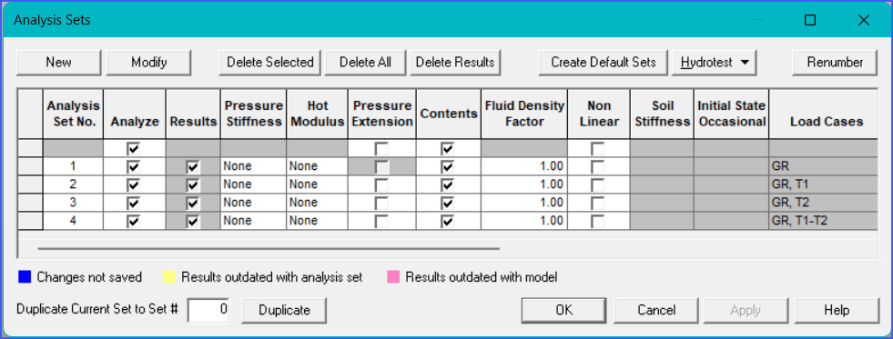

What temperature is used to determine the value of Sh in a code-compliant calculation for the sustained category when the model has multiple defined analysis sets?
Example: Model piping code is ASME B31.1 2024, 2 temperature cases, and 4 analysis sets
- T1 = -20 deg F
- T2 = +800 deg F
- Ambient = 70 deg F
- Analysis set configuration:
The sustain allowable calculation or this specific piping code is single material property, Sh. Will the allowable be based on the hot allowable from T1, T2, or both T1-T2 for all analysis sets imaged above?

- Analysis Set #1: Sh based on T2 temperature
- Analysis Set #2: T1 is the only temperature case, Sh based on T1 temperature
- Analysis Set #3: T2 is the only temperature case, Sh based on T2 temperature
- Analysis Set #4: T1 and T2 are added to this set, AutoPIPE will compare all relevant values present in Set 4 based, reporting the result for the case with the most conservative condition / lowest allowable at each point.
Question: Why is Sh based on T2 in analysis set #1?
Answer: When a combination contains (LONG) and (HOOP), and if the analysis set does not contain a temperature case, AutoPIPE will compare all temperature cases in the model, reporting the result for the case with the most conservative condition / lowest allowable at each point; which is T2 in this example.
