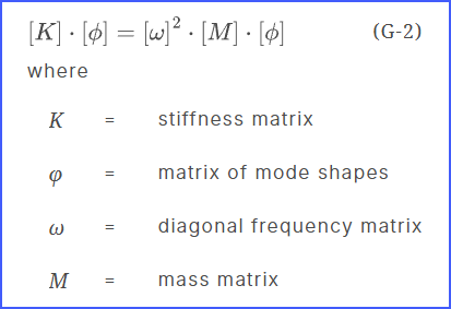

Once more, AutoPIPE lumps the mass of the pipe, components, and contents at the associated node points. Analysis requires this information to take the form of a diagonal matrix referred to as the Mass Matrix, meaning there are no mass coupling terms between different degrees of freedom at different nodes. Each node typically has three translational mass degrees of freedom (X, Y, Z). Rotational mass is generally ignored, except at points with eccentric weights, where up to three additional rotational mass degrees of freedom may be included.
The nature of the mass matrix simplifies the dynamic equations, as each mass point acts independently in terms of inertia. The general form of the eigenvalue problem for modal analysis is:
For more information see AutoPIPE help Modal analysis Theory:
