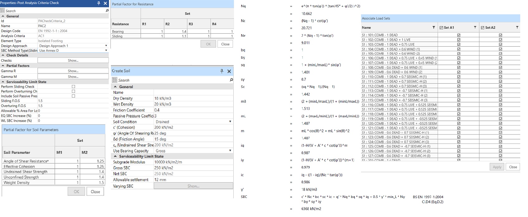

Stability checks to Eurocode 7 (EN 1997-1:2004):
The bearing and sliding checks of shallow foundations - isolated, combined and mat foundations without piles - can now be optionally performed in accordance with Eurocode 7 Part 1 (EN 1997-1:2004).
The following are the key features of this implementation.
- Automatic selection of the partial factors for action, materials and resistance based on the user-specified Design Approach along with the generation of favorable and unfavorable load combinations for the checks.
- Automated calculation of bearing capacity in accordance with Annex D, based on the user-specified drainage conditions and properties of the soil.
- Generation of detailed calculation report based on EN 1997-1:2004, for the bearing and sliding checks.

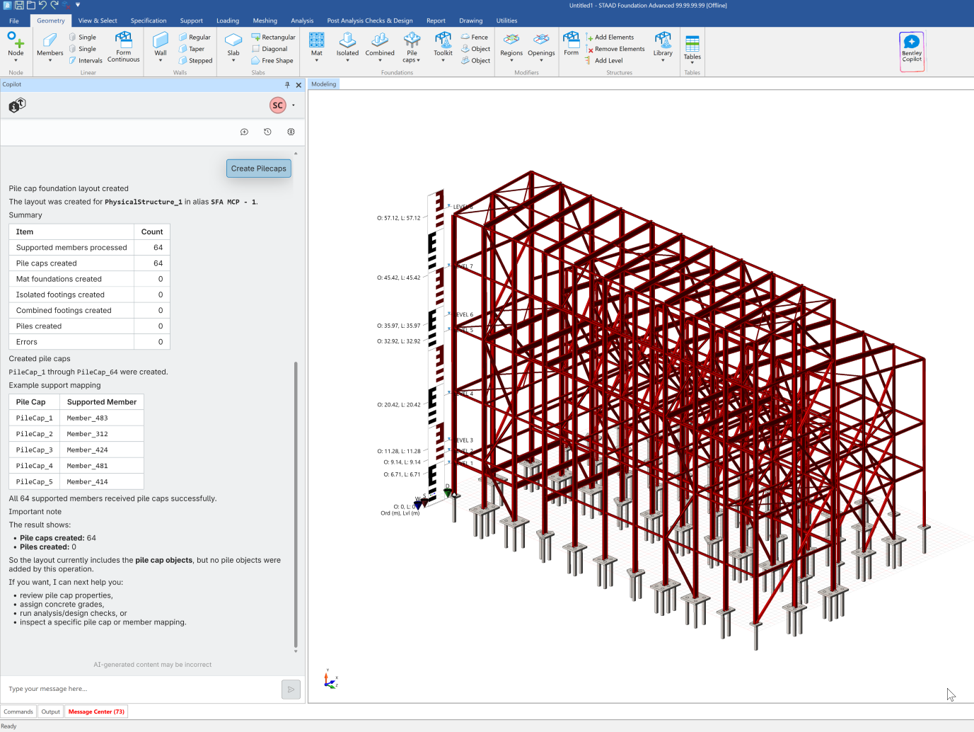

Bentley Copilot:
An AI-driven assistant tool is now available to help perform modeling, analysis, and design through natural language user commands. The tool is designed to improve the usability of the application, especially for new and less experienced users.
Integration with other AI agents:
STAAD Foundation Advanced now supports a native MCP server that can be used to activate key functionalities—modeling, analysis, and design—through natural language commands via external agents such as Anthropic Claude. Like Bentley Copilot, this integration enhances the overall usability, especially for new and less experienced users.

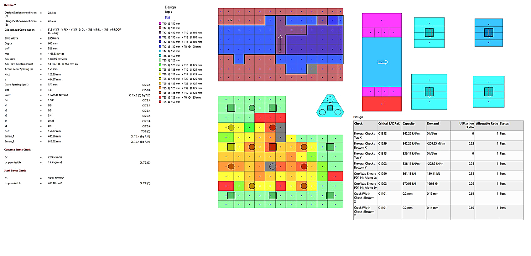

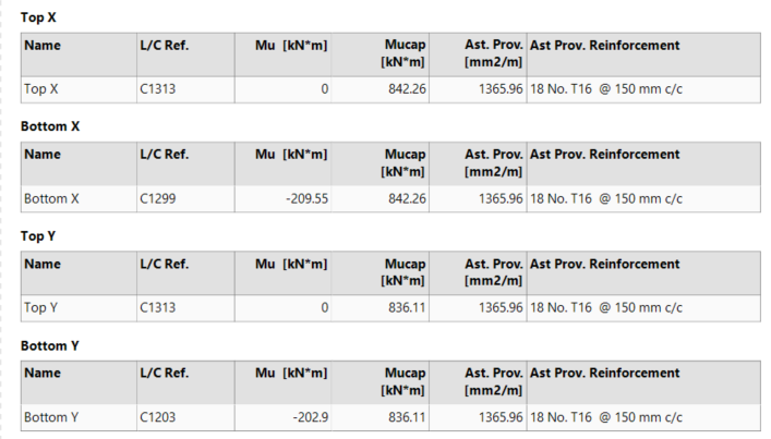

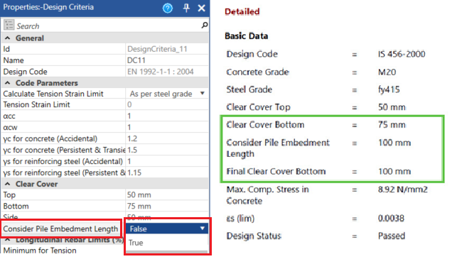

- Updated flexure design report: The flexure design report has been updated to display the reinforcement information in the format bar_dia@spacing c/c, in addition to the already displayed reinforcement area per unit width format.
- Pile cap effective depth modification: The pile embedment depth is now considered for the effective depth calculation of pile caps and mat foundations with piles.

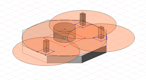

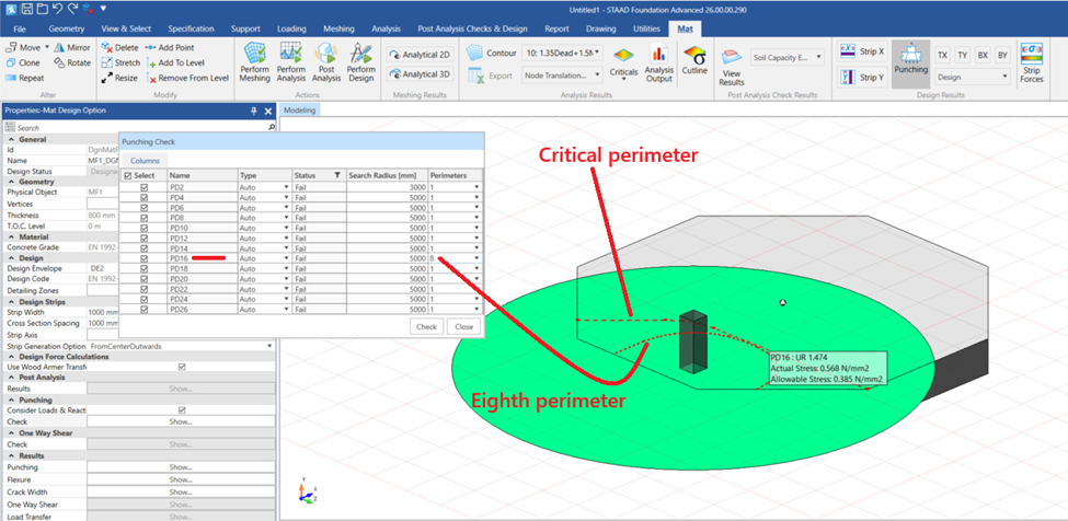

- Modified punching perimeter view 1: The application has now been enhanced to show multiple punching perimeters within a search radius, if they exist. Previously, the program displayed the critical punching perimeter only.
- Modified punching perimeter view 2: The view of the punching perimeters has been updated to show the perimeters of only the selected objects associated with the punching shear check. Previous versions showed the punching perimeters of all objects of a given foundation leading to visual clutter in certain cases.
