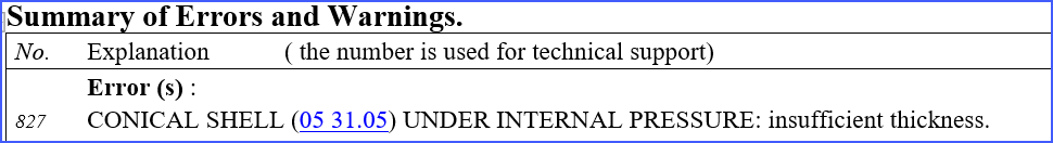

Error Code 827 - CONICAL SHELL UNDER INTERNAL PRESSURE: insufficient thickness.
Question:

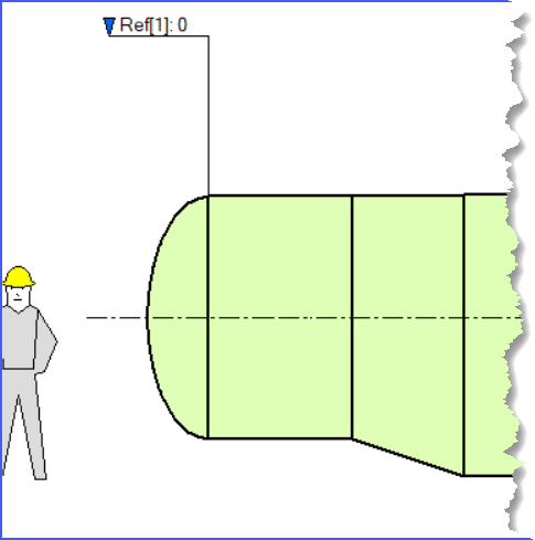

The following message appears in AutoPIPE Vessel, how to avoid it?
827       CONICAL SHELL UNDER INTERNAL PRESSURE: insufficient thickness.
Given the following Pressure Vessel configuration:

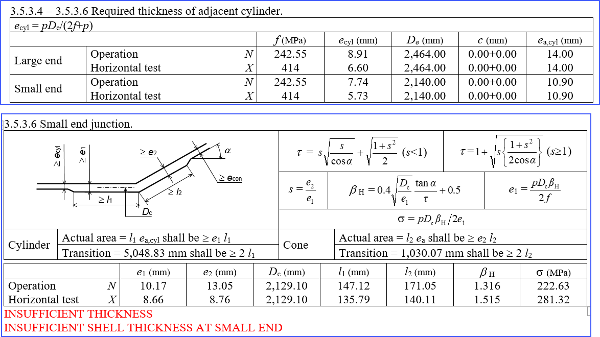

Answer:
in this case, this message is due to a bad program behavior that attempts to align the cone's thickness with that of the adjacent shell, which is unnecessary.
There is no workaround; the message can be ignored, and the calculation results are correct.
