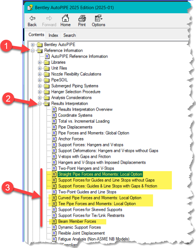

This article will answer questions related to AutoPIPE's local axis directions. Users should have already reviewed AutoPIPE's help section on "Local Axis Option: Straight Pipe Forces and Moments" (AutoPIPE help section: Help ribbon> Contents button> Contents Tab> Reference Information> Results Interpretation>

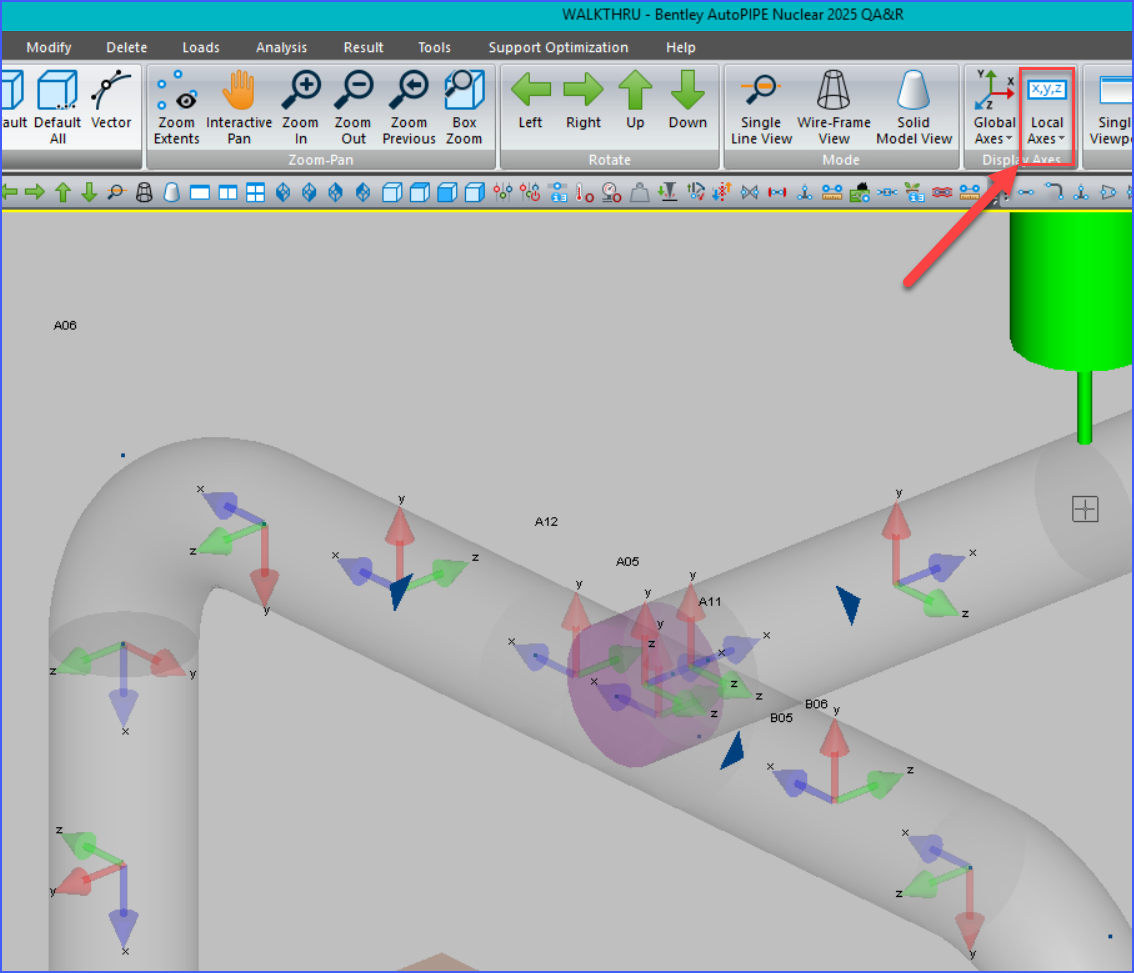

In addition, users should already know about AutoPIPE's feature to show local coordinate indicators (View > Display Axes > Local Axes > Local Axes)

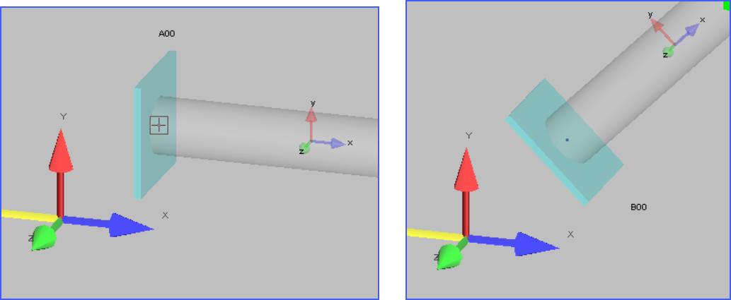

Question #1:
Confirm our understanding of the local axis orientation for an inclined/non-vertical straight pipe in AutoPIPE, specifically when reviewing straight pipe forces and moments using the Local Axis option.
Assumption:
Vertical longitudinal / vertical axial plane
The vertical longitudinal plane is defined as:
Since Global Y is the vertical/up direction in this case, this becomes:
For an inclined pipe, local y lies in this plane, is perpendicular to local x, and points generally upward.
Therefore:
Vertical longitudinal plane = local x–local y plane
Answer:
To answer a question like this, suggest starting a new model in AutoPIPE, model this pipe and turn on the Local Axis as mentioned above.
Yes, the assumption is correct, for an inclined pipe, local Y-axis lies in this plane, is perpendicular to local x, and points generally upward (as imaged above).

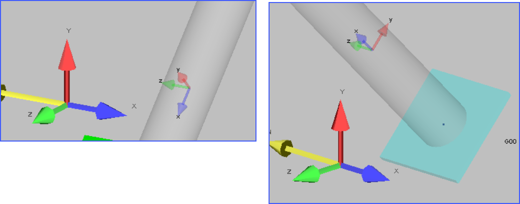

Question #2:
Horizontal longitudinal / horizontal-side axial plane
The horizontal-side longitudinal plane is defined as:
This plane is normal/perpendicular to the vertical longitudinal plane while sharing the same local x axis.
For an inclined pipe, we understand that this plane is not truly horizontal as a whole, because local x is inclined. Only local z is horizontal.
Answer:
Again, build a model with piping in multiple orientation to help address this question and turn on the Local Axis as mentioned above.
No, the assumption is not correct, for an inclined pipe, local Z-axis is always parallel Global X-Z plane (imaged above).

Question #4:
Could you please provide AutoPIPE reference/documentation explaining the local-axis convention for Tee and Bend components?
Answer:
Please see the top of this article for information to help answer this question
See AutoPIPE help> Results Interpretation>:
