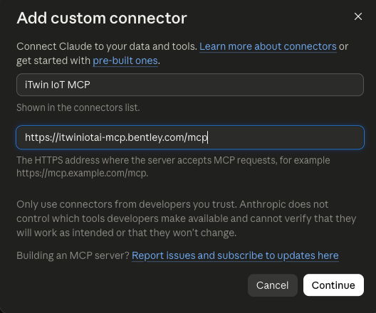

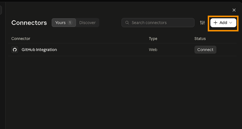

1. Go into settings in Claude Desktop, click "Connectors" and click the "add custom connector" option
2. The next step is to add the information for the MCP server with the URL above. You can put in any name you want.

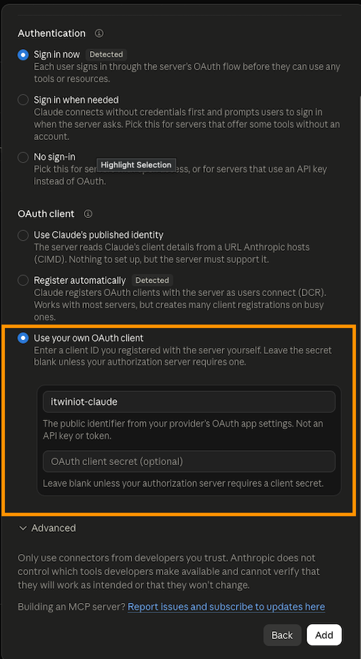

3. Once the connector setup has verified that it can connect to the MCP server you can set up the authentication to it. For this step you need to choose the "Use your own OAuth client" and put in the OAuth Client ID: itwiniot-claude . Client secret is not needed.
4. Click "add"

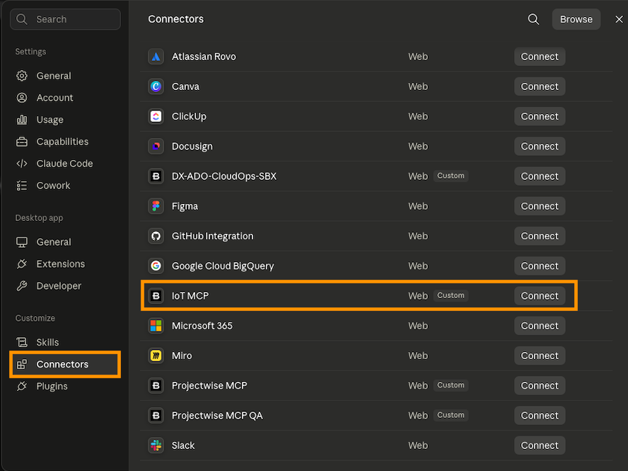

  1. In Claude.ai, go to Settings → Connectors and find Bentley iTwin IoT in the directory.
  2. Click Connect. Claude will redirect you to Bentley IMS to sign in with your regular Bentley account.
  3. Approve the itwin-platform scope when prompted.
  4. Once authorised, the connector appears in your chat's connector list and is ready to use.
