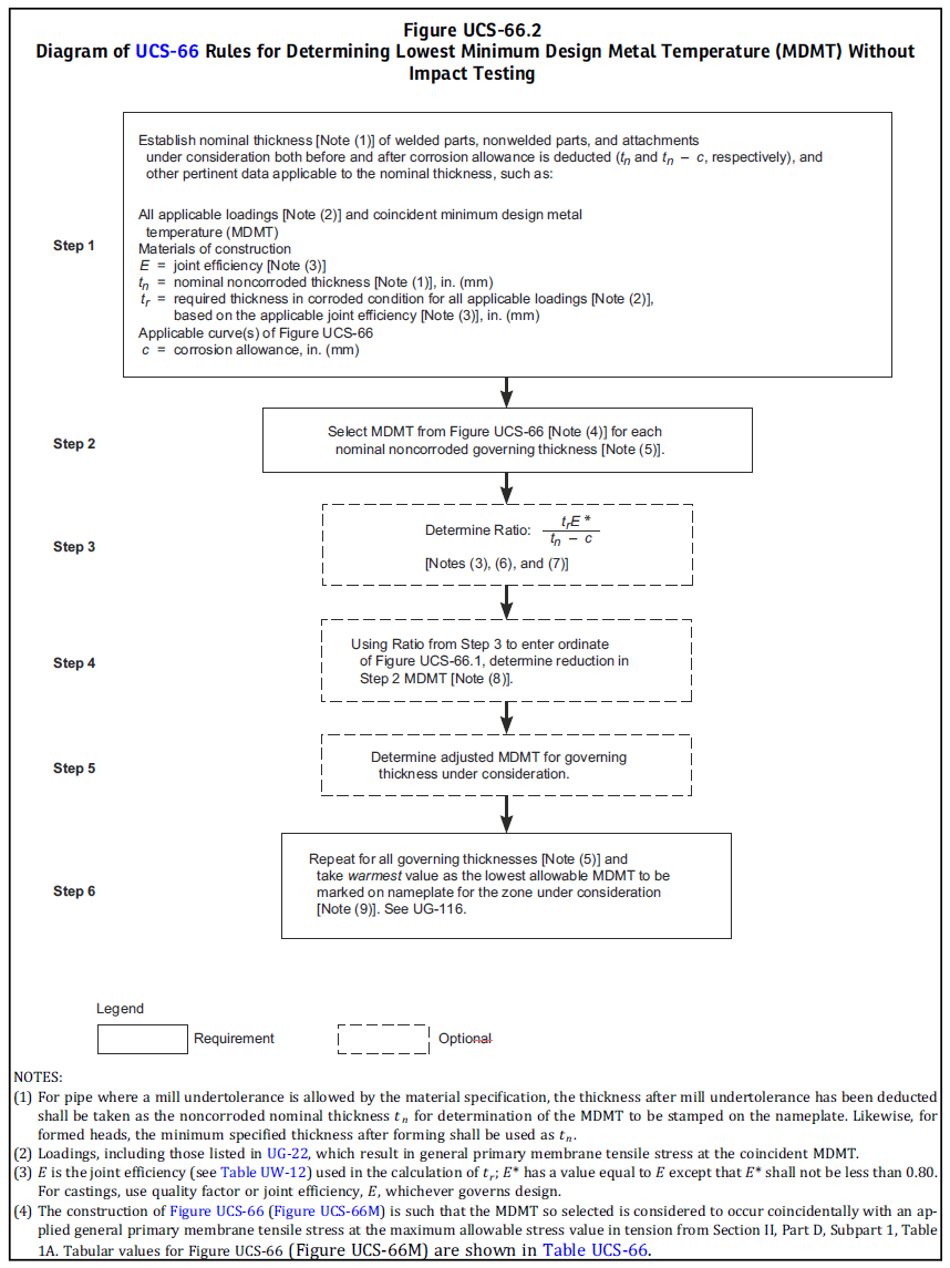

Code compliance requirement:
As per ASME Section VIII, Division 1, MDMT evaluation is mandatory to determine whether impact testing is required.
- Governing clause: UCS‑66
- Objective:
- Establish minimum allowable temperature without brittle fracture
- Identify conditions for impact testing exemption
- Refer to UCS‑66 flowchart for detailed stepwise logic.

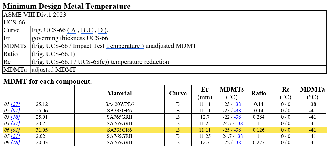

AutoPIPE Vessel Report:
- Refer below report screenshot for your reference:

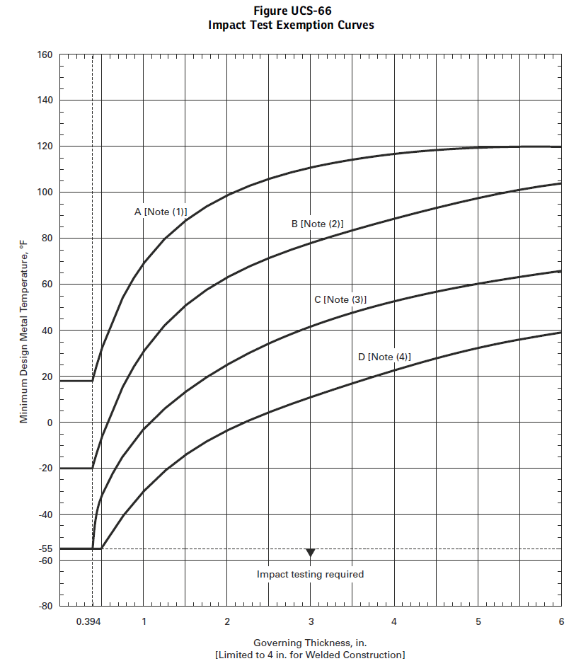

- Curve:
- Impact test exemption curves depend on material type.
- Refer to Figure UCS‑66 Notes (1) to (4) for curve assignment.
- For Example: SA333 Gr 6 falls in Curve B
- Governing Thickness (Er):
- It is nominal non corroded governing thickness defined under UCS-66(a)(1)(-a), (-b) & (-c).
- Refer Figure UCS-66.3 for typical vessel details.
- For Example pipe material (Er = Pipe nominal thickness - mill tolerance 12.5%)
- MDMTs:
- Two temperature values are considered: MDMT as per Figure UCS-66 (Table UCS-66) and Impact test temperature defined by user.
- These are initial values without any reduction.

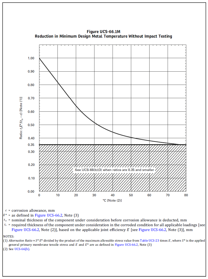

- Ratio:
- AutoPIPE Vessel calculates ratio as per Note 1 of Figure UCS-66.1 instead of calculating by formula trE*/(tn-c)

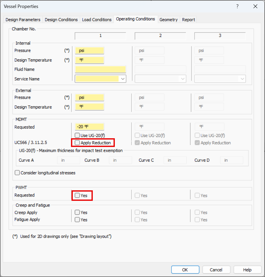

- Re:
- Reduction in MDMT permitted based on Figure UCS-66.1 and UCS-68.2(a).
- Reduction can be activated from
- Apply Reduction" calculates the reduction from figure UCS-66.1
- PWHT "Yes" calculates the reduction from UCS-68.
- MDMTa:
- Final MDMT after applying temperature reduction:
- MDMTa=MDMT (from UCS‑66)−Re
- When thickness of component exceeds the 4-inch limit, as specified in UCS-66(a)(1)(a)(5), AutoPIPE Vessel reports the MDMTₐ as 120°F.
