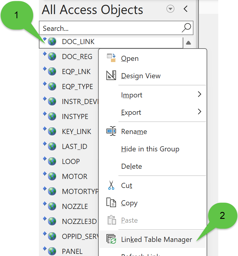

1. Go to your problematic project folder location and open the Project.mdb file. For example, the default location of projects is located in C:\ProgramData\Bentley\Plant V8i\%PROJECT_ROOT%\%PROJECT_NAME%\ProjData
2. Open the Project.mdb file using Access
3. In the All Access Objects window, select a table and right-click to open the Linked Table Manager

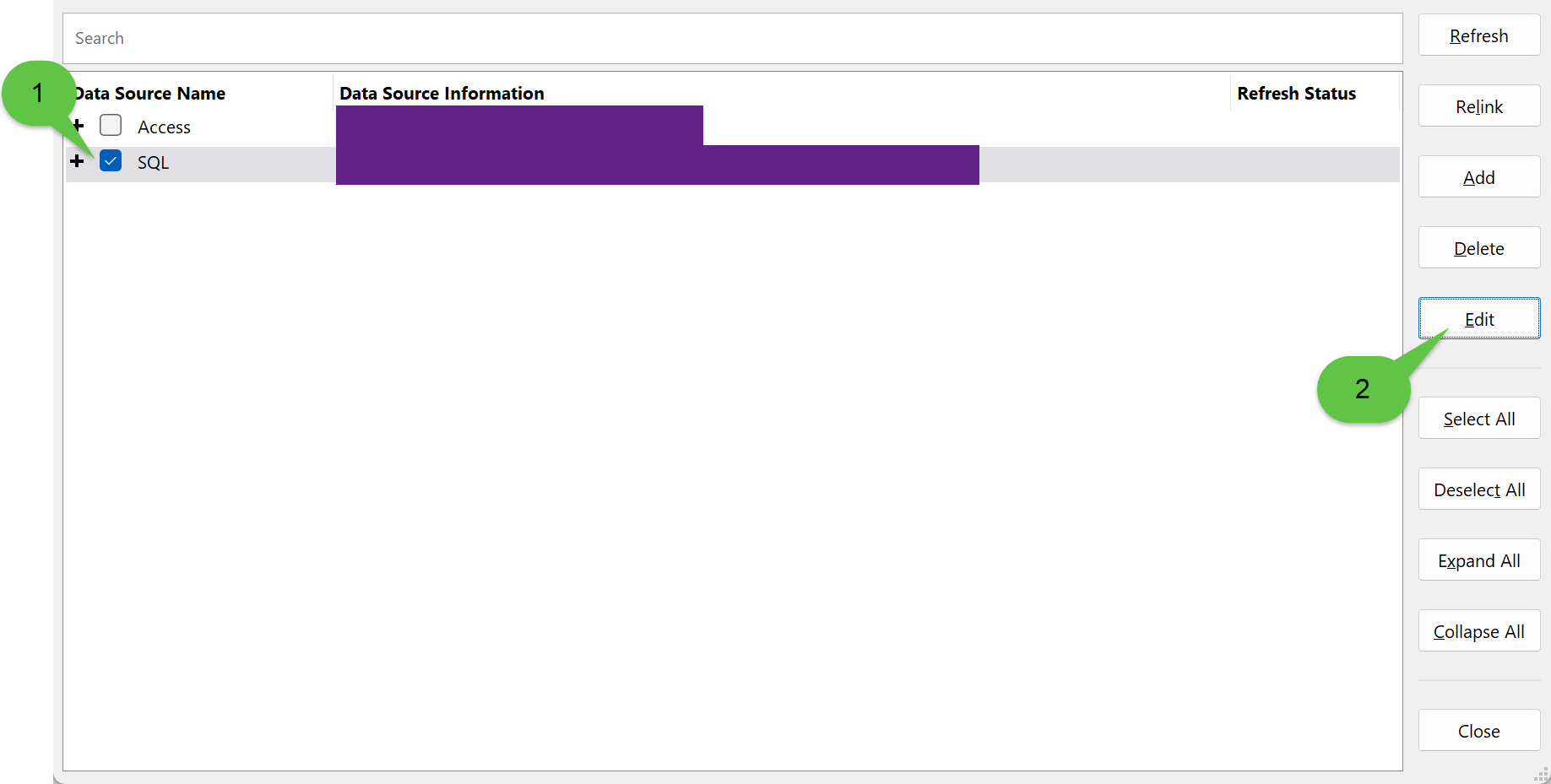

4. Tick the SQL Data Source Name and Edit

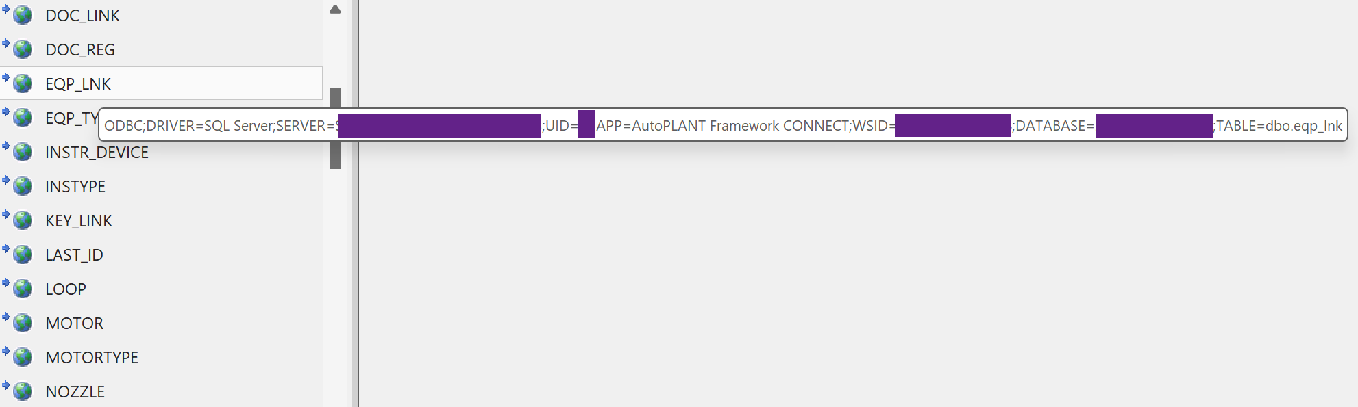

5. Copy the text in the Connection String and paste it in a Notepad

8. In the duplicate Project.mdb file, repeat steps 2-4 and replace the Connection String from the one copied in step 5
9. Save the new Connection String
