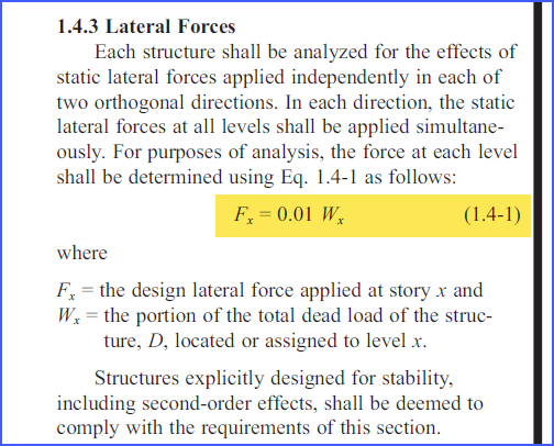

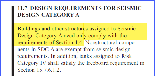

According to ASCE 7-10 Section 11.7, seismic load should be determined with Equation 1.4-1 therefore the seismic shear should be:
- Fx = 0.01 Wx
- Fx = the design lateral force applied at story x

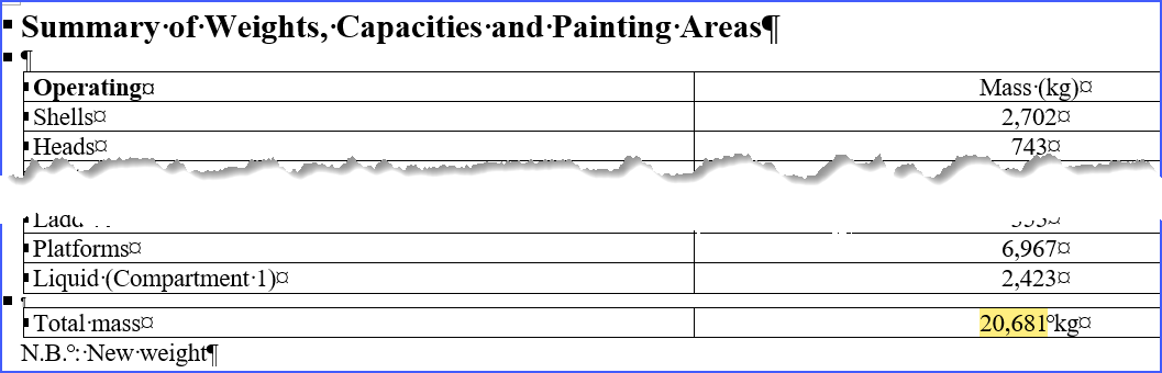

- Wx = the portion of the total load of the structure located to level x
- However, upon review of attached model results, this is not the case.

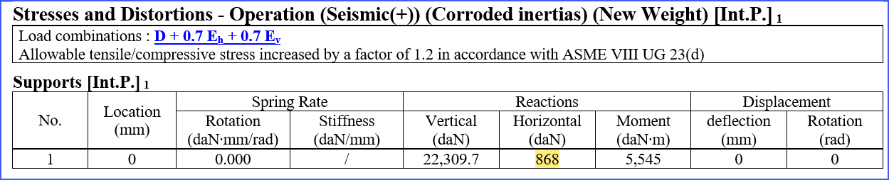

- F=868 daN = 885 kg
- F/W = 0.04 instead of 0.01.
why?

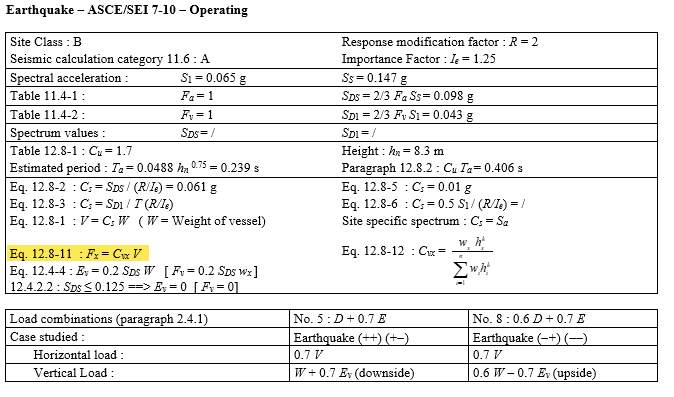

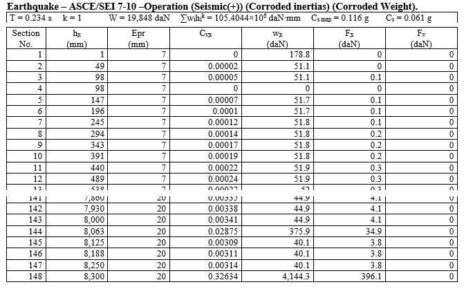

Answer:
Fx is determined for each sections as per Eq. 12.8-11
See screenshots of the Report below:
