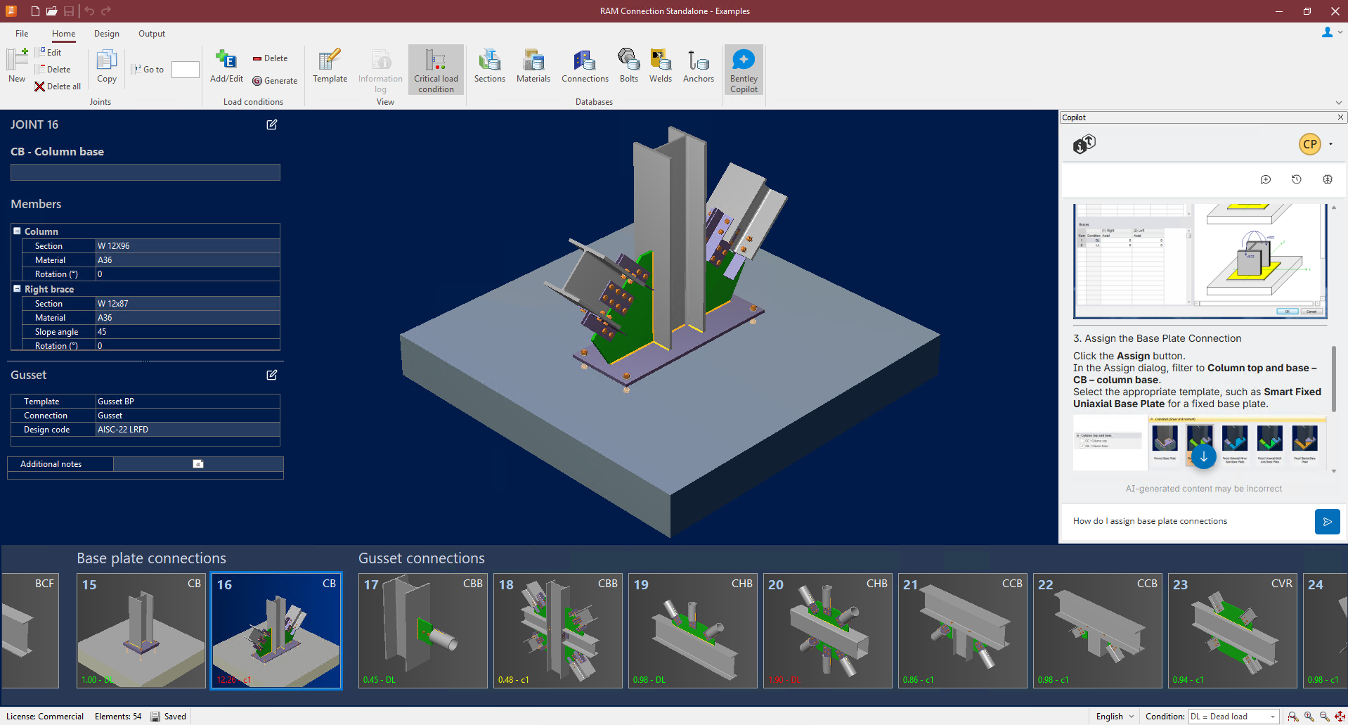

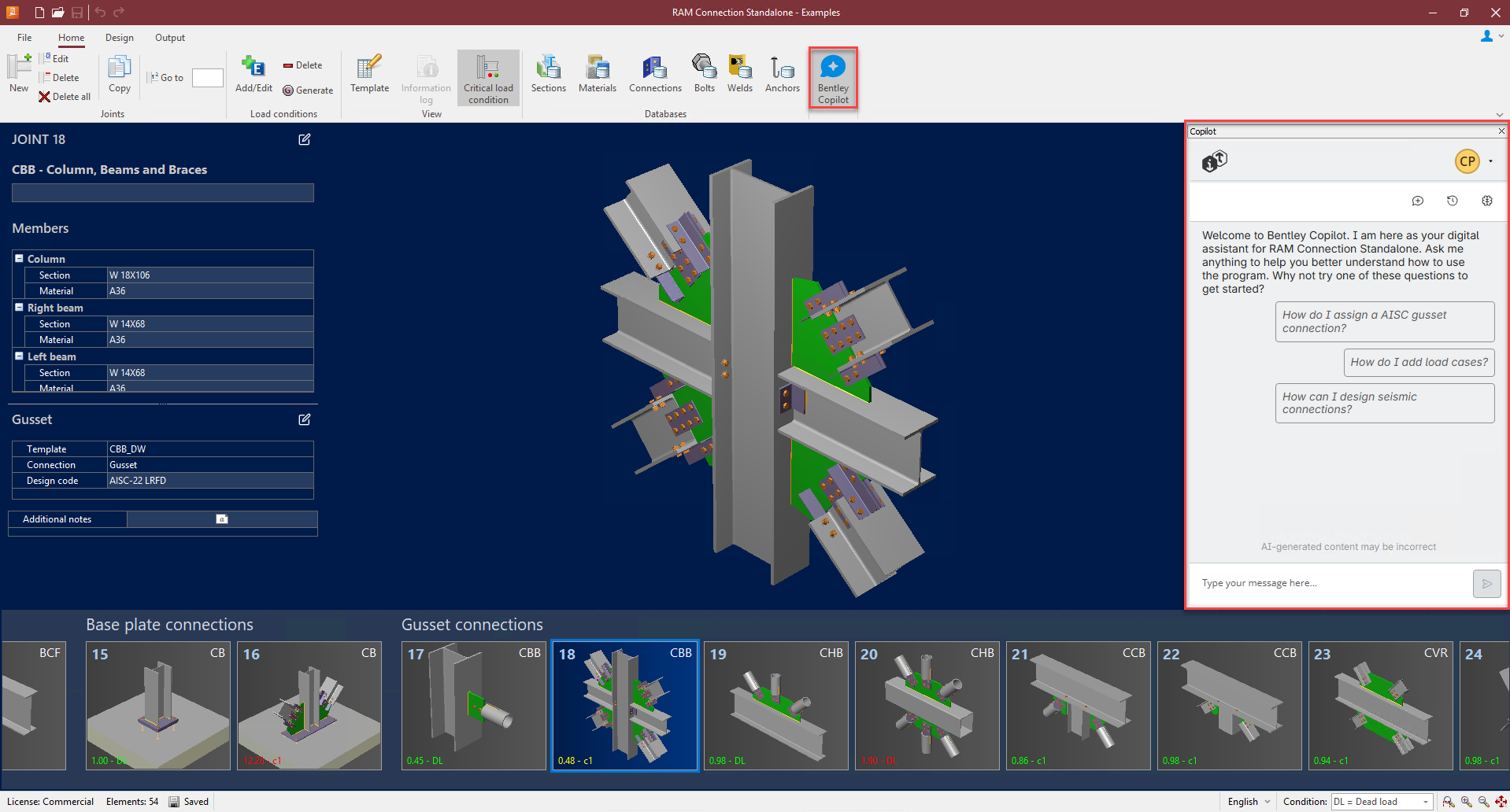

1. Bentley Copilot Integration. Bentley Copilot integration provides AI-assisted access to documentation and workflow guidance directly within the application.
Users can search and navigate:
Users can access this information through conversational AI directly within RAM Connection.
Figure 1. Bentley Copilot interface integrated within RAM Connection.
This enhancement helps users:
This integration streamlines access to technical information without requiring users to leave the application.
Figure 2. Example AI-assisted workflow guidance using Bentley Copilot inside RAM Connection.

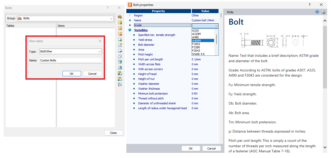

2. Bolt Database Refactoring with Fy, Fu, and Custom Grades Support. Improvements to the bolt database structure add explicit Fy and Fu mechanical properties and support for custom bolt grades.
Previously, bolt strength calculations relied primarily on predefined grade names, which could create inconsistencies when regional or custom bolt specifications were used.
The updated bolt database now:
Figure 3. Updated bolt database including Fy, Fu, and custom grade definitions.
This enhancement increases flexibility for international projects and specialized fabrication requirements.
Figure 4. Example custom bolt grade definition within the RAM Connection bolt database.

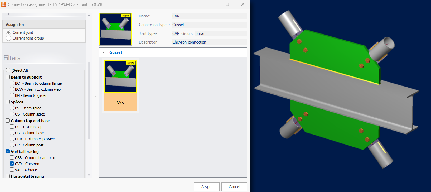

3. EN 1993 / IS 800 Chevron (CVR) and Vertical X-Brace (VXB) Connections. Support is now available for Chevron (CVR) and Vertical X-Brace (VXB) connection types for EN 1993 and IS 800 design codes.
This implementation expands the bracing connection library for European and Indian steel design workflows.
Users can now design:
using EN 1993 and IS 800 code provisions directly within RAM Connection.
The implementation includes support for all connector configurations for:
This allows users to model and design a broad range of braced-frame connection configurations.
Figure 5. Chevron (CVR) bracing connection designed using EN 1993 provisions.
It also reduces the need for manual calculations or alternative code-based workarounds.
Figure 6. Vertical X-Brace (VXB) connection under IS 800 design provisions.

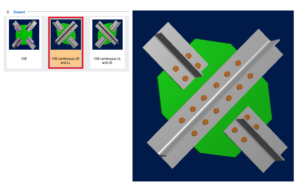

4. Vertical X-Brace Connections with One Continuous Member. Vertical X-brace connections now allow one bracing member to remain continuous while the intersecting member is interrupted at the gusset plate.
This configuration reflects common fabrication practice for vertical bracing systems and aligns the workflow with options already available for horizontal bracing connections.
Figure 7. Vertical X-brace configuration with one continuous brace member.
Previously, users were required to model both brace members as interrupted at the gusset plate location, which did not accurately reflect many fabricated field conditions.
The updated workflow allows users to design vertical X-brace connections that better reflect real fabrication and erection practices.
Figure 8. Example vertical X-brace connection using one continuous member through the gusset plate.

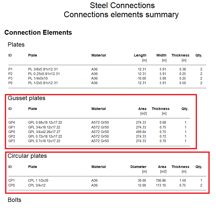

7. Enhanced Connection Elements Summary for Bill of Materials. The Connection Elements Summary report has been enhanced to include non-rectangular plates in the bill of materials output.
Previously, the summary primarily reported rectangular plates, while other plate geometries such as gusset plates and circular plates were not fully included in the connection material summary.
The updated report now includes:
This enhancement improves the completeness and accuracy of material summaries used for:
Figure 13. Enhanced Connection Elements Summary including gusset plates and circular plates in the bill of materials report.
