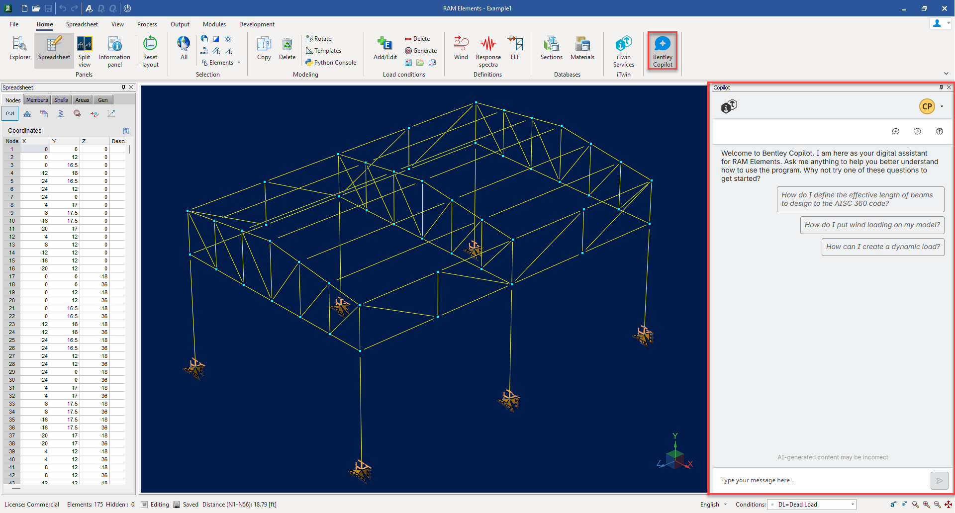

1. Bentley Copilot Integration. Bentley Copilot integration provides AI-assisted access to documentation and workflow guidance directly within the application.
Users can search and navigate:
using conversational AI directly from within RAM Elements.
Figure 1. Bentley Copilot interface integrated within RAM Elements.
This enhancement helps users:
The integration streamlines access to technical information without requiring users to leave the application environment.

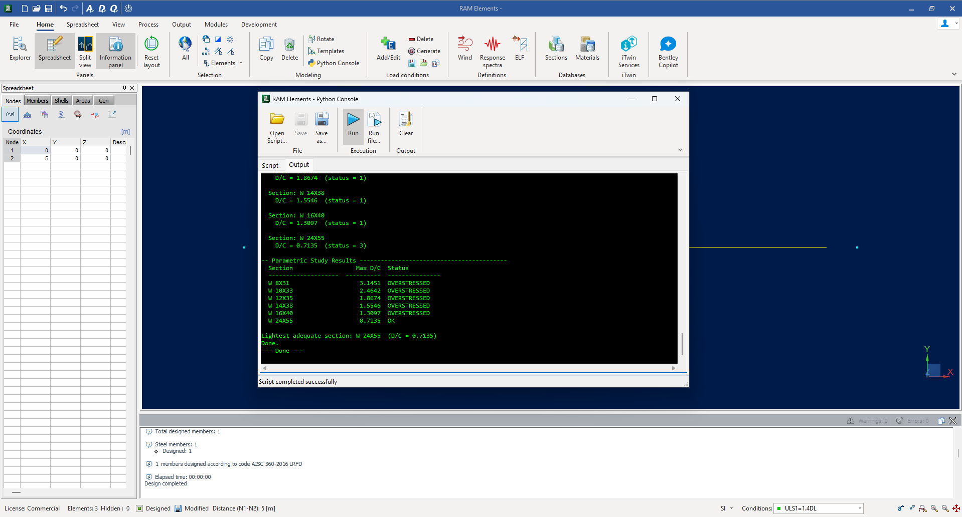

2. Python Scripts Support. Integrated Python scripting support enables automation of modeling, analysis, design, and results extraction workflows directly within the application.
The new Python Console is available directly from the RAM Elements ribbon interface and allows users to:
Figure 3. Python Console available directly from the RAM Elements ribbon interface.
The Python API provides access to:
The scripting interface connects directly to the active RAM Elements model through the new ramelements API package.
Figure 4. Example Python script executed inside RAM Elements.
Python scripting support enables advanced workflows such as:
The API also supports direct extraction of:
Allowing engineers to automate post-processing and reporting workflows.
Figure 5. Example automated extraction of analysis and design results.
Additional documentation and examples are available in the RAM Elements Python API User Manual.

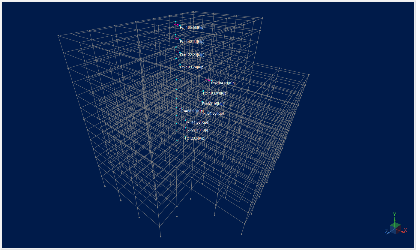

3. Equivalent Lateral Force (ELF) Analysis. Support for Equivalent Lateral Force (ELF) seismic analysis workflows is now available based on ASCE 7-22 provisions.
The new ELF functionality provides a simplified seismic analysis procedure for structures where the Equivalent Lateral Force method is permitted by code.
Users can now:
Figure 7. Equivalent Lateral Force analysis definition dialog.
The new workflow includes dedicated tools for:
The implementation follows the procedures described in Chapter 12 — Equivalent Lateral Force (ELF) Analysis of the RAM Elements Manual.
Figure 8. Automatically generated ELF vertical force distribution over the structure height.
This enhancement simplifies seismic analysis workflows for:
The ELF workflow integrates directly with existing RAM Elements load cases, combinations, analysis, and design procedures.

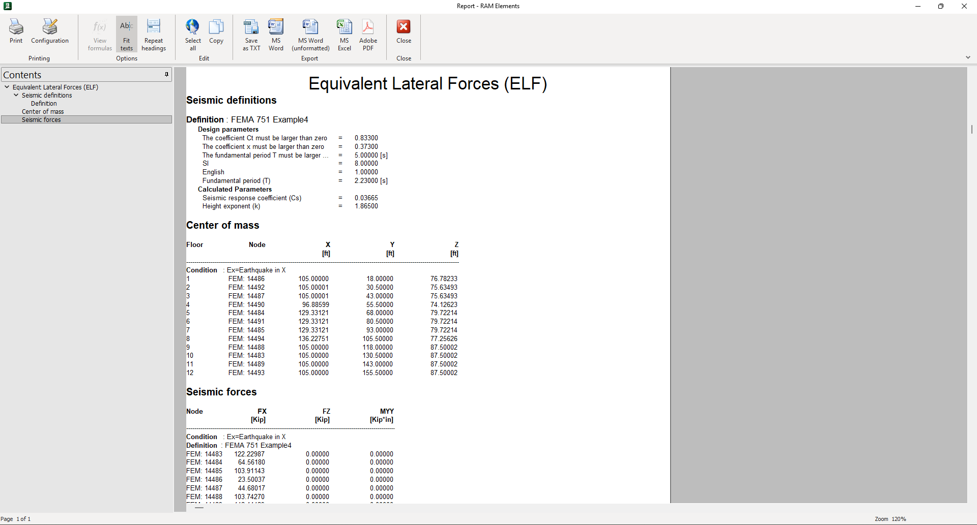

RAM Elements 2026 also introduces a new dedicated ELF Analysis Report available from the Analysis output reports. The report provides a detailed summary of:
The report includes calculated parameters such as:
Along with detailed seismic force distribution tables for each seismic load condition.
Figure 9. New ELF Analysis Report showing seismic definitions, calculated parameters, center of mass locations, and generated seismic forces.

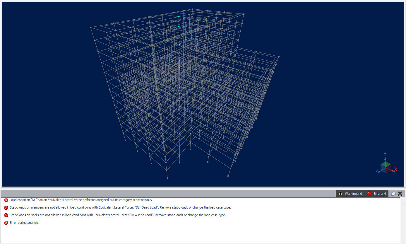

Validation messages are also included to help users identify incomplete definitions or inconsistent seismic parameters during model preparation and analysis.
Figure 10. ELF validation and seismic parameter review messages.

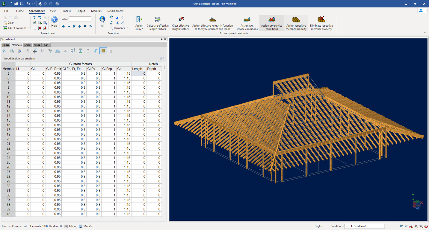

5. NDS Wood Design Parameters: Ci and Cr Factors. Support for NDS wood design parameters Ci (incising factor) and Cr (repetitive member factor) is now available throughout the workflow.
Previously, these parameters were not consistently applied outside the dedicated wood design module, which could require manual adjustments during certain wood design workflows.
The new implementation improves support for:
This enhancement improves consistency in wood member design workflows while reducing the need for manual corrections.
Figure 12. Wood design parameters including Ci and Cr factors.
