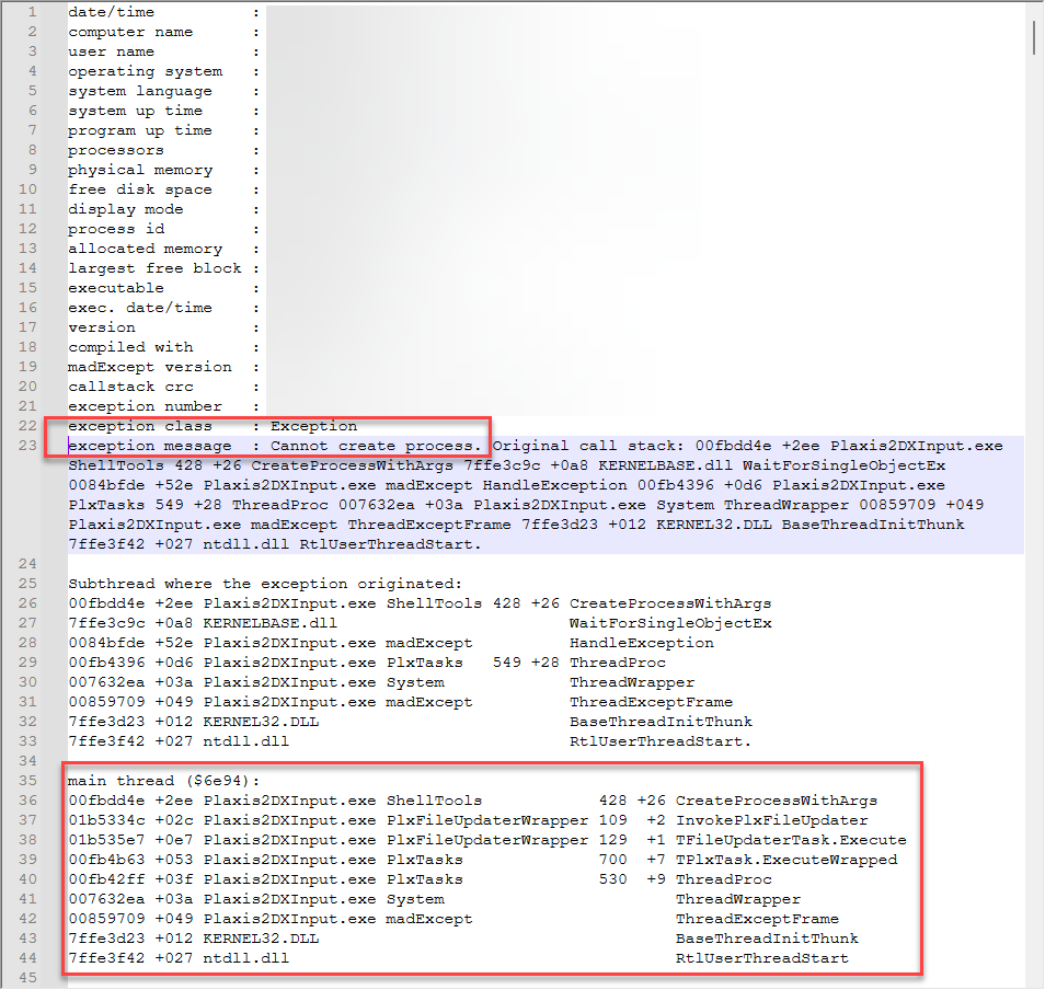

An issue has been identified where existing PLAXIS projects that were previously accessible and functioning correctly may unexpectedly fail to open in PLAXIS 2D/3D 2024.3, PLAXIS 2D/3D 2025.1.1 and PLAXIS 2D/3D 2025.1.2.
This issue is caused by changes initially introduced via the non-security Windows Update item KB5083631 (26200.8328), which was released on 30th April 2026.
When attempting to load an existing project, PLAXIS instead gives an error message "An error occurred in the application" with a bug report that contains the exception message: "Cannot create process."
By saving the bug report as a text file the information mentioned are as the example below:

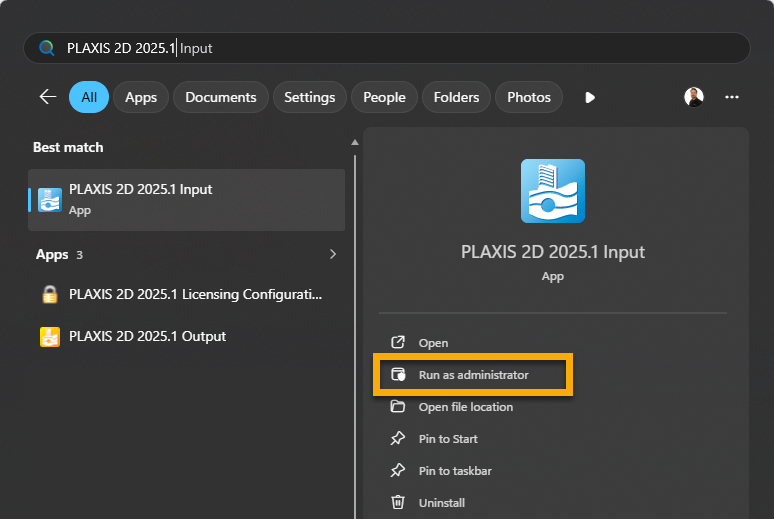

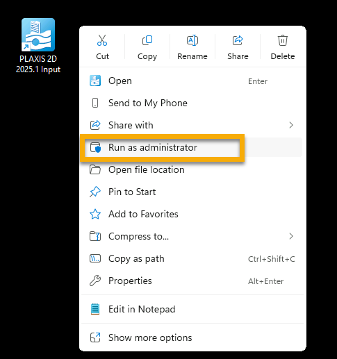

We have found that this issue can be bypassed entirely by launching the PLAXIS application with administrator privileges.
We aim to provide a permanent resolution in a future software update. In the meantime, this workaround will allow you to continue your work without data loss.
There are different ways to run PLAXIS as an administrator:
