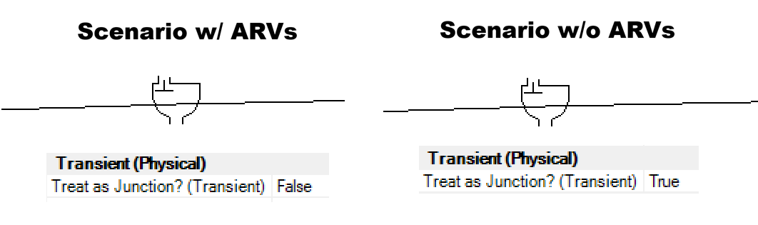

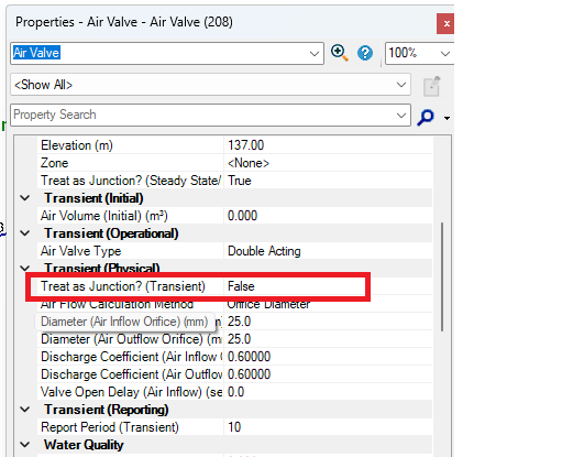

Ability to treat an air valve as a junction in a transient simulation
This new air valve property enables you to specify whether or not to treat the air valve as a junction (as if it is not there) during a transient simulation,  so no air inflow or outflow is modeled. Not to be confused with the steady state/EPS-focused "Treat as Junction (Steady State/EPS".
This option is helpful when you want to set up another scenario where the air valve is not present, such as "no protection" scenarios. You no longer need to use active topology to accomplish that.
To use this new option, open the Properties grid for the air valve and set “Treat as Junction? (Transient)” to True:
Information on this has been included in the following article: Modeling Reference – Air Valves

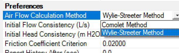

New Air Valve Air Flow calculation Method
The Wylie-Streeter method of calculating the air flow for air valves has been added to HAMMER.
Prior to version 2026, HAMMER always used the Comolet method described, which calculated maximum air velocity and uses a pressure ratio to calculate air flow rate. Some users prefer to use the newer, "Wylie-Streeter" method which uses a different formular and is based on subsonic or critical conditions and air flow direction.
Bentley generally recommends using the new default Wylie-Streeter method but it is ultimately up to your engineering judgement and/or local requirements. Review the details in the below article to help you decide which method to use for your situation. This option also enables you to better match results with other transient modeling software which may use one method versus another.
To switch between the Comolet method and the Wiley Streeter method, open the transient calculation options in the Properties grid and set the Air Flow Calculation Method:
New models will use the Wylie-Streeter method as the default. Models created before version 26.00.00.xxx will use the Comolet method to maintain continuity of results.

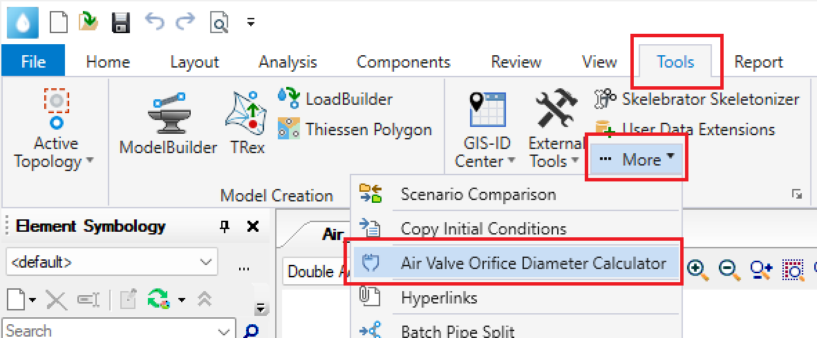

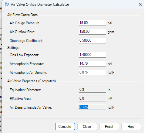

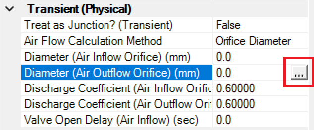

New Air Valve Orifice Diameter calculator
This enables you to easily use data from the manufacturer rating curve to calculate the equivalent diameter, so that you can then simply enter that diameter. This can be easier than defining the entire rating curve (which is always still an option, by selecting "Air flow curve" for the "Air flow calculation method")
This calculator is available either from the "..." button next to the inflow and outflow orifice diameter fields in the air valve properties, or from the Tools Menu > More > Air Valve Orifice Diameter Calculator
See this link for more information: Entering Air Valve Orifice Diameter Based on Manufacturer Data

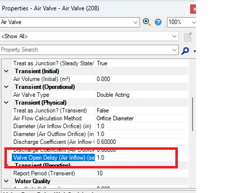

Support for Air Valve Opening Delay
A new field has been added to air valves to enable you to enter a delay in the time it takes for an air valve to open, after the pressure drops below zero. In the air valve properties, find the property “Valve Open Delay (Air Inflow)”. The default value is zero, meaning the air valve opens as soon as negative pressure is calculated at the air valve.
Note: this open delay feature currently only works when the calculation option "Run Extended CAV" is set to false.

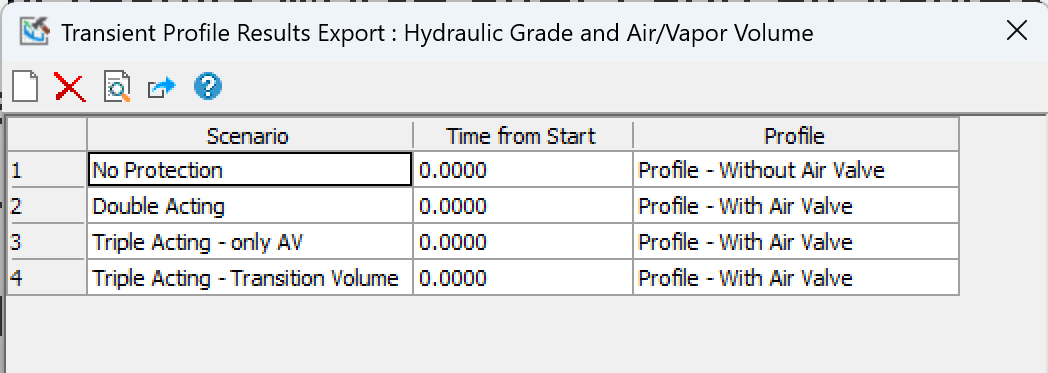

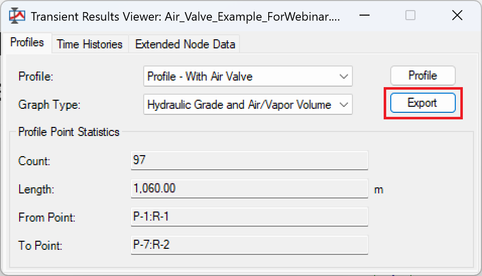

Export Multiple Transient Profiles to Excel
An Export feature has been added in the Profiles tab of the Transient Results Viewer where you can export multiple profiles from multiple scenarios to Excel.
In the Profiles tab of the Transient Results Viewer, click the Export button next to the Profile pulldown menu.
This will open a new dialog where you can choose a scenario, the time that you want to export the results, and the name of the profile.
There is a Preview button that you can see what numerical results will be displayed before you click the Export button to save the data to a CSV file, which can be opened in Excel.
This only supports profiles with animation data at this time. To generate animation data in transient profiles, open the transient calculation options and set “Generate Animation Data?” to True.
See this link for more information on this: Export HAMMER Transient Profile Data to CSV

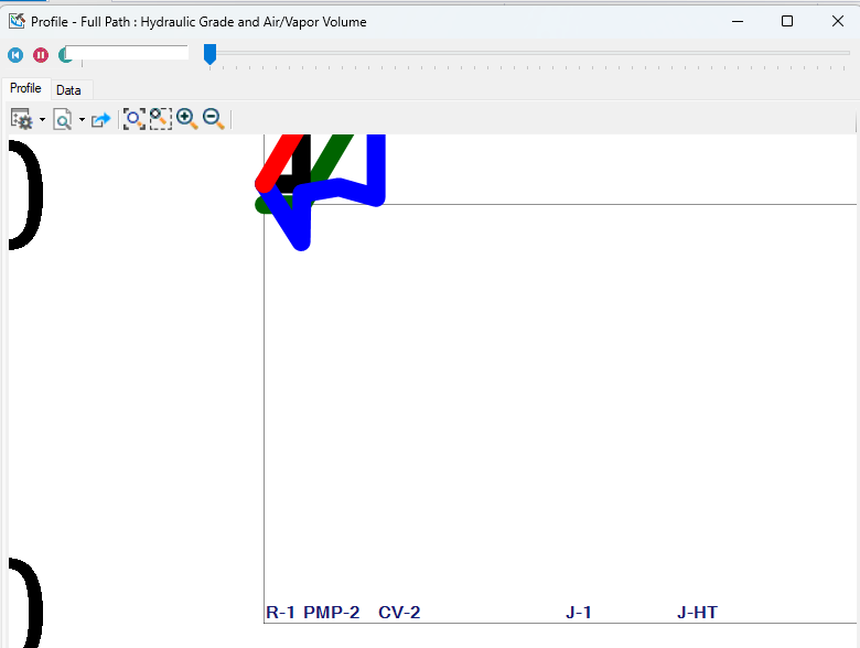

Improved Appearance of Transient Profile Labels
The handling of element labels at the bottom of the transient profile has been improved. When you zoom in on a profile, the label size now remains the same (GIS style). That means that the labels in the profile will be more legible when zooming in on part of the profile.
The placement of the label is based on the location of the element along the profile. Where there are very short pipes, you may still see some overlapping.
See more information in this article: How can you change the appearance of the profile in the Transient Results Viewer?

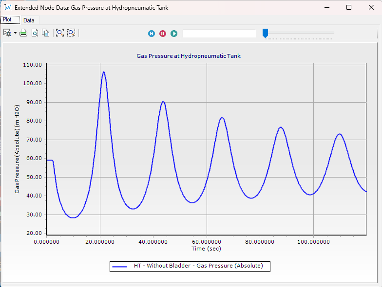

Updated labeling for gauge and absolute pressure results
Labeling for gauge and absolute pressure results have been updated so that it is clear which value type of pressure results are displayed in the transient profiles, Time History graphs, and Extended Node Data graphs. Note the vertical axis label on the left side of the graph below.

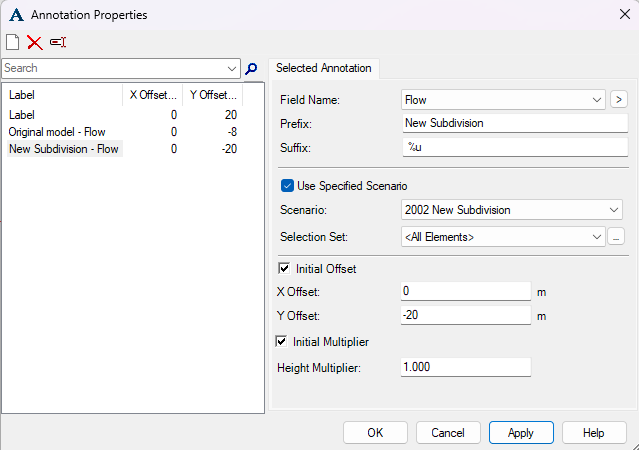

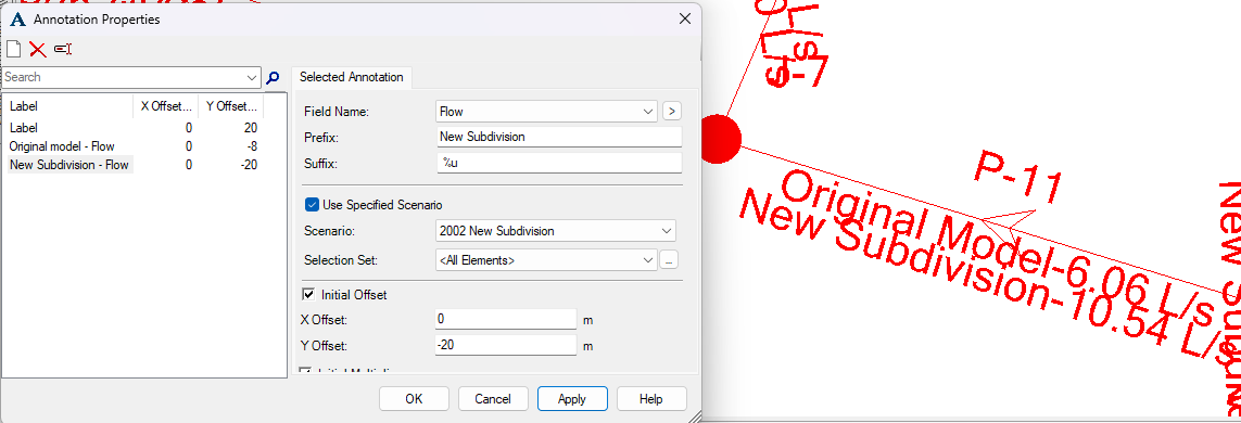

Set annotations for specific scenarios in Element Symbology
You can now set a specific scenario when using annotations in Element Symbology. This enables you to easily compare results between two scenarios in a single drawing. When you create or edit an annotation in Element Symbology, there is an option to select a scenario.
If you create another annotation for the same property field, you can select another scenario to display the results. In the screenshot below, you can see the flow results at a pipe for two different scenarios. Prefixes were used to help differentiate between the results.

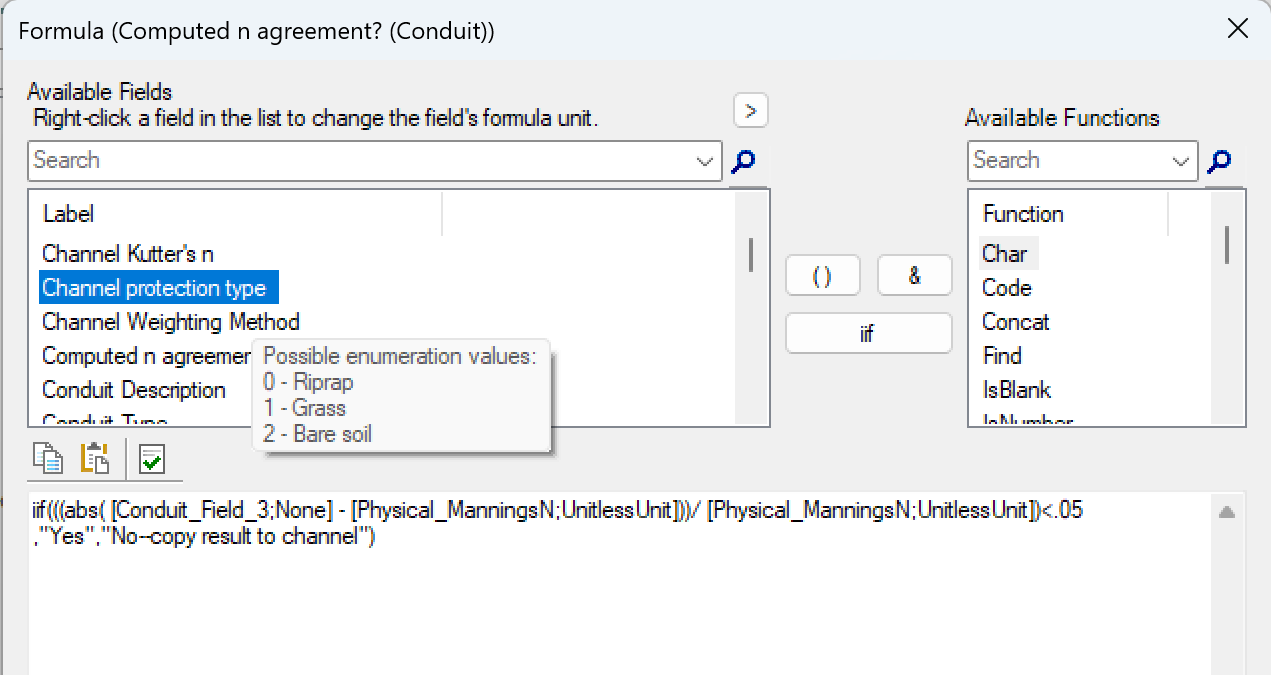

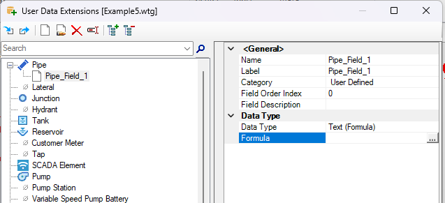

Text Output for Formula-derived User Data Extensions
It is now possible to create a formula-derived User Data Extension (UDX) that outputs text. Previously, only numeric output was supported, via the "Real (Formula)" data type.
For example, you could use the IIF (if-then) function to give a "pass" or "fail" value. It is also possible to edit existing text values using different text-based functions.
In the User Data Extensions manager, create a new UDX and set the Data Type to Text (Formula). Click the Formula cell and click the ellipsis (…) button.
The properties for the element you selected will be displayed on the left. The available functions will display on the right. You will be able to build your formula using these.
Note: when using enumerated fields (dropdown list) in the list on the left side as part of your formula, you can hover your mouse over them for a tooltip preview of the numeric ID values corresponding to each choice, which you would use in the formula. This provides a quick reference so that you do not need to exit your formula editor to go check the available enumerated values.
See more here: Creating Formula-Based User Data Extensions

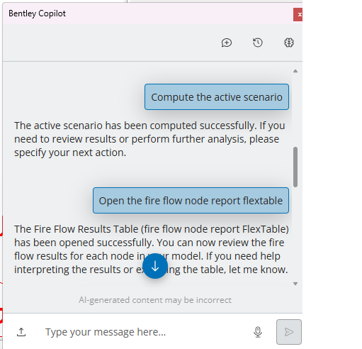

Bentley Copilot
Bentley Copilot is a new conversational artificial intelligence (AI) assistant that provides contextual intelligence, guides users through workflows, searches relevant documents, makes changes to model inputs, and analyzes data inputs and outputs through natural language conversation. By enabling users to "talk" to their hydraulic models and removing the need to memorize tool locations or complex query syntax, Bentley Copilot empowers users and accelerates project delivery, reducing the learning curve and enabling users to focus on engineering decisions.
To access Bentley Copilot, click on the Bentley Copilot item in the Home tab of the Ribbon interface. This will open a dialog where you can start the chat with Copilot.
Note: If you do not wish to install Bentley Copilot, it can be disabled during or after installation. See details in the article below.
Prompts can include asking for general information about the model (“how many pipes are there with a diameter greater than 12 in?), model functionality (“compute the active scenario”), how-to type questions (“how can I model a connection to an existing water main?), and more.
With this release, Bentley Copilot is offered as a Technology Preview, which means that it is still under development and may not represent the full functionality intended for a future (non-tech preview) release. Therefore, please use this feature for evaluation purposes. Please be aware that at some point, you may receive notice from Bentley that such use must cease or this Technology Preview will become unavailable to you. As we receive feedback, this Technology Preview may also be enhanced, updated or also discontinued without notice. As a Technology Preview, it is provided to you "as-is" without the benefit of any Bentley warranty, indemnity or support obligation.
More details can be found here: [Tech Preview] Using Bentley Copilot in OpenFlows Products

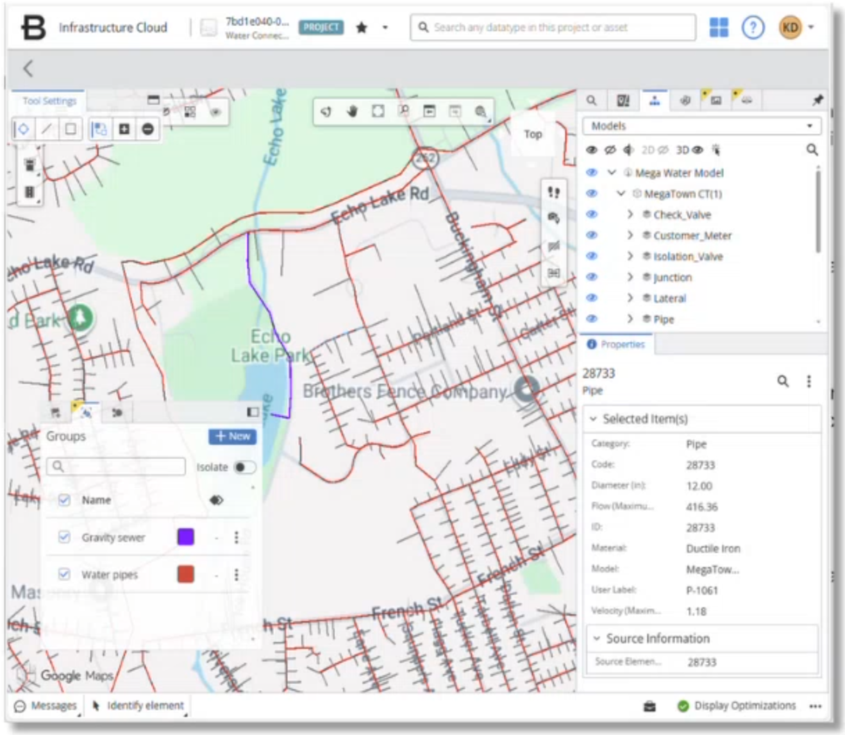

iModel Connector
This version introduces an iModel Connector, to synchronize a hydraulic model to Bentley's Infrastructure Cloud. iModel Connectors provide a bridge to transform data into the standard iModel format, which can be viewed in Bentley Infrastructure Cloud (BIC). This can help with a number of workflows such as performing clash detection across different programs (like OpenFlows Water and OpenFlows Sewer), as well as provide a method a model to be viewed without the need to own the OpenFlows product.
Note: results are currently only exported for the current timestep of the initial conditions, as time-series (EPS) results are not yet supported in the iModel format. You can also use statistical transient results such as the maximum and minimum HGL, pressure, etc.
Details on using this workflow can be found here: Using iModel Connector in the OpenFlows products
Example of an iModel as viewed in Bentley Infrastructure Cloud:

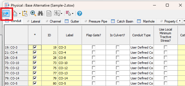

Additional functionality, such as Zoom To and Export, added to Alternatives
Zoom To and Export functionality has been included for Alternatives. These features are available in other places in the program, like FlexTables. Including this in the Alternatives manager gives you additional options for viewing and editing elements and element data.
To export data to a shapefile, text file, or CSV file, click the Export to File button in the upper left of a given alternative.
The Zoom To functionality works like it does in FlexTables or User Notifications. You can right-click on a row and choose Zoom To, which will highlight that element in the drawing.

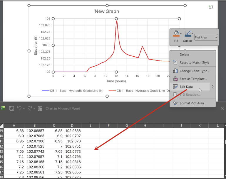

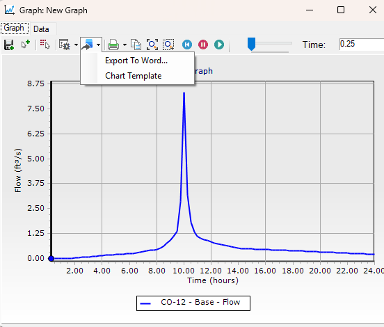

Export to Word feature added to Graph and FlexTables
A new Export to Word feature has been included for Graphs and FlexTables. When you open a graph or FlexTable, you will find an Export to Word feature. This will export the graph or FlexTable to a new Word document.
Note: for Graphs, the export to Word feature is currently only available for EPS graphs in HAMMER (initial conditions). Exporting Time History graphs from the Transient Results Viewer is not yet supported but may be in a future release.
This functionality streamlines the process of creating reports and sharing model results, as you can now seamlessly integrate tabular data and graphical plots into your project documentation.
Furthermore, you can customize the appearance of the exported content using Chart and Table Templates. For graphs, the underlying data remains accessible in the Word document and can be edited via Excel, offering greater flexibility for reporting and presentation.
For graphs, you can also edit the data source by right-clicking on the graph in Word and choosing Edit Data, which will open the numerical data in Excel. For example, you could adjust the column header to display differently in the Word document compared to the graph in the OpenFlows product.
See this link for more information: How to Export FlexTables and Graphs to Microsoft Word
