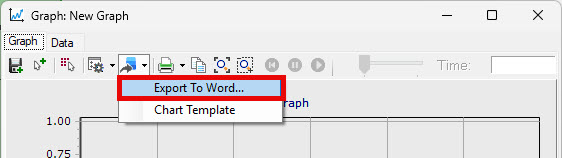

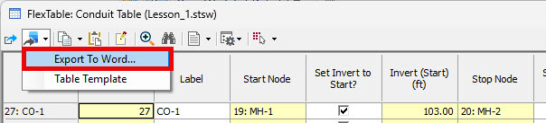

  1. First, open the FlexTable or generate the Graph that you wish to export.
  2. In the upper-left corner of the FlexTable or Graph window, click the "Export to Word" button.
(The image below shows the location of the "Export to Word" button on both a FlexTable and a Graph window.)
  1. A new Microsoft Word document will be automatically created, containing the exported FlexTable or Graph.

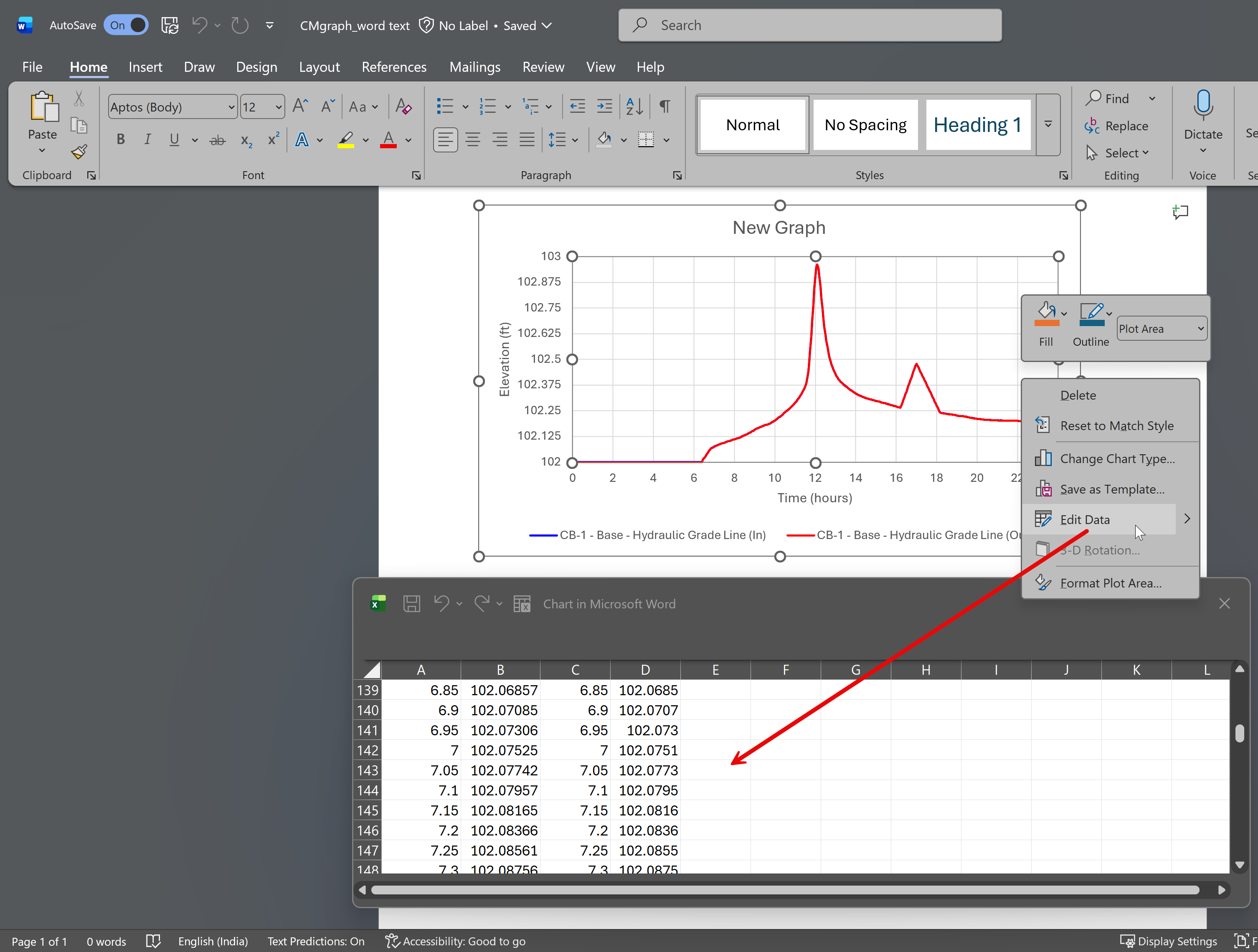

Editing Graph Data in Word
One of the key benefits of this feature for graphs is the ability to edit the data after it has been exported.
  1. In the Word document, right-click on the exported graph.
  2. Select Edit Data from the context menu.
  3. An Excel spreadsheet containing the graph's source data will open.
  4. You can now make changes directly in Excel. For example, you can edit the column headers to be more descriptive for your report than what is displayed in the OpenFlows product. The graph in the Word document will update automatically to reflect your changes.

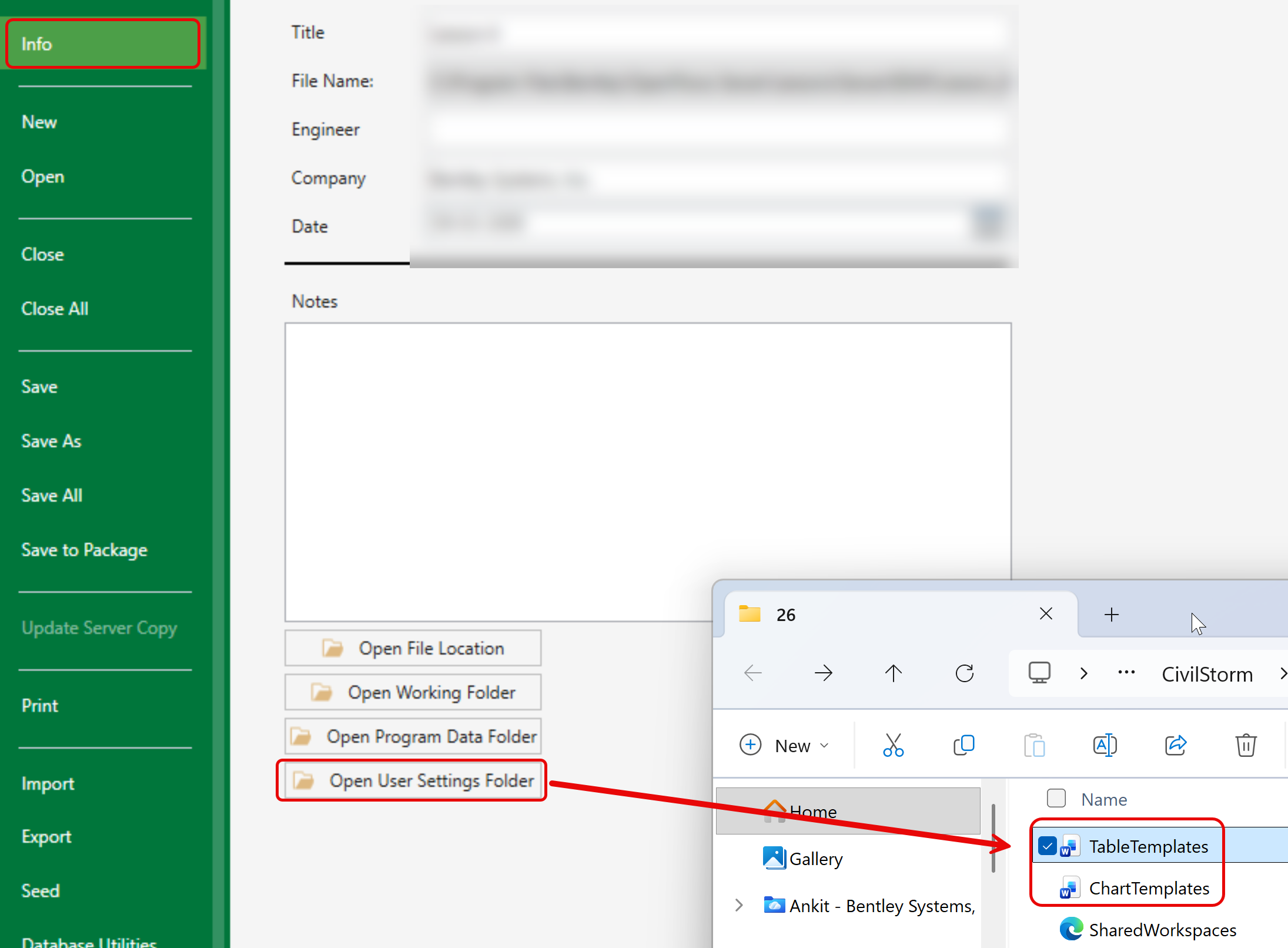

The "Table Template" button actually opens the template file that controls the initial style and formatting of your exported FlexTable. Here are a couple of useful things to know:
How styles are applied:
When the software is deciding the style for the contents of your table (like the font type and size), it only pays attention to the settings you have made in the first column and the header of the template file. Any style settings in the other columns are ignored for the table's content. Please refer the following short video -
Finding and managing the template file:
So, where is this template file located? It’s kept in your personal user settings folder. The easiest way to find it is to go to File > Info > Open User Settings Folder from the main menu.
If you ever delete this template from your user folder by mistake, don't worry. The next time you use the "Export to Word" feature, the software will automatically create a fresh copy of the default template for you from the main Program Data folder. It is important, however, that you do not delete the original template from the Program Data folder itself, as that can cause issues.
