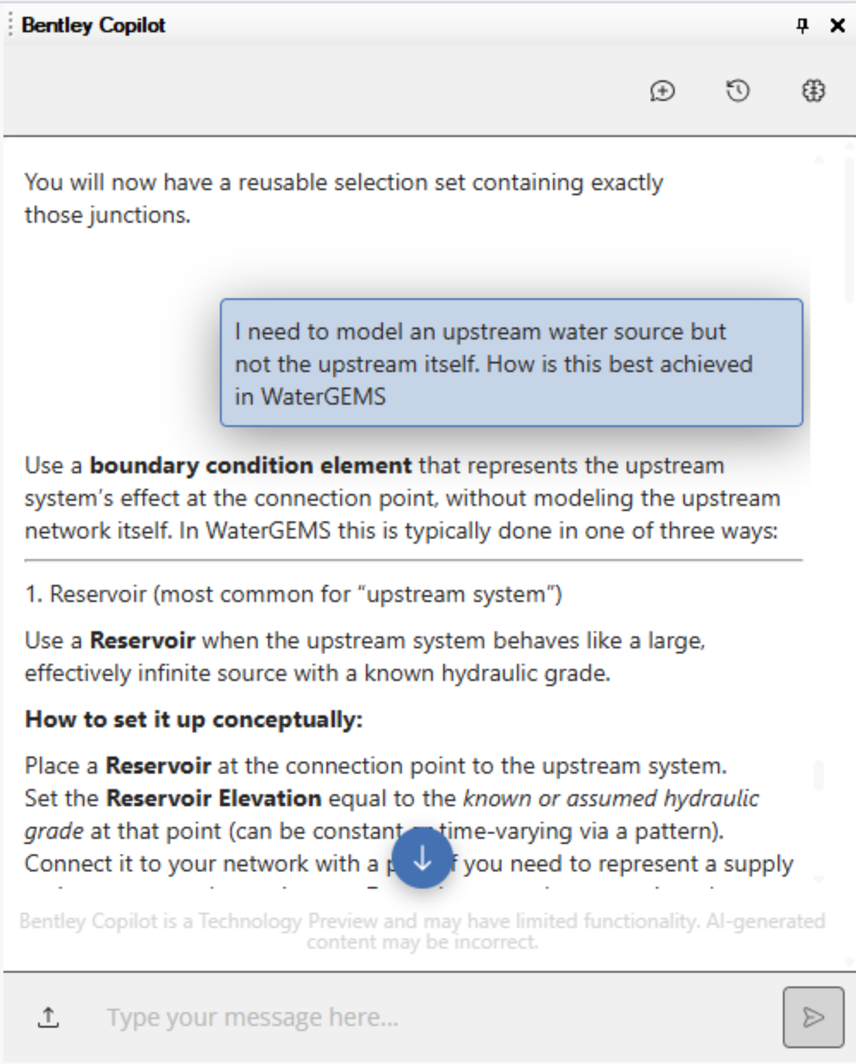

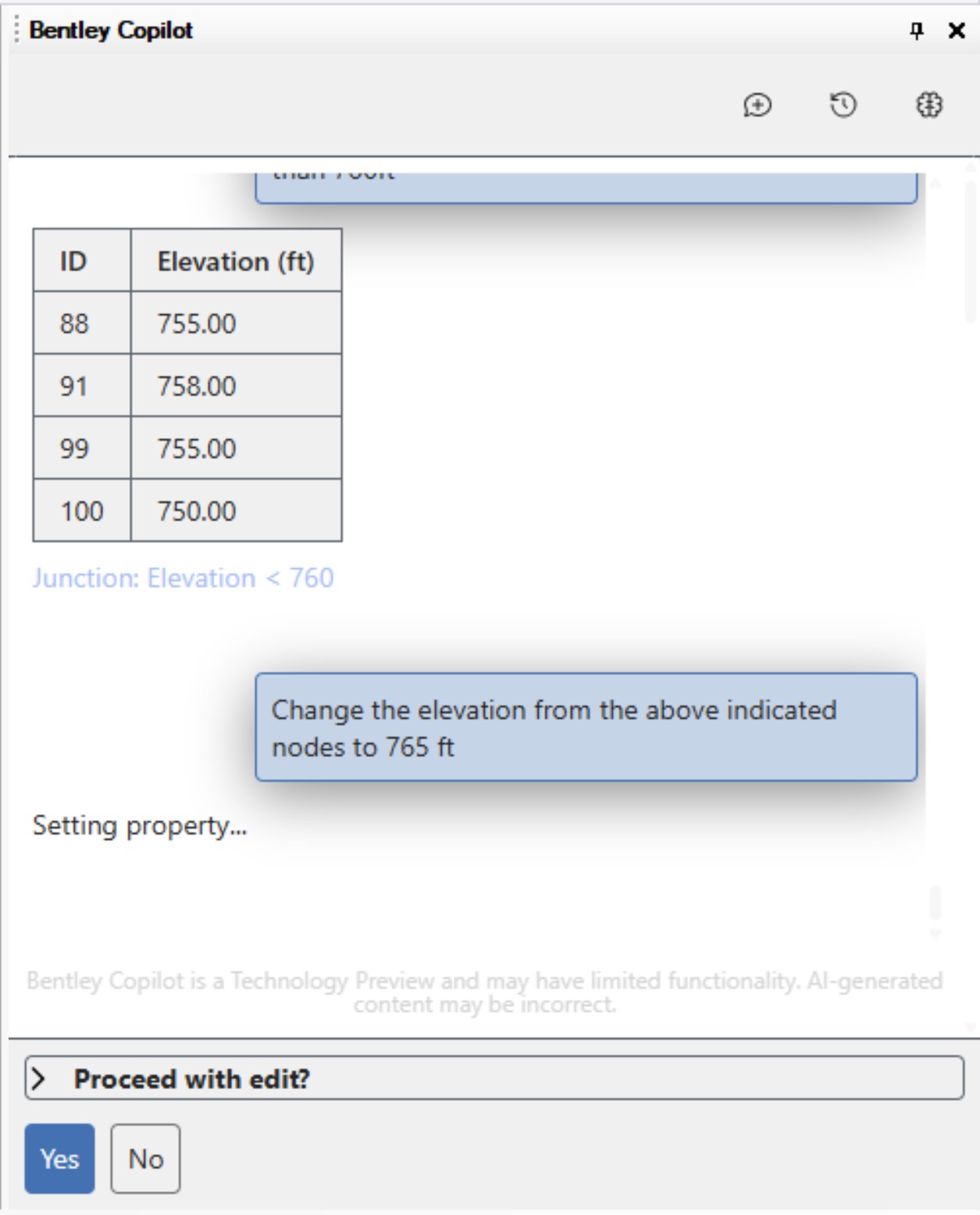

The Bentley Copilot feature is available in OpenFlows products starting with version 2026 (26.00.00.508 and higher). Bentley Copilot is a conversational artificial intelligence (AI) assistant that provides contextual intelligence, guides users through workflows, searches relevant documents, makes changes to model inputs, and analyzes data inputs and outputs through natural language conversation. By enabling users to "talk" to their hydraulic models and removing the need to memorize tool locations or complex query syntax, Bentley Copilot empowers users and accelerates project delivery, reducing the learning curve and enabling users to focus on engineering decisions.
Currently (as of version 26.00.00.508) Bentley OpenFlows Copilot is powered by ChatGPT 5.1, which serves as its underlying Large Language Model (LLM).Note: Bentley Copilot is not intended to be used for engineering consulting or for advanced troubleshooting.

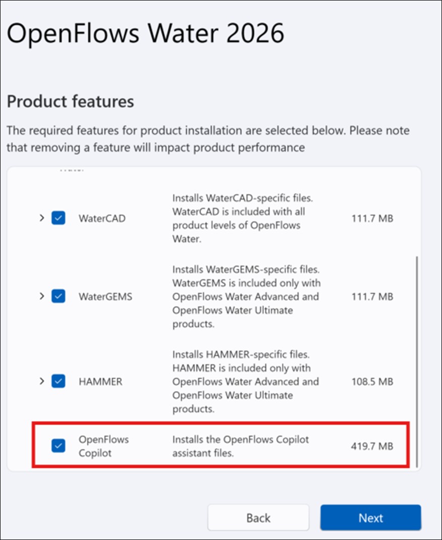

For users or organizations who prefer not to install the Bentley Copilot tool (for example due to company policy regarding AI tools or if you do not agree to the terms mentioned above, or for users in China), you can choose to exclude it during the setup process. To do so, proceed with the OpenFlows installation until you arrive at the Product Features configuration window. In this step, deselect the checkbox for the "Bentley Copilot" feature to ensure it is not installed. Please refer to the screenshot below for a visual guide.
If you are an administrator and need to deploy the OpenFlows product to multiple users with Copilot disabled, you can create a deployment image with Copilot disabled. See: Silent installation and Deployment Image for OpenFlows Products
Note: if you already installed the OpenFlows product with Copilot enabled and wish to disable it, you can navigate to the Windows "Installed Apps" (Programs and Features), click the "..." button next to the OpenFlows Water / Storm / Sewer entry, choose "Modify" and you will see the option to disable it (see screenshot below).

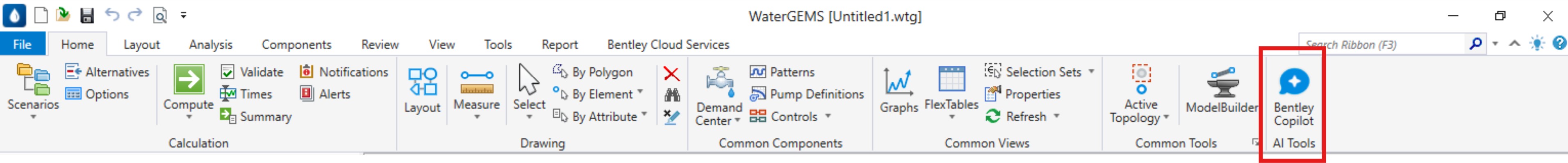

Bentley Copilot is presented as a dockable window within the OpenFlows interface. It can be found in the Home tab under Bentley Copilot.

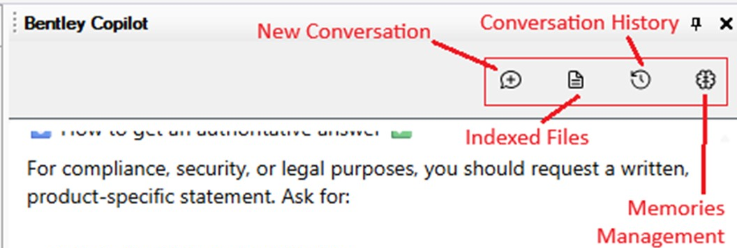

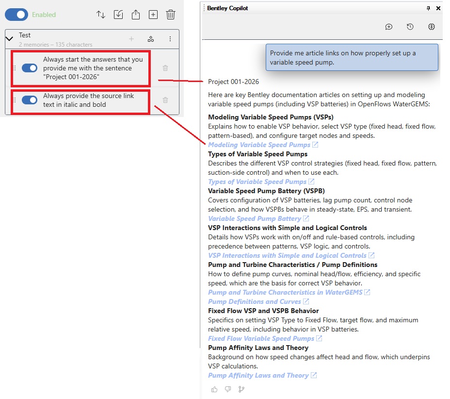

At the top right of the tool, you will find four icons from left to right: New Conversation, Indexed Files, Conversation history, and Memories management:
