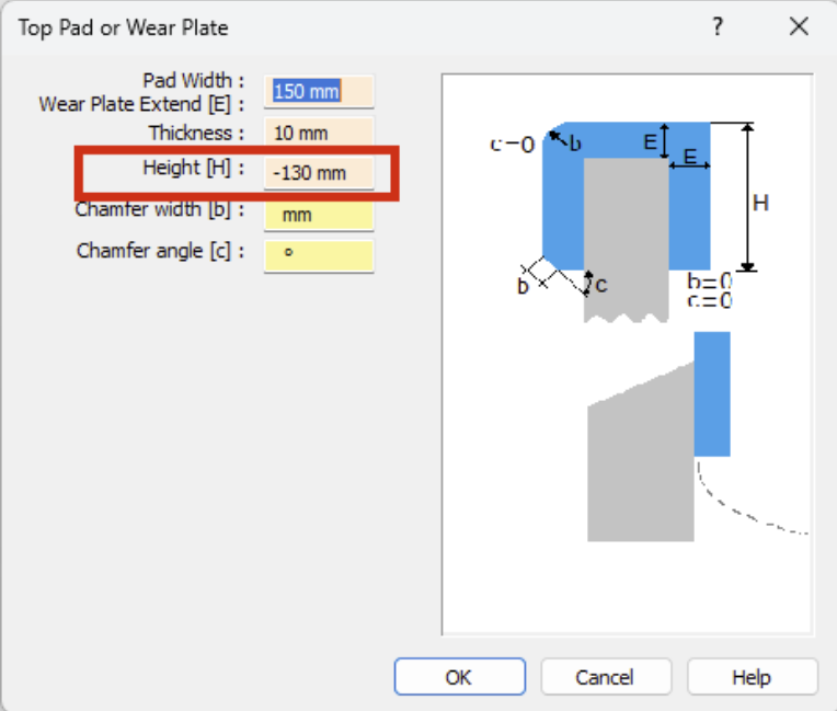

Why Wear Plate / Top Pad on Leg Support Is Not Considered in Local Load Calculation?
Question?
The wear plate (top pad) defined on a leg support is not being considered in the local load calculations, even though the wear plate dimensions and thickness are specified in the input.
Answer:
This issue occurs when the wear plate height is defined as a negative value or when the geometric conditions required for considering the wear plate in local load calculations are not satisfied.
In the example shown below, the wear plate height is defined as –130 mm, which prevents the wear plate from being included in the local load evaluation.
Wear plate height must be positive to be considered.
