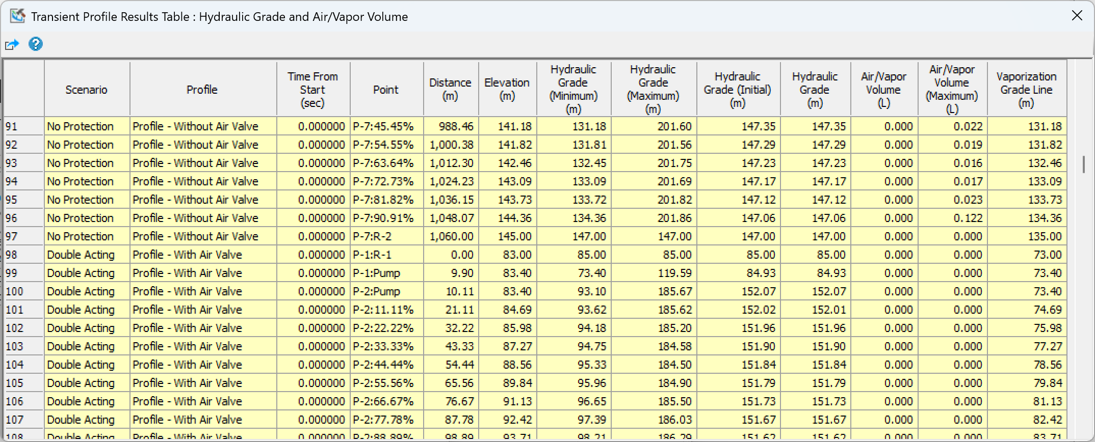

Click the Preview button to see the columns that will be exported to the CSV file. Scenario Name, Profile name, time from start, Point (pipe endpoint), Distance (station along the profile), Elevation (physical elevation), Hydraulic Grade (minimum), Hydraulic Grade (maximum), Hydraulic Grade (initial), Hydraulic Grade (corresponding to the "time from start"), Air/Vapor Volume (also corresponding to the "time from start", Air/vapor volume (maximum) and Vaporization grade line (corresponding to the vapor pressure limit, below which the water vaporizes and a vapor pocket forms).
Preview Table
