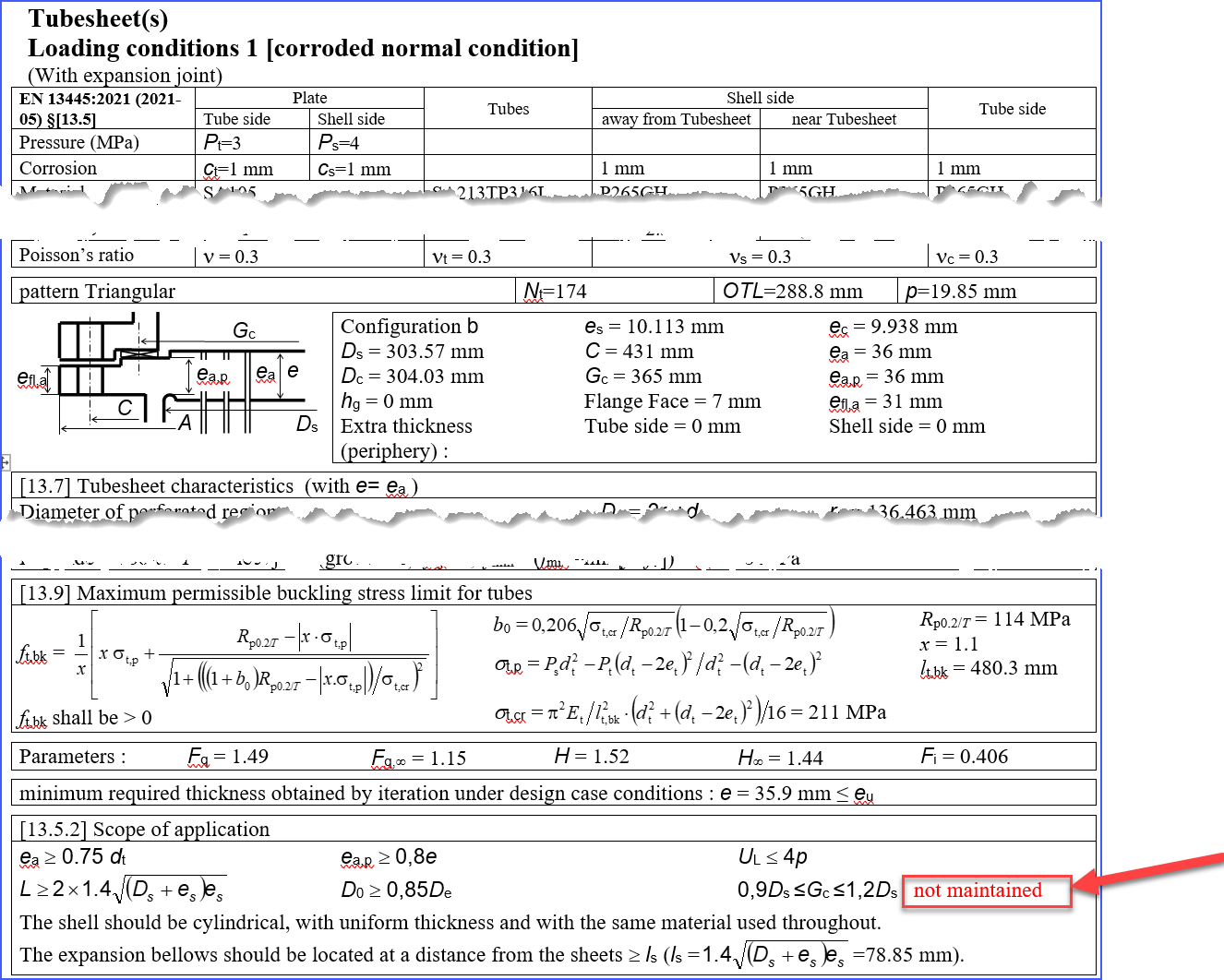

What does this warning mean when shown in my AutoPIPE Vessel report:
23        Tubesheet Loading conditions 1 [corroded normal condition]: Scope requirements not maintained
Answer:
This warning message is specific to a heat exchanger model constructed with AutoPIPE Vessel. The warning message informs the user of an issue with a calculation that requires attention. In order to find the offending calculation, open the heat exchanger MS Word output report warning section, and press on the Hyperlink text.
Example:
(hyperlink above is for show only)
After locating the offending section of the output report, review the entire section and find red text "not maintained", located next to a calculation requiring attention.
In this example, the code has specific requirements that must be maintained: Gc must be greater than 0.9Ds and less than 1.2Ds. However, when this values are calculated, Gc is outside the range:
Avoidance options
      1. Accept the warning and do nothing.
      2. Make the necessary setting changes in the model that will affect the calculation not maintained.
