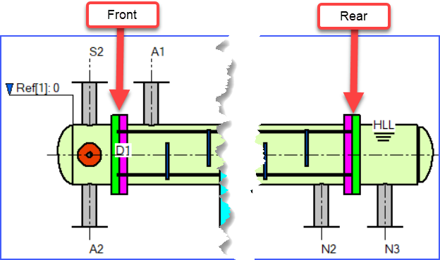

What is the significance of this warning when it appears in my AutoPIPE Vessel report:
496       Tubesheet : Fixed Tubesheets (or junctions with shell/channel) are different (the Tubesheet calculation is based on the front box sheet data).
Answer:
This warning message is specific to a heat exchanger model in AutoPIPE Vessel that contains 2 Tubesheets and 2 Body flanges. One set is referred to as the Front set, while the other is referred to as the Rear set.
Example:
The warning message informs the user that there is a difference between these 2 sets and the application will use the specifications given in the front set for all analysis calculations.
Avoidance options
    1. Accept the warning and do nothing.
    2. Open the component dialogs for all four items and compare them to identify any discrepancies, ensuring that they are configured exactly the same.
      • Pay particular attention to the minor details, for instance: varying widths of gaskets.
