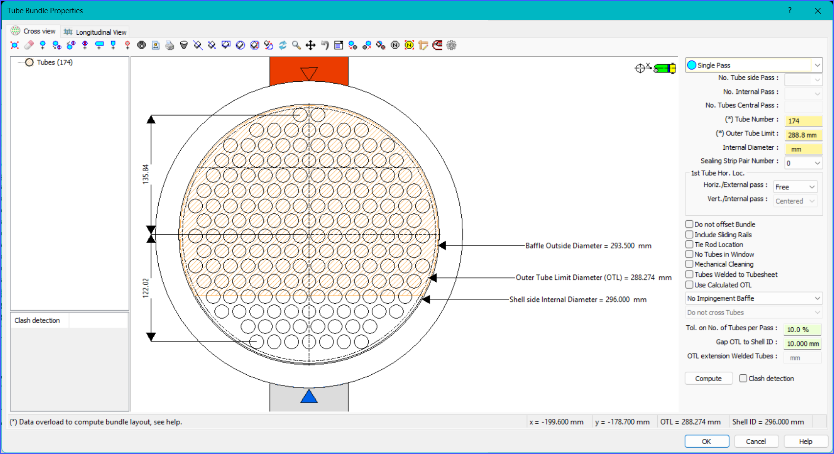

What is the significance of this warning when it appears in my AutoPIPE Vessel report:
669       BUNDLE LAYOUT: the actual value of OTL (288.274 mm) is not equal to the input value (288.8 mm) used for the calculation.
OTL = "Outside Tube Limit"
Answer:

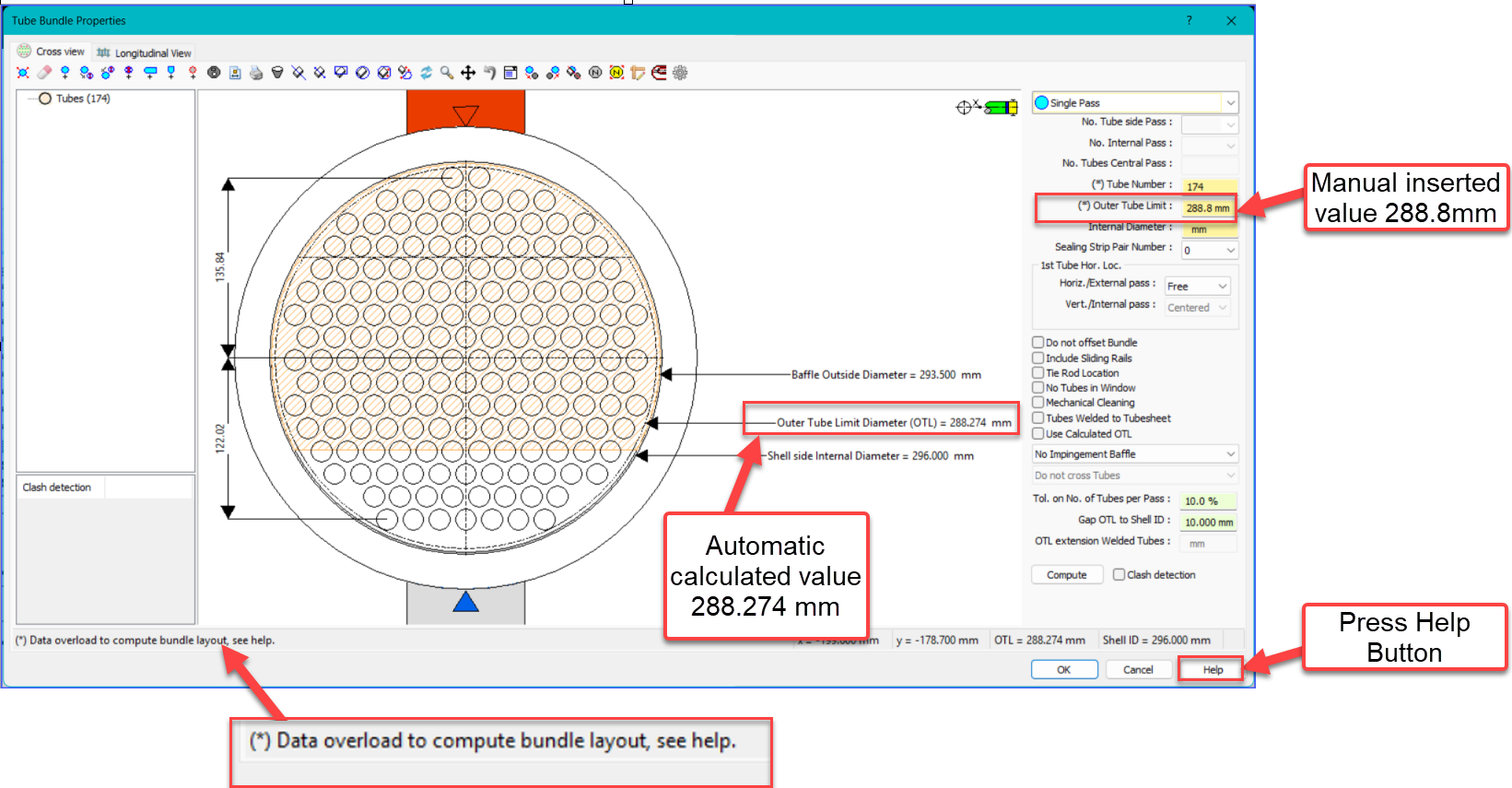

Open Tube Bundle Properties dialog from inside AutoPIPE Vessel:
Select the help and choose the hyperlink for "Outside Tube Limit". This information will help the user understand how to use this field.
The warning message above warns the user that the manual inserted value (ex. 288.8 mm) is not the same as calculated (288.274 mm) by the program (see OTL reference on drawing)
It is evident from the the help information entering an OTL value is unnecessary when the quantity of tubes is specified.
Avoidance options
    1. Accept the warning and do nothing.
    2. Open the Tube Bundle Properties dialog, remove the input value or make adjustments to the input values until the calculated values match.
