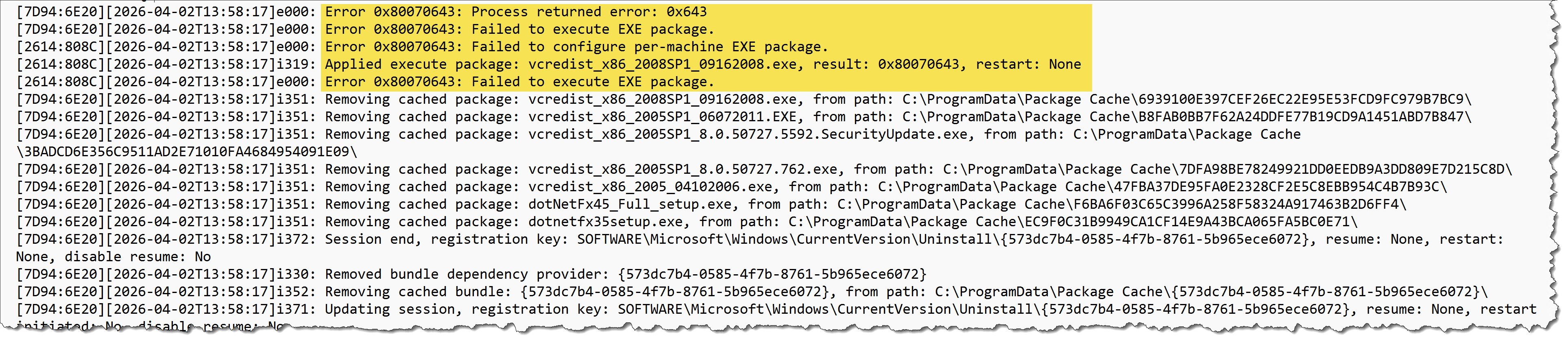

When installing ProStructures for AutoCAD, the installation process fails before completion and automatically rolls back. The log points specifically to the failure of a Microsoft Visual C++ Redistributable component.
