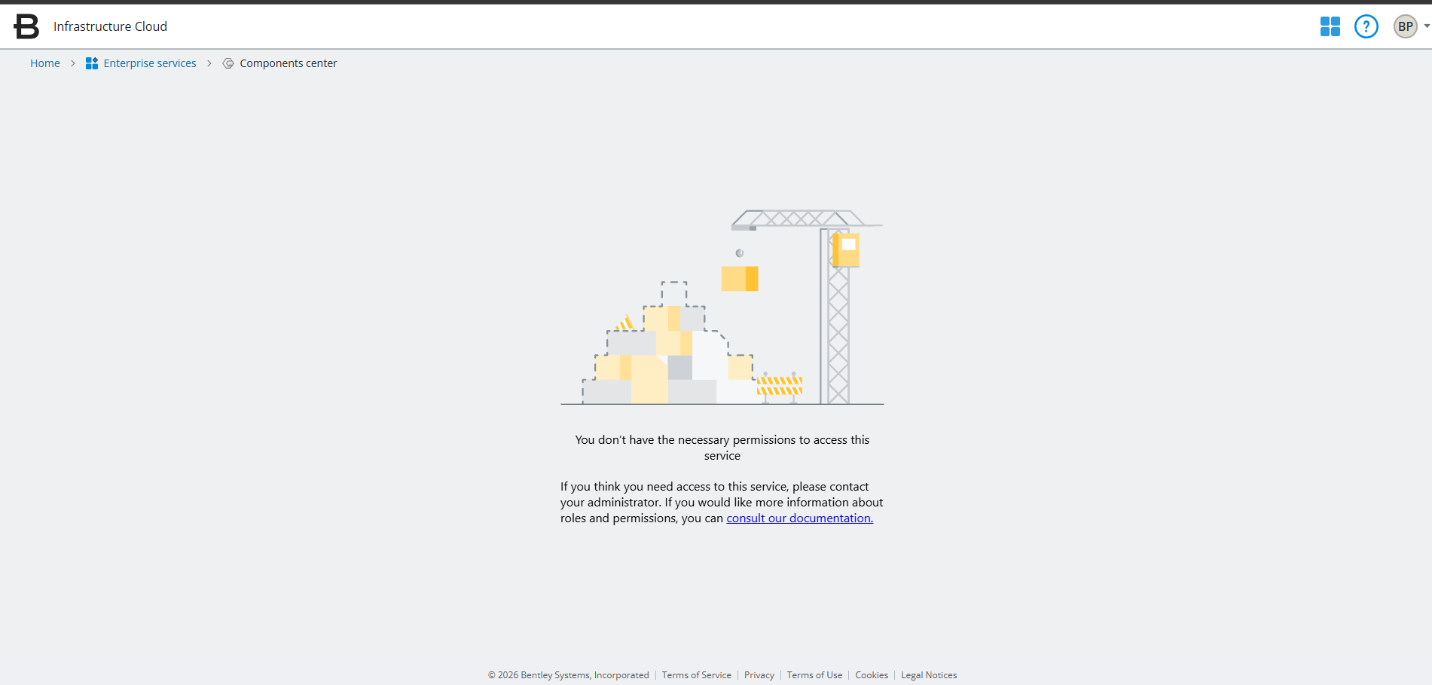

What Happens if Permissions are Missing?
It is important to understand that if a user has not been assigned a role with at least "Read" permission for Components Center, the service will be visible to them but they will be unable to access your organization's component libraries.
If a user reports that they cannot access Components Center, the first step is always to check that they have been assigned a role with the necessary permissions (minimum: Read)
