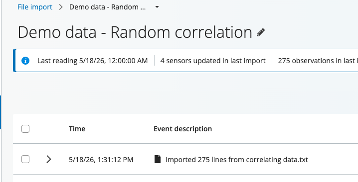

Why am I not seeing new data for my sensor?
If you are using direct integration with your device then the most likely culprit is the device not having an active data connection or it losing power.
If you are using the File Import then there could be issues with your file format that you are sending for automatic collection, such as:
  • wrong timestamp format
  • wrong column count
  • wrong delimiter
    Best way to check is to navigate to your File Import profile and see the history for it by left clicking your File Import profile.

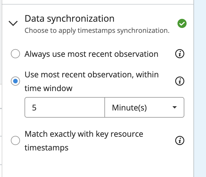

Why am I not seeing any results from a calculation I created?
The most likely causes are:
  • no data present for your source/key sensor
  • you updated your source sensors but haven't re-run the calculation

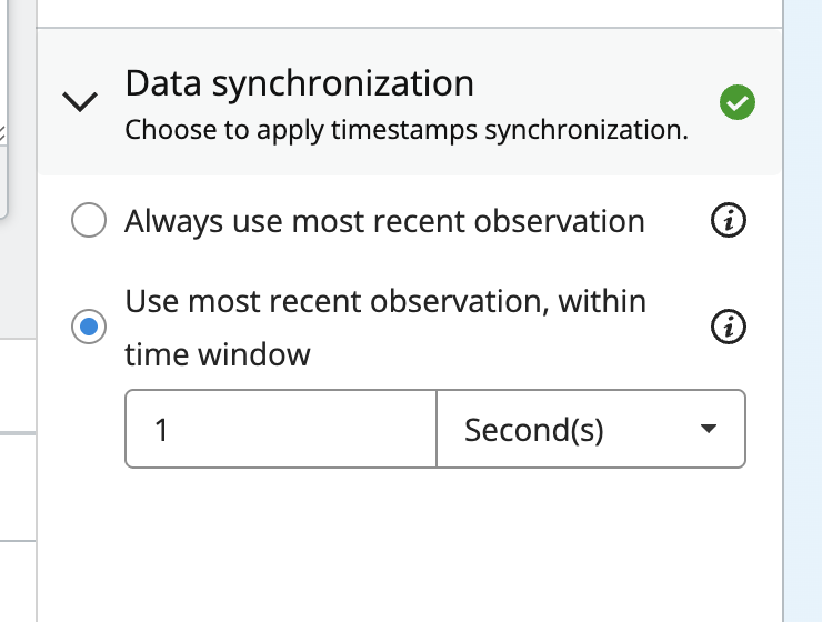

  • you have two sensors in your calculation and they have mismatching timestamps
If you have mismatching timestamps then you can use the "Data synchronization" feature for calculations to account for mismatching timestamps between your two sensors.

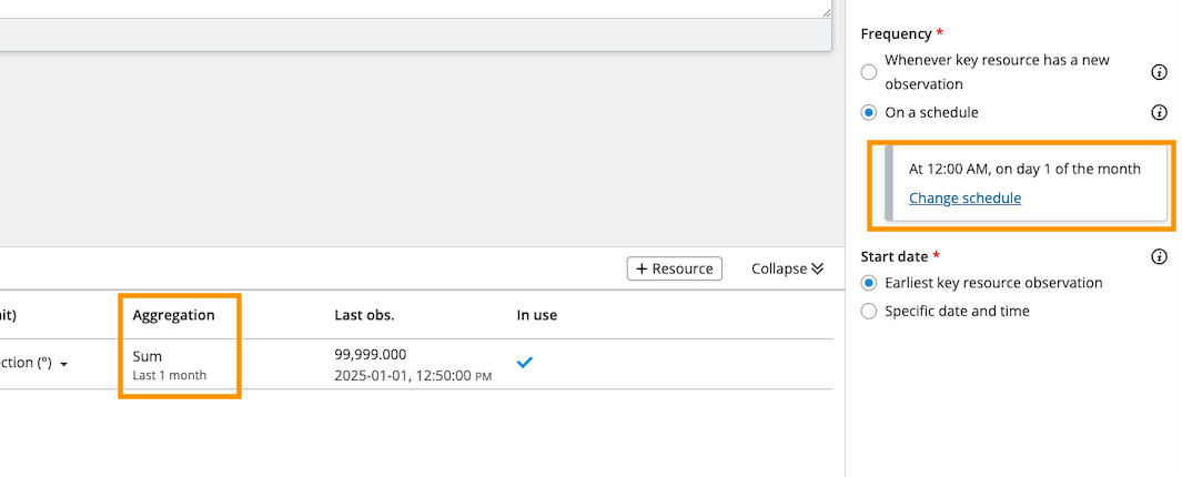

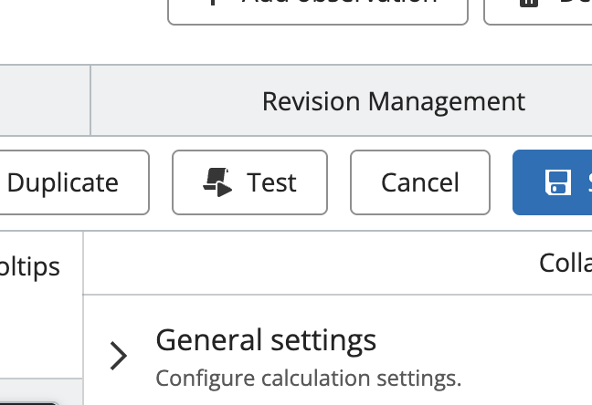

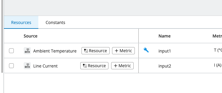

What should I check if a calculation is returning unexpected values?
You can check whether you have the correct metrics selected for your inputs, if you have the correct sensor, whether your calulation formula is correct and if your sensor is giving correct source data. You can use the Test feature to double check that you are getting the correct results.

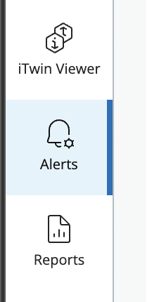

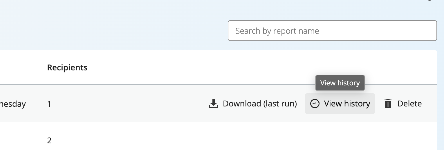

Why is my Report and/or Alert not being sent to users?
There are several reasons why a emails may not being sent to other users on the project. By default, alerts and reports are set to "private", meaning that only the person who has created the alert or report will have access to it. Second, you will want to check that the "mail" icon next to a user's name is turned on for that user.
If all of these settings have been confirmed, it may be necessary to confirm some IT and security settings with the user on their end. First, you will want to confirm that Bentley iTwin IoT URLs are whitelisted (information found here) and that the user's IT policy allows for external emails, specifically iiot_noreply@mailhost.bentley.com for Reports and notifications@sensemetrics.com for Alerts. If that is confirmed, you may ask the user to check their spam, junk, and quarantine folders to ensure that the email was not directed to one of those folders.If you have evaluated all of these common report email issues and still have not figured out the cause, please reach out to Bentley Support

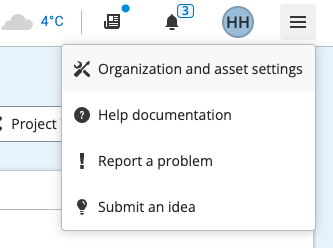

How do I get help from a person for iTwin IoT?
The best way to get help from an iTwin IoT support agent is to read this article and follow the guide there

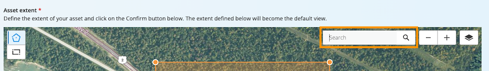

How do I search for specific assets in certain geographical areas when creating an asset?
The best way to do so is to click the spyglass icon in the Asset Extent selection in the Asset creation menu and searching for any landmark or location. You can also paste in Latitude and Longitude coordinates.

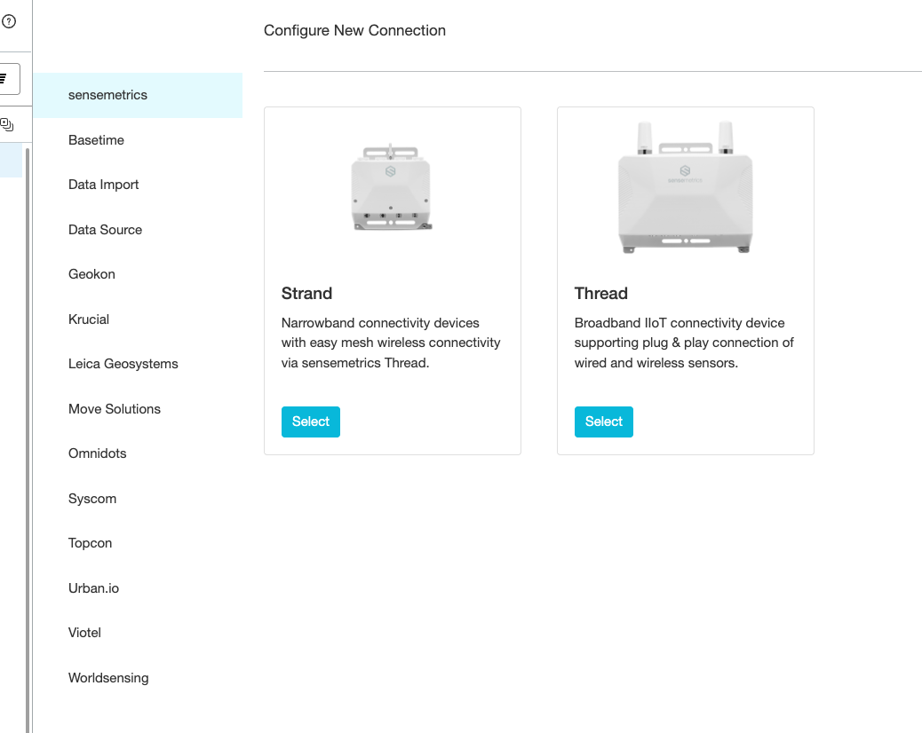

How do I onboard a new IoT device onto iTwin IoT?
in iTwin IoT there are multitude of ways to get data from your IoT device into the system.
For a list of specific devices that can be directly integrated into the system please read our Device Registry webpage and read our Sensors And Data Sources section in our iTwin IoT wiki.
If you have a non-supported device or sensor then we can in most cases ingest the data from that device via our File Import feature. For automatic collection the device needs to suppport the SFTP or FTPS File protocol.

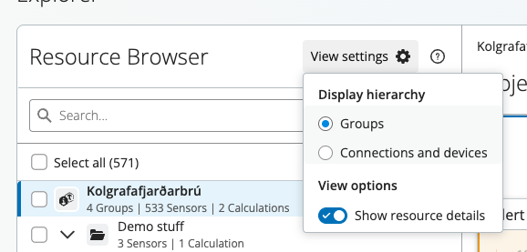

How can I organize the different nodes/devices/sensors in my asset?
The best way to manage your sensors in your asset is to navigate to the Explorer module, click "View Settings", selecting "Groups" and then you can create folders/groups for your sensors. From there you can create groups for Inclinometers, groups for Piezometers and etc. You could also split the groups by location and then have a subgroup for that location by sensor type.

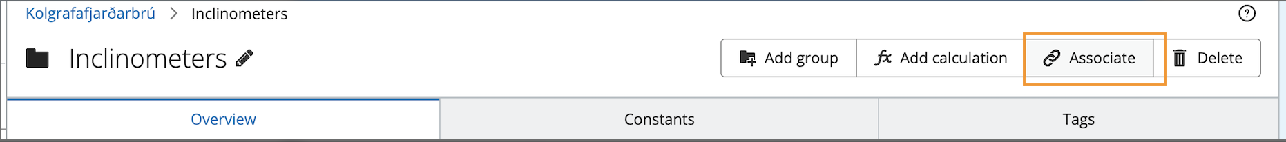

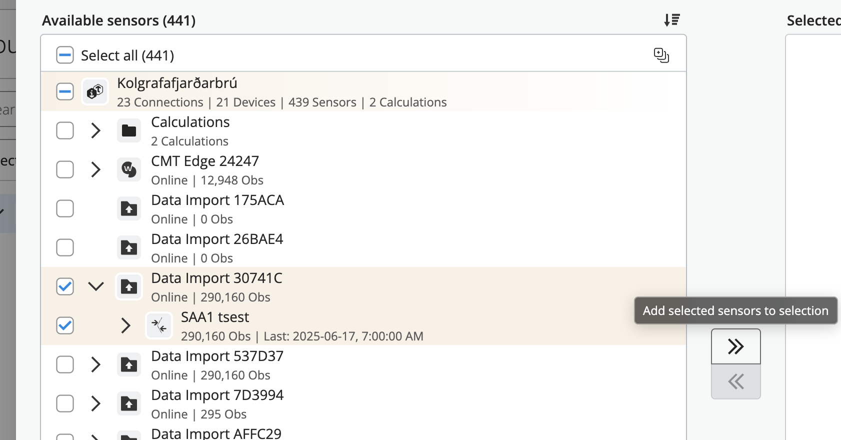

Can I move multiple sensors to a group within Explorer?
Yes you can! The best way to do so is to select your group and click the "associate" button in the upper right corner.
From there you will get the same sensor picker menu as the Explorer with the option to view Devices or view Groups. From there you can pick and choose multiple sensors to add to your group.

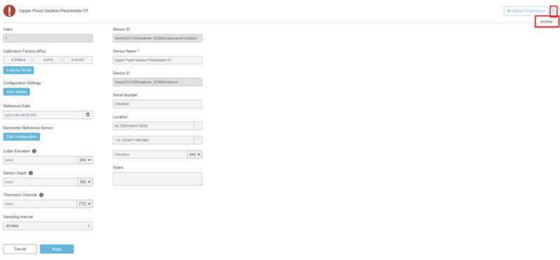

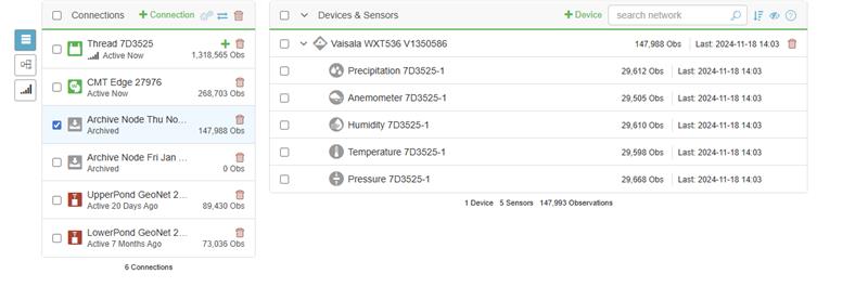

How can I archive a device? Does it matter which connection type?
We have the ability to archive most but not all sensors in iTwin. Anything connected to a Thread, Strand, or Geonet can be archived, as well as some other API connections. For example Move nodes can be archived on the connection side only, and Loadsensing nodes can be archived by connection or sensor but not device. Archived nodes show up grey on the platform and will not receive any data from the sensor, therefore they are removed from the billing profile while keeping the historical data.
To archive the sensor you would click on the desired sensor, go to edit configuration and click on the kebab icon in the top right corner of the page. If there isn't an option there to archive then the sensor cannot be archived.

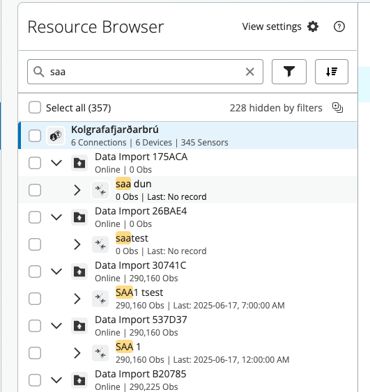

What is the best way to search for a sensor and see all its settings?
The best way is to navigate to the Explorer module and searching for your sensor in the Explorer.

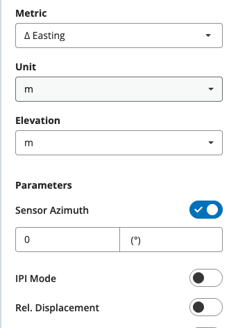

How do I apply barometric correction to a piezometer?
If you have a barometric pressure sensor available that is in the same location as your Piezometers then you can add it as a barometric correction sensor for your Piezometer.
You first find your sensor in the Explorer, click your sensor, navigate to the "Configuration" tab and click the "Edit Configuration" button below the "Barometer Reference Sensor" section. From there you can choose your sensor.
The barometric correction sensor has to have the exact same timestamps as your Piezometer, otherwise the correction will not work

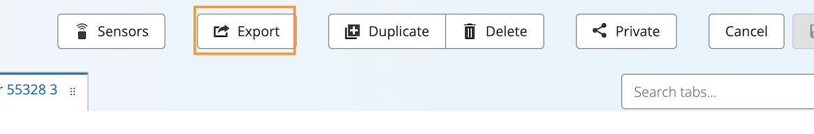

How can I export data in a tabular format?
The best way to do so is to use our new Tables module.
Once you have created and saved your Tables profile which contains the sensors and metrics you need, you can click the "Export" button in the upper right corner. This allows you to export .csv files which contain the sensor observations you have in your profile. Once you click export you should receive an email with a link to your files with each .csv file containing one sensor and the metrics you have chosen.

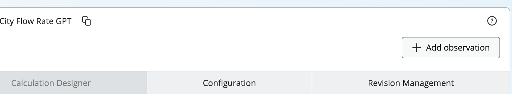

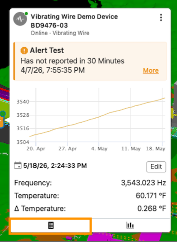

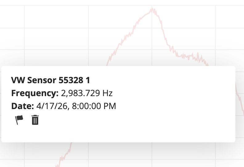

How do I manually upload a one-time individual observation to a sensor?
For a single observation it is best to navigate to your sensor via the Explorer and click "Add observation". From there you can add a single observation for your sensor.

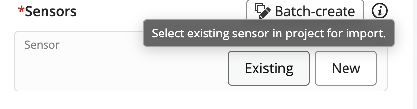

How can I upload missing observations to a sensor/device?
You can either do it manually for one or a couple of observations via the "add observation" method shown above or you can use the File Import tool to bridge data gaps for as many observations as you want.
You need to have your file with your missing observations, once you have that you can create a File Import, upload your file for parsing, select an "Existing" Sensor in the Sensor selection and select your sensor. Then you can assign columns to your metrics. Once you have confirmed that everything looks good then you save the File Import and import the data.
For any future data gaps that might happen you can use that File Import profile to bridge those gaps for that sensor.

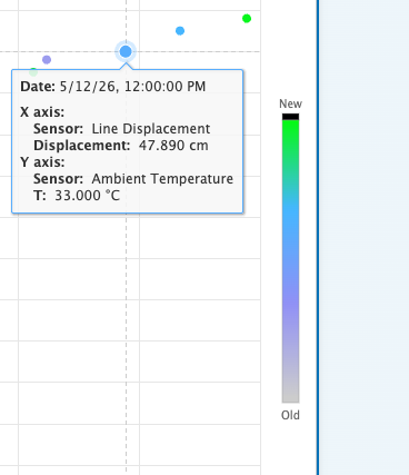

How can correlation help me understand my sensors? When should I use correlation analysis?
Correlation analysis is very useful in finding and analysing if one or more sensors have some sort of correlation. For example:
You have a bridge with Strain Gauge sensors and temperature sensors. When the bridge warms up during a sunny day it might expand and when it gets cold it might shrink a bit. This can be directly seen in a graph by comparing the two sensors.
But when creating an alarm with a threshold it might be difficult to pinpoint if any bridge movement is happening because of varying temperature or actual movement.
This is how correlation analysis and correlation alarms can be useful, if any strain is detected on the bridge but the temperature is not correlated with it then there is abnormal movement which can produce an alert for you.

How can I build a monthly cumulative calculation for my sensor, resetting at the end of each month?
You can do this with the Calculation module. You set the aggregation to Sum with 1 month. Then for the scheduling you set it to run on the 1st of every month.

How can I add a comment to a graph?
While viewing a graph you can click any observation point and a small menu appears, if you click the flag icon you can create an event that is tied to that specific observation point.

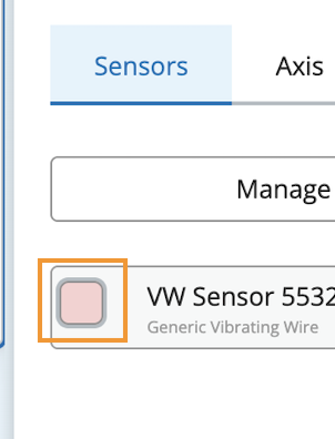

How do I change the color on a time series plot?
While configuring a time-series graph you click the sensors tab and from there you can click the colour block next to your sensor to change the colour for it.

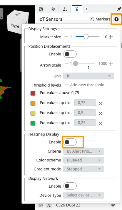

How do I enable the heatmap view within the iTwin Viewer?
When in the iTwin Viewer you navigate to the sensor tab, click the cogwheel and near the bottom of the menu there is a heatmap option.
Can I create heatmap based on sensor metrics instead of alerts?
Yes you can, in the Criteria setting you can choose to have the heatmap display sensor metrics or alerts for those sensors.

What does the interval key represent in a correlation plot and XY plot card?
The interval key is a colorized key that shows what observations are the oldest and which observations are the newest.

Is it possible to place sensors on a map layer?
Yes you can do that with our iTwin Viewer module!

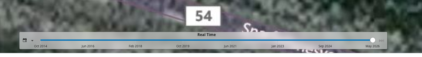

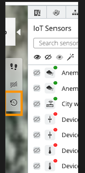

How do I go back in time to view past triggered alerts in Digital twin viewer?
You have two methods.
First is to click the Timeline icon in the iTwin Viewer and using the timeline scrubber to scrub through the timeline for your iTwin View.
The second is to click a sensor marker and click the "Sensor Details" button to see an overview of your sensor. This will give you an overview of everything related to your sensor. Including alerts and past alerts.

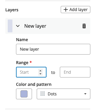

How do a I add different layers to an inclinometer plot?
Once in an XY Graph you can go to the Display tab and add layers there. You define the extent of the layer for the Y axis, the name of the layer, colour of it and the pattern.

How can I apply a rotation factor to IPI data?
If you want to apply an azimuth correction factor for your XY IPI graph, then you choose any of the metrics that apply azimuth or structural angle correction and from there you can adjust the angle. For more details on how azimuth angles work please read through this article

Can I duplicate an existing calculation to reuse its configuration?
Yes you can! When viewing a pre-existing calculation you can duplicate it with the duplicate button in the upper right corner.

What is the difference between selecting a “Custom” sensor type and an “Existing” sensor type when creating a calculation?
An existing sensor type is a pre-defined sensor that serves as a template for your data, for certain sensors (f.e. Piezometers) it will offer you calibration factors, barometric correction and etc to produce a variety of calculated values from the raw Hz and Temperature measurements.
A custom sensor is for when you have a sensor that doesn't exist in our existing sensor type, this allows you to define your own custom sensor with its custom metrics.
How does the key resource influence when a calculation is triggered?
The key resource is the root sensor metric. It has multiple use cases.
If you want the calculation to update whenever new data arrives then that Key Resource sensor is the sensor that triggers that update.
If you have two sensors with different timestamps, for example one at 6 minute interval and another at 10 minute interval then you can choose to have the 10 minute interval sensor as the key resource and set a buffer backwards from that key resource's timestamp to include the other sensor. This ensures that you get valid data points.
How can I use multiple sensors within one calculation in the calculator?
You simply drag and drop both of your sensors into the resource window for your calculation. From there you can choose which metric you want to input into your calculation.

How do you create, test, and manage alerts (including acknowledge/snooze/disable), and where can you review trigger history?
This can be done by clicking the Alerts module on the left pane. On that page you can get a birds eye view of all the alerts for your project and manage those alerts.

How do I set up an alert on all sensors in a device? I don't want to manually create one for each sensor.
When creating an alert you can add multiple sensors to that alert so that they can all share the same Trigger/Threshold rules.

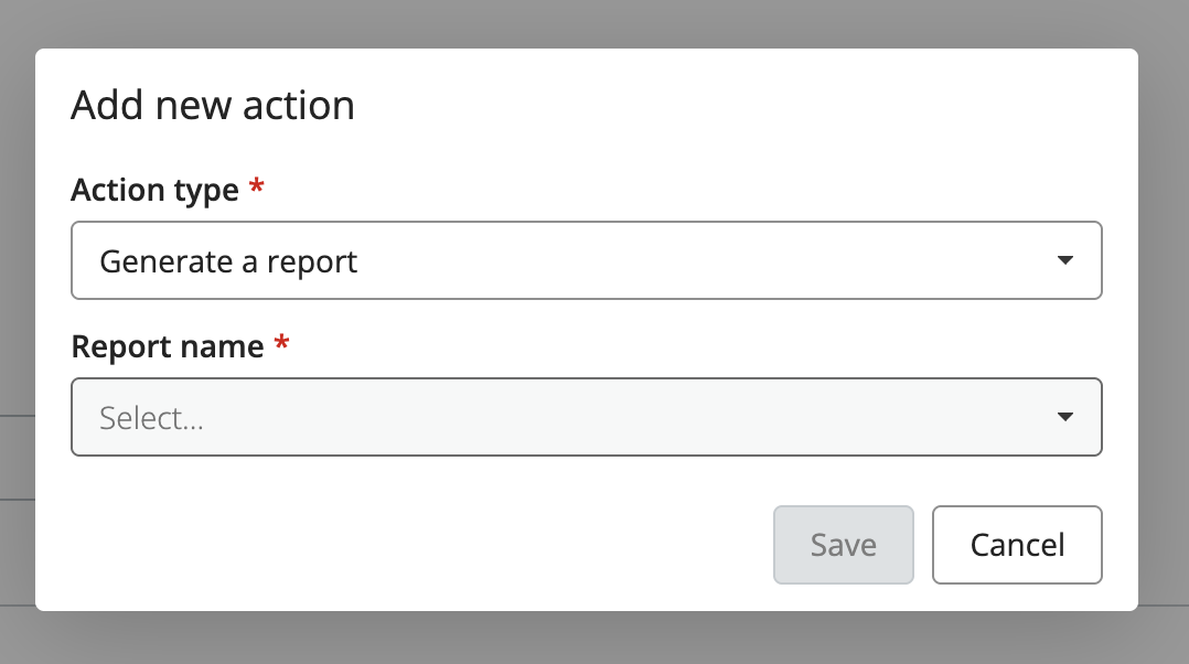

Can I trigger an email with a report if an alert is triggered?
Yes you can! Once you've set up a Report you can trigger that report via the Action feature for alerts.

Where can I audit the history of automated reports?
You can do that by navigating to the Report profile selection and clicking the "view history" on the right side of each respective report.
