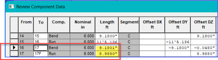

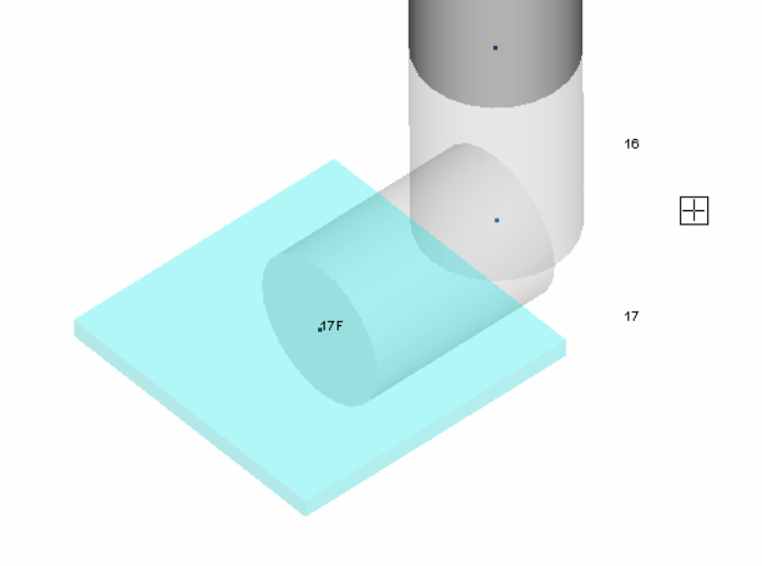

The most common issue causing this problem is the distance between the Bend's Near point and the TIP point or the TIP point and the Bend's Far point is to small to draw in the entire arc of the bend.
Lets look at an example:
1. Locate and observe the problematic node point.

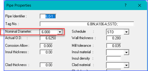

2. Find the PipeID's Nominal dimension used for the bend

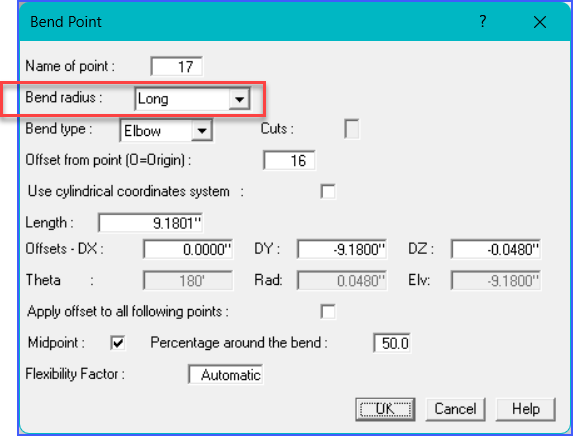

3. Find the bend radius specified:
4. Next find the distance node point distance used to make the bend. (hint, review the Points tab on the input grid)
5. Review the information gathered:
A 6" long radius bend with Near node point 9.18" away from the TIP, and 9.98" from the TIP to the Far end of the bend.
Question: Is 9.1" and 8.9" enough distance to draw a Long radius bend?
Answer: No. A long radius bend needs 1.5 x Dia, or 9" to be drawn correctly.
