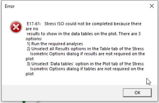

E17-61: Stress Iso could not be completed because there is no results... error message in AutoPIPE
The following is displayed when opening a model in AutoPIPE:
Error:
E17-61: Stress ISO could not be completed because there are no
results to show in the data tables on the plot. There are 3 options:
1.    Run the required analyses
2.    Unselect all Results options in the Table tab of the Stress Isometric Options dialog if results are not required on the plot
3.    Unselect Data tables’ option in the Plot tab of the Stress Isometric Options dialog if tables are not required on the plot
OK
How to fix this issue?
AutoPIPE has no results information for the current model opened.
Why does this occur?
There could be a number of scenarios where this could happen:
    1. Copy a model to a new folder, open the model, and trying to create a stress iso
    2. Saving a model back to a previous version with a new filename, opening the model, and trying to create a stress iso
    3. With the model opened, press on the Analysis Results (Analysis > Delete > Analysis Results) command, and trying to create a stress iso
    4. etc...
Avoidance:
Consider the options mentioned on the Error dialog:
    1. Press OK button on the dialog, review all analysis settings, Analyze all, and press Save Stress Isometric (File > Isometric > Save Stress Isometric) command to process a stress isometric
In order to use the other 2 options, immediately after pressing Ok to the error message above, try again to generate a stress isometric. This time the error message will not be displayed and continue to use the remaining 2 options mentioned:
    1. Unselect all Results options in the Table tab of the Stress Isometric Options dialog if results are not required on the plot
    2. Unselect Data tables’ option in the Plot tab of the Stress Isometric Options dialog if tables are not required on the plot
