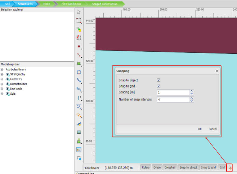

PLAXIS 2D – Snapping Settings
In PLAXIS 2D, snapping occurs to grid lines.
To access the snapping settings:
  • Click the Snapping options icon at the bottom of the drawing canvas.
  • In the Snapping window, define the Number of snap intervals.
The Number of snap intervals divides the main grid spacing into equal parts, allowing snapping at finer distances while keeping the original grid unchanged.
Note: You can always adjust the Spacing, to adjust the size of the grid cells, indicated by crossing perpendicular lines on the drawing area.
Snapping setting in PLAXIS 2D

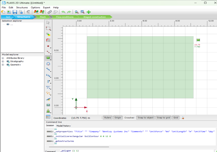

Example – Refining Grid Precision
Assume the grid spacing is set to 1 m.
  • If 4 snap intervals are defined, the 1 m spacing is divided into four equal parts.
  • This enables snapping at 0.25 m increments.
  • Geometry can be placed more precisely without changing the primary grid spacing.
This approach is particularly useful when modelling structural elements, excavation boundaries, or interfaces that require accurate alignment.
Drawing with Spacing of 1m and Number of snap intervals at 4 in PLAXIS 2D.

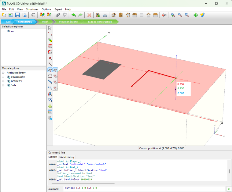

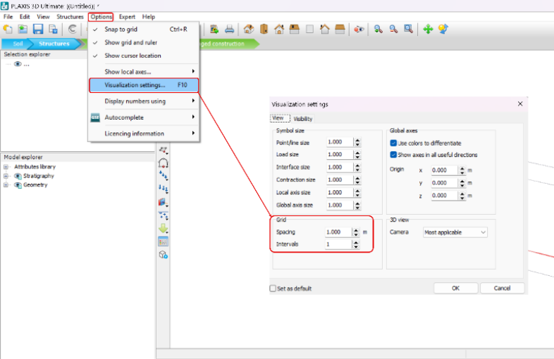

PLAXIS 3D – Snapping Settings
In PLAXIS 3D, snapping occurs to grid points rather than grid lines.
To access the grid snapping settings:
  • Open the Options menu.
  • Select Visualisation settings.
  • Locate the Grid options and define the Intervals parameter.
By adjusting the Intervals value, the main grid spacing is subdivided into smaller snapping increments.
Note: You can always adjust the Spacing, to adjust the distance between the grid points. Points of the grid are shown in the rulers which are displayed at the location of the mouse cursor when a drawing tool is selected.
Snapping grid options in PLAXIS 3D
Drawing with Spacing of 1m and Number of snap intervals at 4 in PLAXIS 3D.
Note: The parameter is called Number of snap intervals in PLAXIS 2D and Intervals in PLAXIS 3D, but both control the same snapping functionality.
