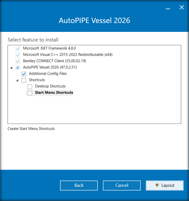

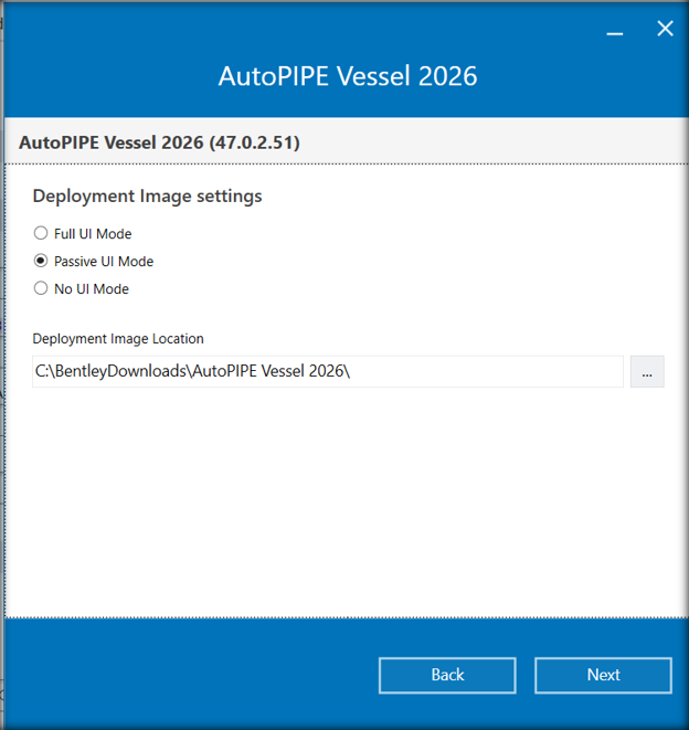

  3. Run the setup executable with the /layout parameter to download all required installation files.
Example command:
Setup_AutoPipeVesselx64_47.00.02.051.exe /layout

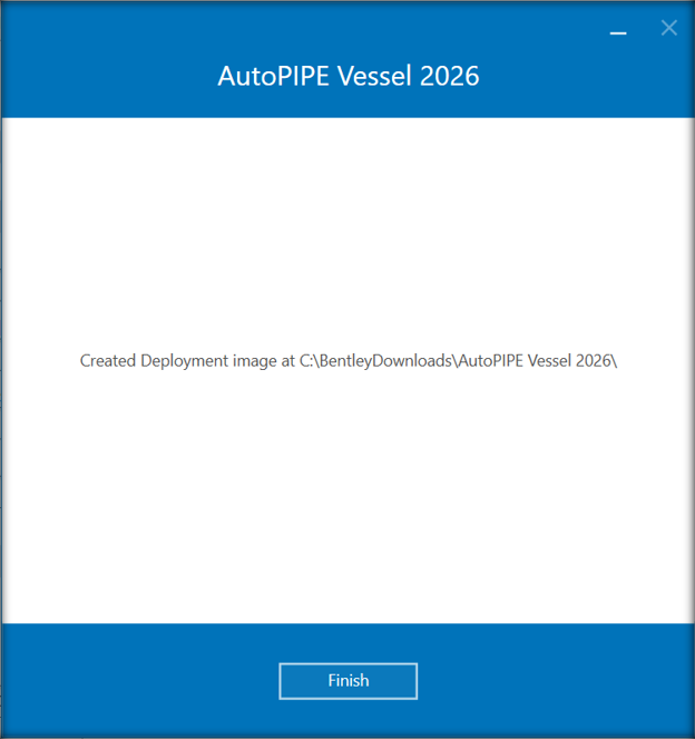

This command downloads all necessary installation components creating a complete local installation layout.
Notes:
    1. An internet connection is required while the layout files are being downloaded.

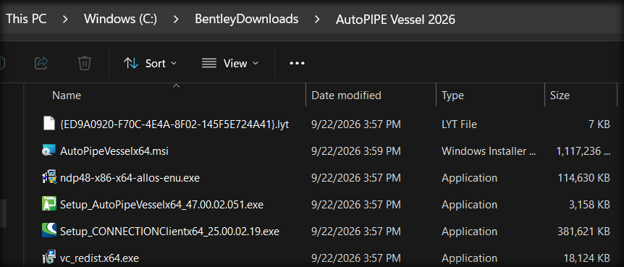

    2. Once the process is complete, the installation files can be copied or moved to any other machine or network location for offline installation.
    3.  Default folder location: C:\BentleyDownloads\AutoPIPE Vessel 20xx.

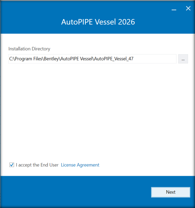

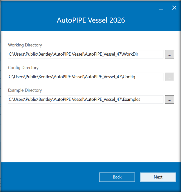

  3. Run the setup executable (ex. Setup_AutoPipeVesselx64_47.00.02.051.exe) to start the installation process.
  4. Perform actions on the installer dialogs as needed.
