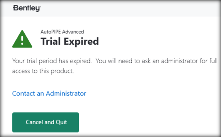

Why does the following message appear when opening AutoPIPE:
Trial Expired
Your trial period has expired. You will need to ask an administrator for full access to this product.
Contact an Administrator
