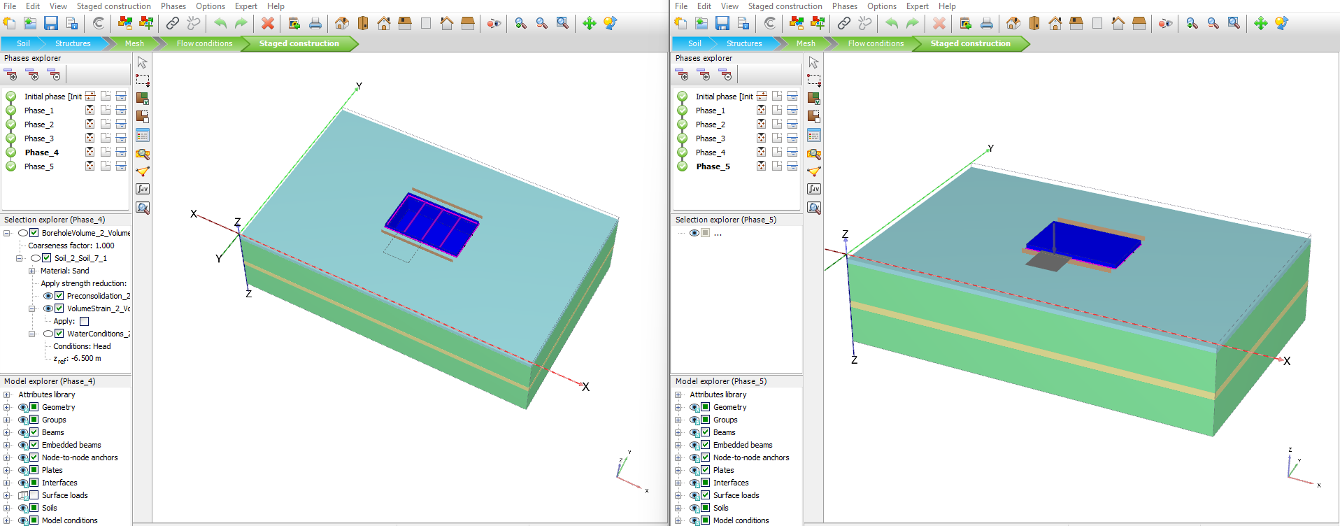

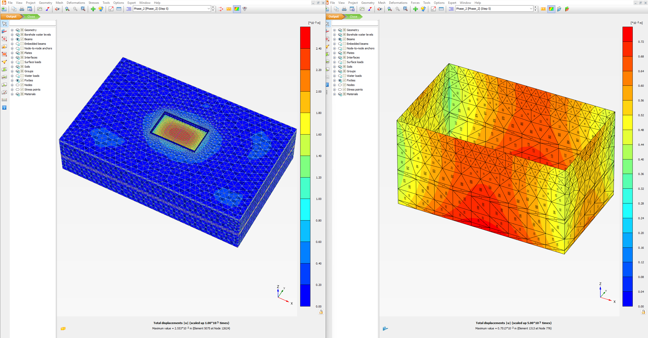

In PLAXIS, consider a situation where a horizontal slab is rigidly connected to a vertical wall while both are modelled as plate elements and activated in different phases. An excavation with a vertical wall was activated in Phase_1, and a horizontal slab was activated in Phase_4.
Excavation example with horizontal slab and vertical wall
The vertical wall has undergone some deformation before the horizontal slab is activated in Phase_4.
Vertical wall deformation before activating the Horizontal Slab

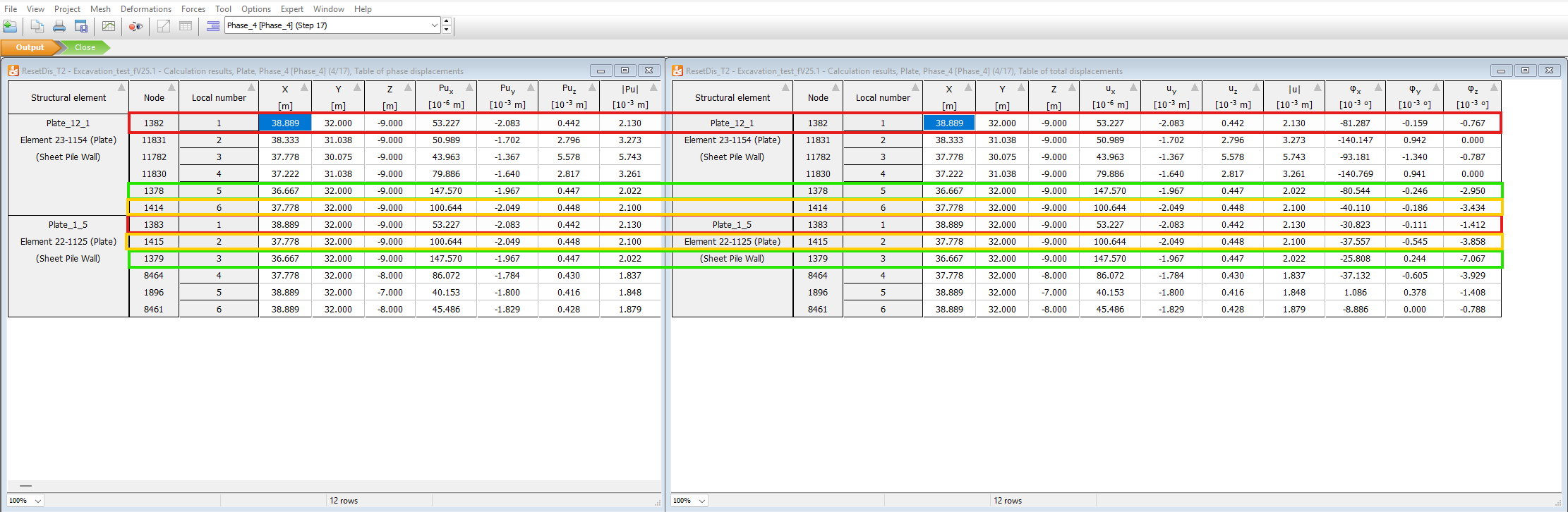

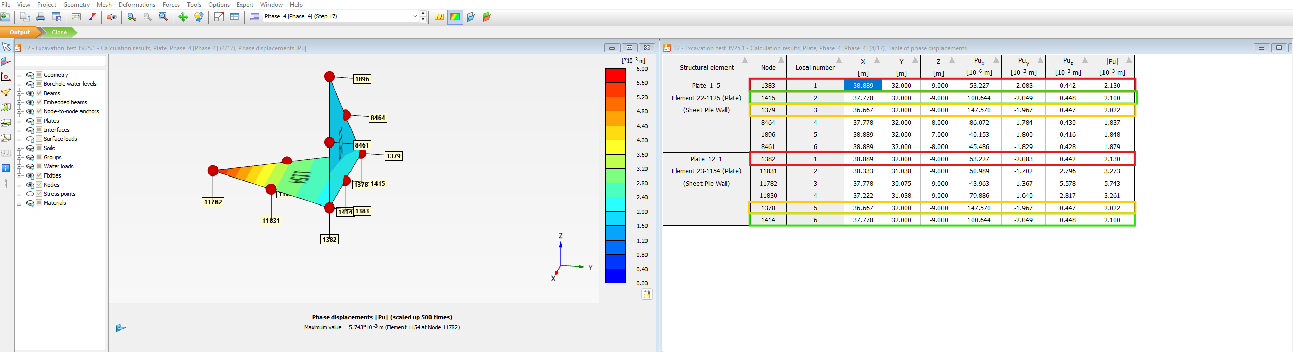

PLAXIS provides several ways to visualize displacements. Below we can see the different displacements at shared nodes.

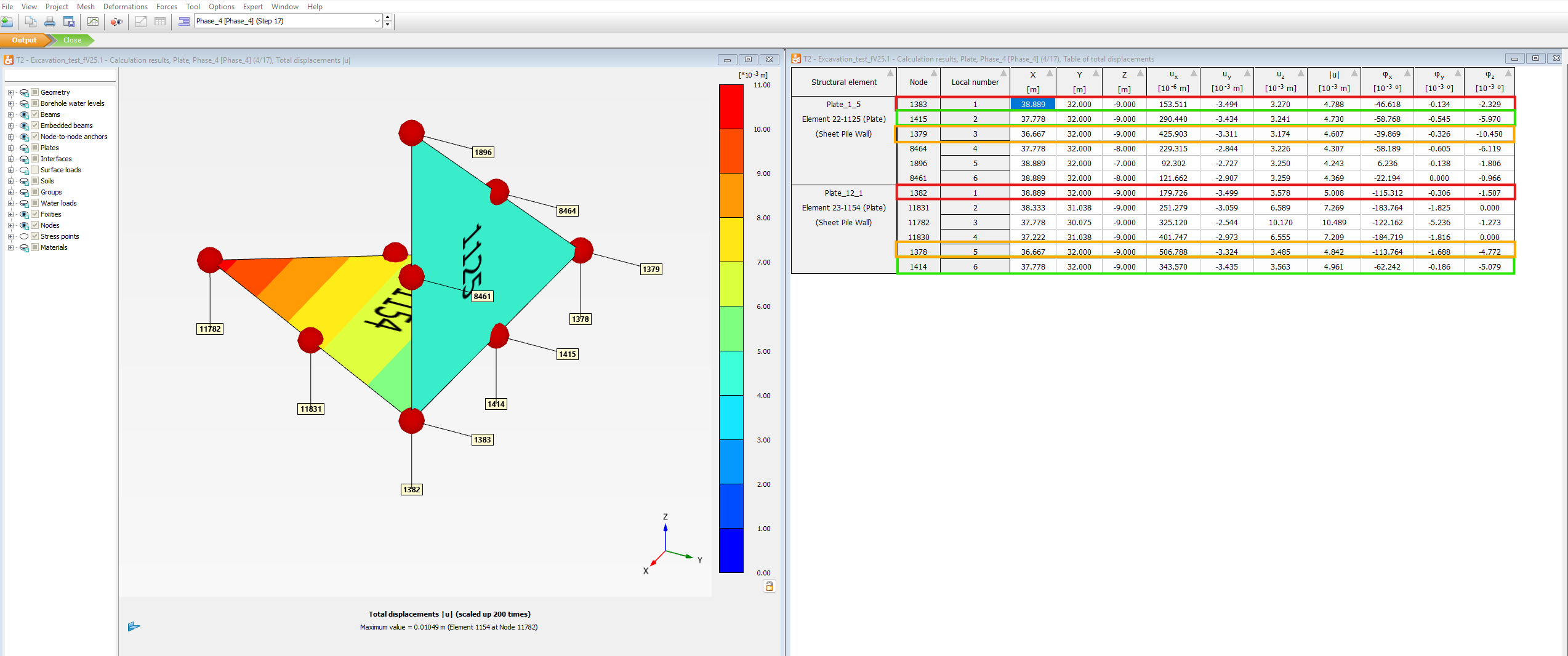

Total Displacements
These are the accumulated displacements at the end of the current calculation step. These displacements can be selected from the Deformations menu, and they are represented as vectors ∣u∣ or as individual components ux​, uy​, and uz​.
When looking at the Total displacements of the shared node, different values for the horizontal slab and the vertical plate are observed.
This key difference occurs because the newly activated horizontal slab is geometrically fitted to the already deformed mesh.
PLAXIS applies an initial, non-mechanical displacement to the slab's nodes to match the position of the deformed vertical wall. The 'Total Displacement' of the slab node, therefore, includes this initial adjustment, whereas the 'Total Displacement' of the wall node reflects its true deformation history from previous phases, too.
Shared Node of Horizontal Slab and Vertical Wall
Different Total Displacement at the shared nodes

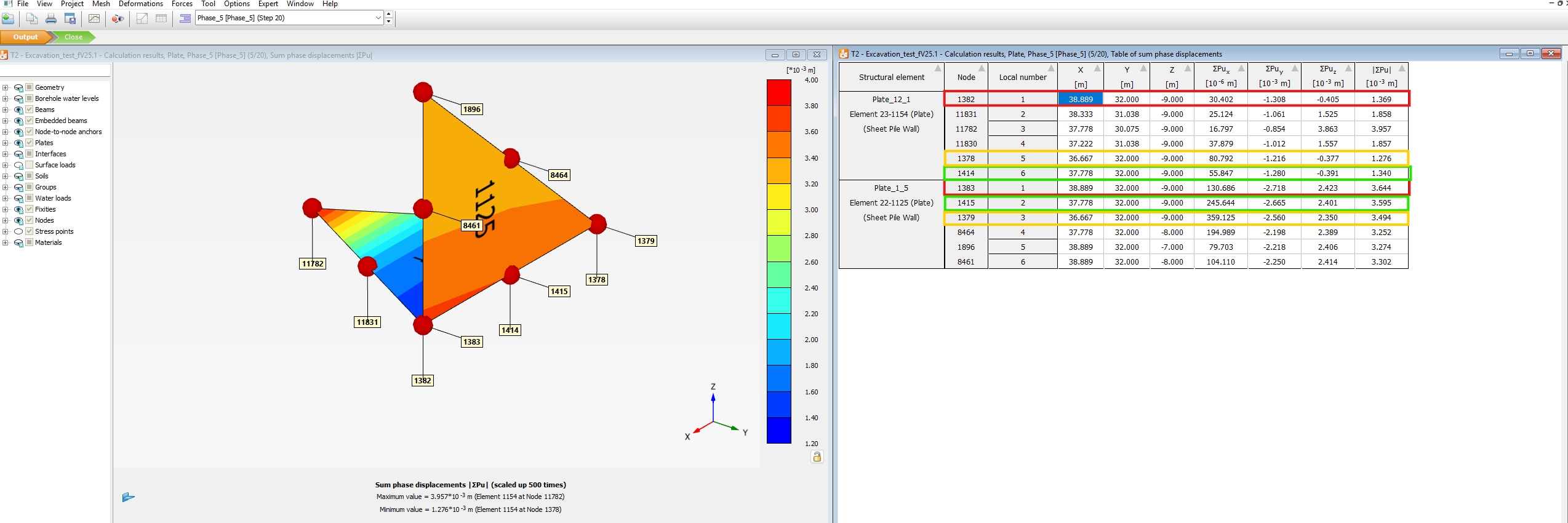

Phase Displacements
These are the accumulated displacement increments at the end of the selected calculation phase. They refer to the displacements that occur during a specific calculation phase and are computed as the sum of incremental displacements over all steps within that phase.
Crucially, these displacements exclude the initial geometric adjustments applied to newly activated elements. Because they only show the movement calculated during the phase, the values at the shared node are identical for both the wall and the slab. This allows you to isolate the deformation caused by the loads and construction steps within that specific phase.
Like total displacements, phase displacements are selected from the Deformations menu and can be displayed as vectors ∣Pu∣, or as individual components Pux, Puy, and Puz.
The shared node has the same displacement when we see the Phase displacements result.
Same Phase Displacement at the shared nodes

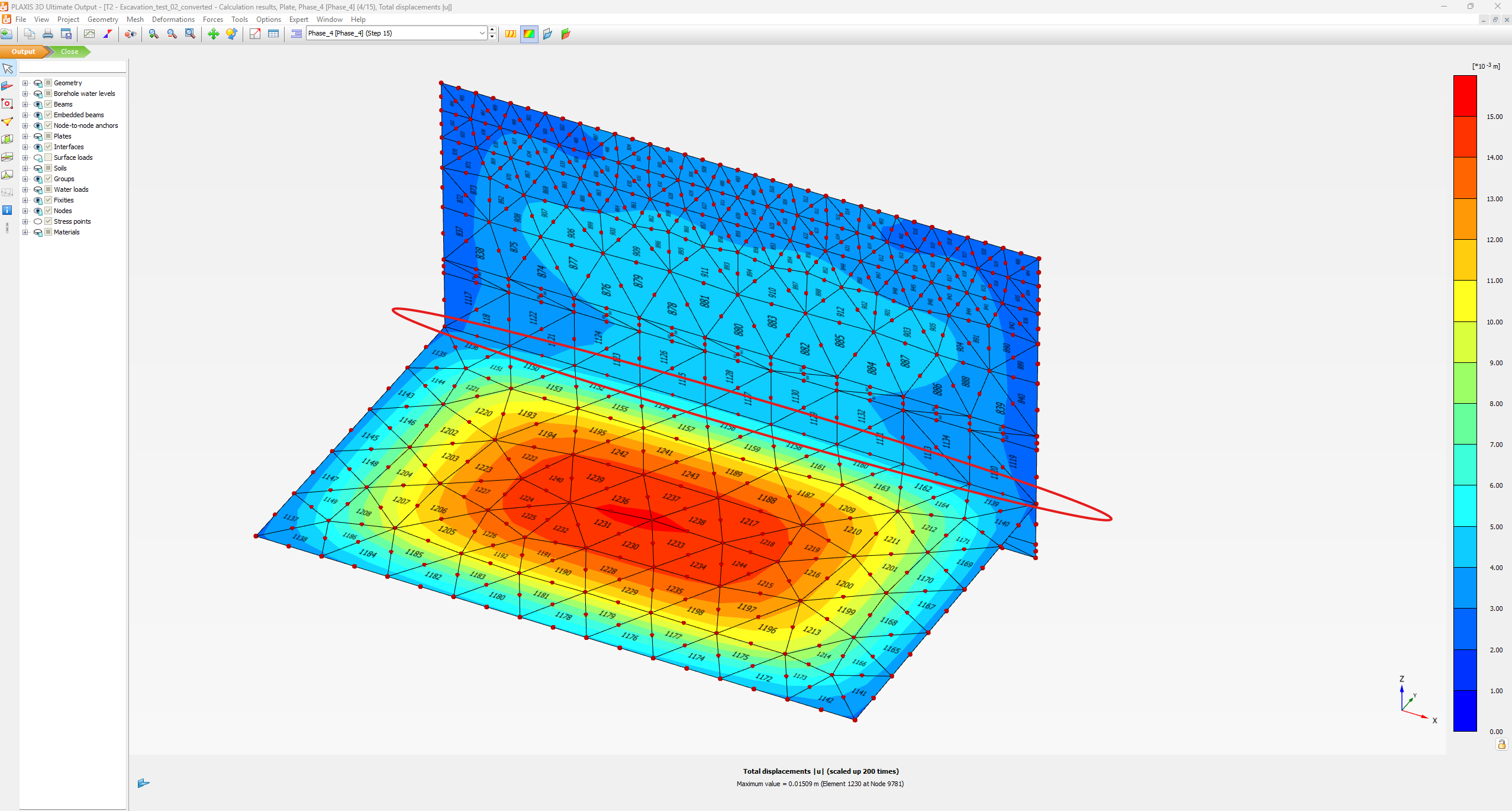

Reset Displacements to Zero
PLAXIS has an option to reset all displacements to zero at the start of a phase, which is located in the Phase window settings.
This means the newly activated Horizontal slab or vertical wall starts with zero recorded movement. Hence, the Total displacements will now match the Phase displacements, and in both conditions, you will see the shared node has the same displacement value, even though they are activated in different phases.
Warning: This resets displacements for everything in the model, including soil. Use it only if that’s acceptable for your analysis.
By using the “Reset displacements to zero” option at the construction phase, where the horizontal slab has been activated (Phase_4), the total displacements and phase displacements will be the same for the shared node.
Similar Total and phase Displacement with Reset Displacement to Zero

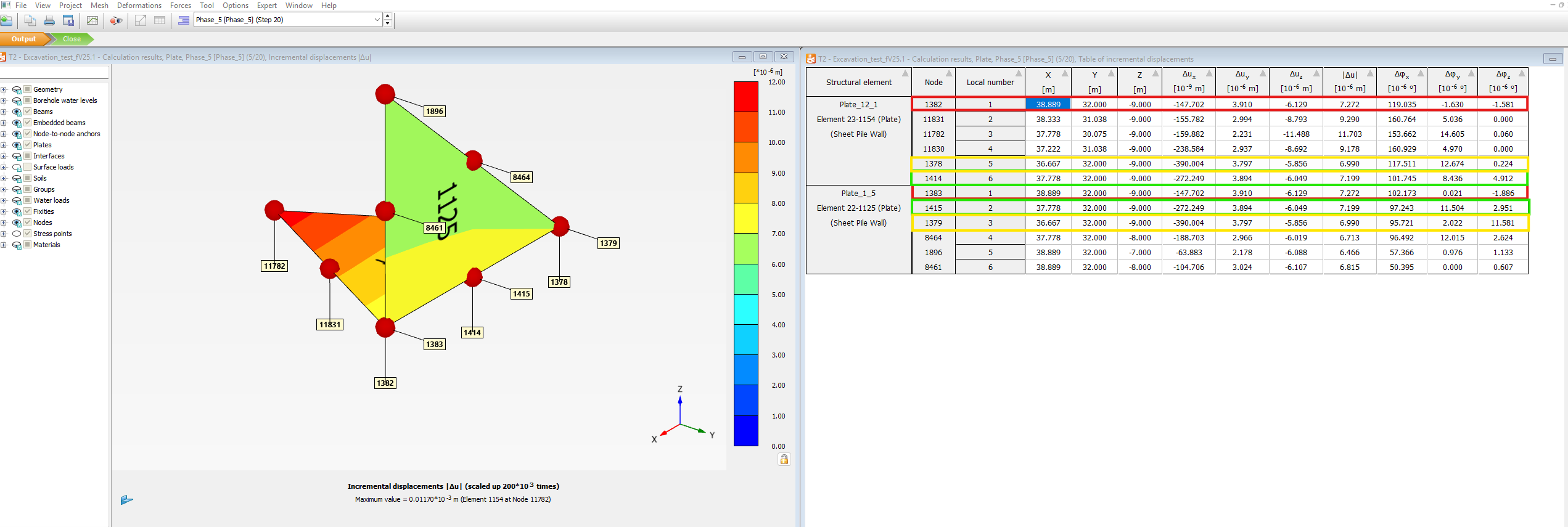

Incremental Displacement
This option displays the displacement increments that occurred within a single calculation step (or load step). This is particularly useful for visualizing failure mechanisms, as it highlights the areas with the most significant movement in the final (or any intermediate) step of an analysis.
Note: PLAXIS by default only stores one (1) calculation step per phase. To change this option read the article How to setup the number of steps stored in PLAXIS Input.
Increment Displacement at the shared nodes
