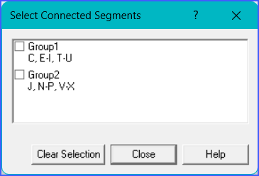

When modeling more than one group of connected segments in AutoPIPE, the training documentation refers to these as disconnected segments. To verify whether a model contains disconnected systems, use AutoPIPE’s Connected Segments command (Select > Segments > Connected Segments), imaged below.
In larger models with complex piping layouts, this tool is especially useful for identifying which pipeline segments are connected to one another. It can also be used to isolate or hide a group of segments while working on a different portion of the model.
To answer the question, can AutoPIPE model disconnected systems, where a group of connected segments represents a different type of piping system, ex. Fluid or Gas?

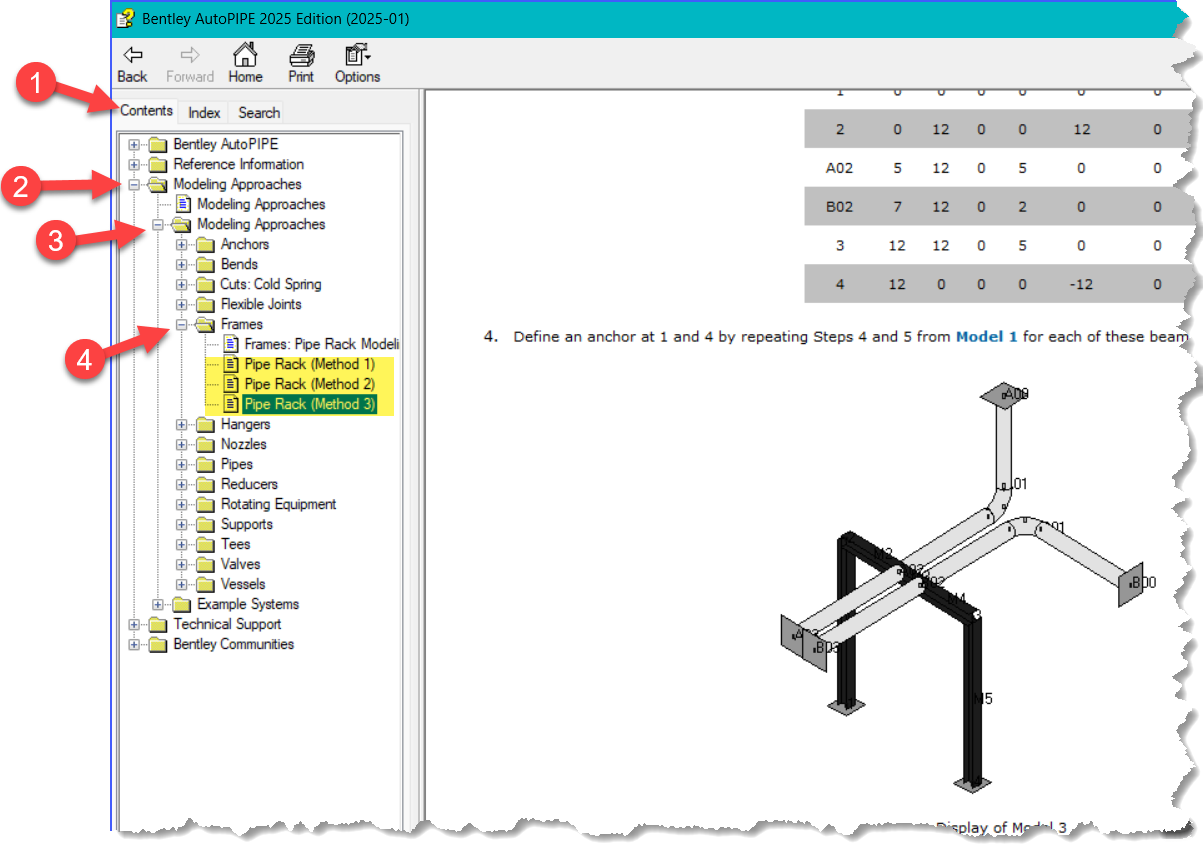

When modeling support frame structures, each disconnected piping system (for example, Gas 1, Gas 2, Fluid 1, etc.) may have their its own independent beam structure. Or, two or more disconnected piping systems can share the same beam structure (see AutoPIPE Help for details).
- For example, the image above may represent one or more disconnected piping systems supported by a common frame structure. In this example, the piping with the vertical elbow could represent a GAS 1 system, while the piping with the horizontal elbow could represent a Fluid 1 system.

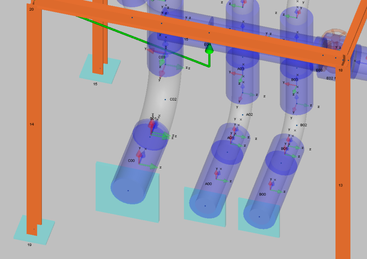

- For each respective disconnected system, change all the pipe properties of that system to increase the Insulation based on the largest displacement.
- Next, use the command to visually show the Insulation in a model.
- This would be overly conservative envelope of movement for that disconnected of piping.
- Manually review the system for overlapping insulation, this would be a possible location for clash detection and further investigation.
