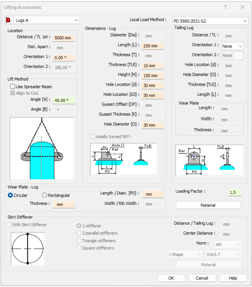

Q. Does AutoPIPE Vessle perform any calculations for Lifting vertical Vessels?
Answer:
Yes, AutoPIPE Vessel has the ability to model and perform calculations on both Trunnions and Lug lifting accessories for vertical vessels. Please review "Lifting Accessories" dialog:
In addition, review program help for details and limitations of lifting accessories.
