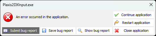

When using the latest version of ProjectWise (for example, 25.0.2) together with PLAXIS 2024.3 or earlier, an error can occur during startup, preventing PLAXIS from starting or loading a project.
The following window appears (example from PLAXIS 2D):
When you click the “Show bug report” option, the exception message in the General tab includes the following:
“Access violation at address 00007FFDF22A92A0 in module 'MSVCP140.dll'. Read of address 0000000000000000.”

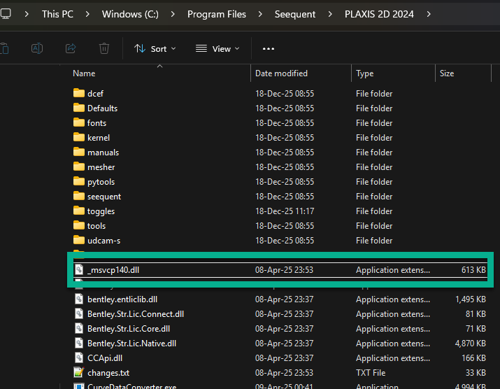

  2. In the installation folder, locate the file named “msvcp140.dll”.
  3. Apply one of the two options below:
    • Option 1: Rename the file by adding a single underscore character at the beginning (_); see screenshot below.
    • Option 2: Delete (*) the file from the directory or move it to a different folder (e.g., Desktop).
  4. Done! This should prevent PLAXIS from reading the specific “msvcp140.dll” file and allow it to launch without issues.
This DLL is shipped with PLAXIS and is not a system-wide file. Deleting or renaming it only affects PLAXIS and can be safely reverted by either using the PLAXIS installation to “Repair” it or by restoring the file name.
