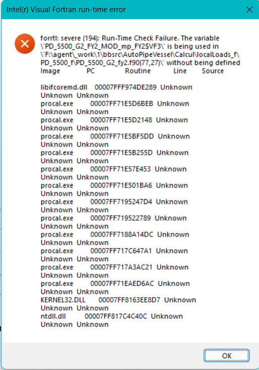

Q. forrtl: severe (194): Run-Time Check Failure. . message in AutoPIPE Vessel, why?
The following may appear when using AutoPIPE Vessel:
Intel(r) Visual Fortran run-time error
forrtl: severe (194): Run-Time Check Failure. The variable \'PD_5500_G2_FY2_MOD_mp_FY2$VF3\' is being used in \'F:\agent\_work\1\bbsrc\AutoPipeVessel\Calcul\localLoads_f\PD_5500_f\PD_5500_G2_fy2.f90(77,27)\' without being defined
Image              PC                Routine            Line        Source

OK
Why and how to avoid the issue?

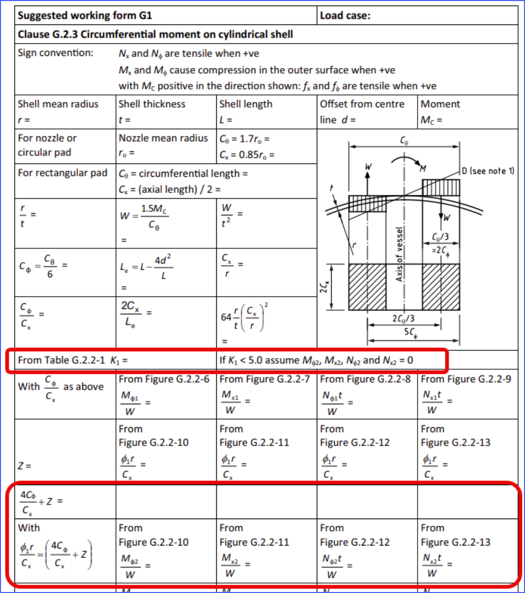

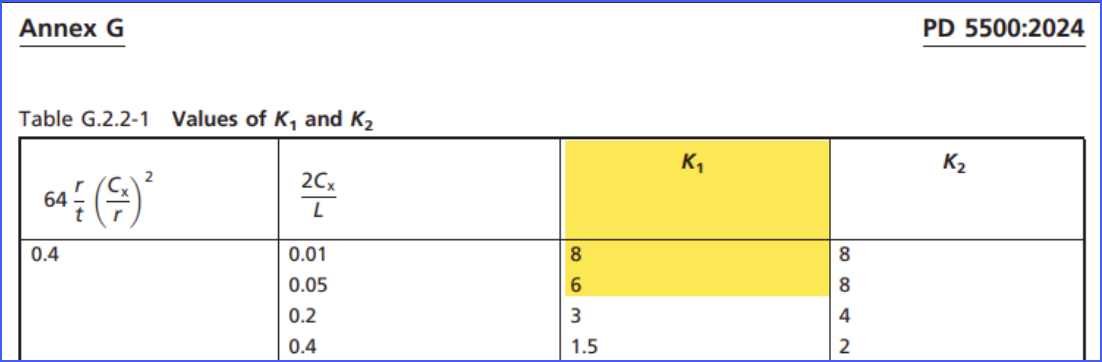

This issue was only reported one time to technical support and was related to performing local loads to PD 5500.
The issue occurs when checking the circumferential moment on cylindrical shell as per G.2.3.6 only when K1 (Table G.2.2-1) is greater than 5.
