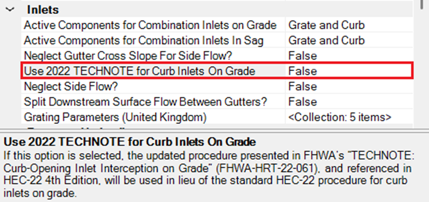

The fourth edition of the HEC-22 manual references FHWA's "TECHNOTE: Curb-Opening Inlet Interception on Grade" (FHWA-HRT-22-061). If you need to adopt this updated procedure instead of the standard HEC-22 calculations for curb inlets on grade, select "True" for the Calculation Option "Use 2022 TECHNOTE for Curb Inlets on Grade" (Analysis > Options):
Note: this calculation option was introduced in version 24.00.03.23 of the OpenFlows Storm and Sewer products, and version 25.00.00.184 of OpenRoads and OpenSite. It is available with the GVF-Rational, GVF-Convex, and Explicit solvers.
