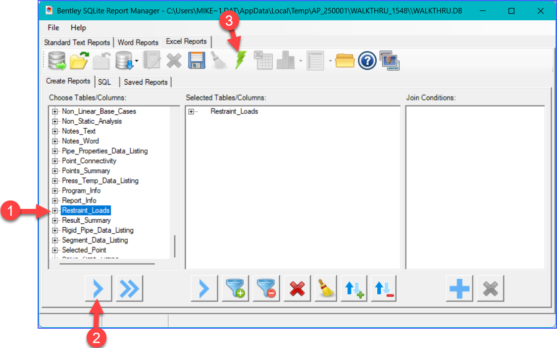

  3. Select Excel Reports command (Result > Report Manager > Excel Reports).
  4. The following dialog will appear:
  5.  At this point, Excel Reports tab is displayed by default. Take a few moments to review all the tables in the left column looking for one or more containing all of the data needed to achieve the end goal of summing all the support forces and moments at a node point (note: select the "+" to expand the table to see all options available in a single table).
  6. Find Restraint_Loads and Support_Forces tables contains all of the value necessary to complete this goal. This example will focus on the Restraint_Loads report.
  7. With Restraint_Loads table selected in the left column, press the blue single chevron button at the bottom of the column () to move this entire report to the center column.
  8. Confirm data in the Center column contains all of the necessary values by pressing the Green Lightning bolt () in the toolbar to process an Excel file, when the Excel grids button turns green ( ) press it to open the Excel file. Imaged below - columns in Yellow contain the necessary information for this task.

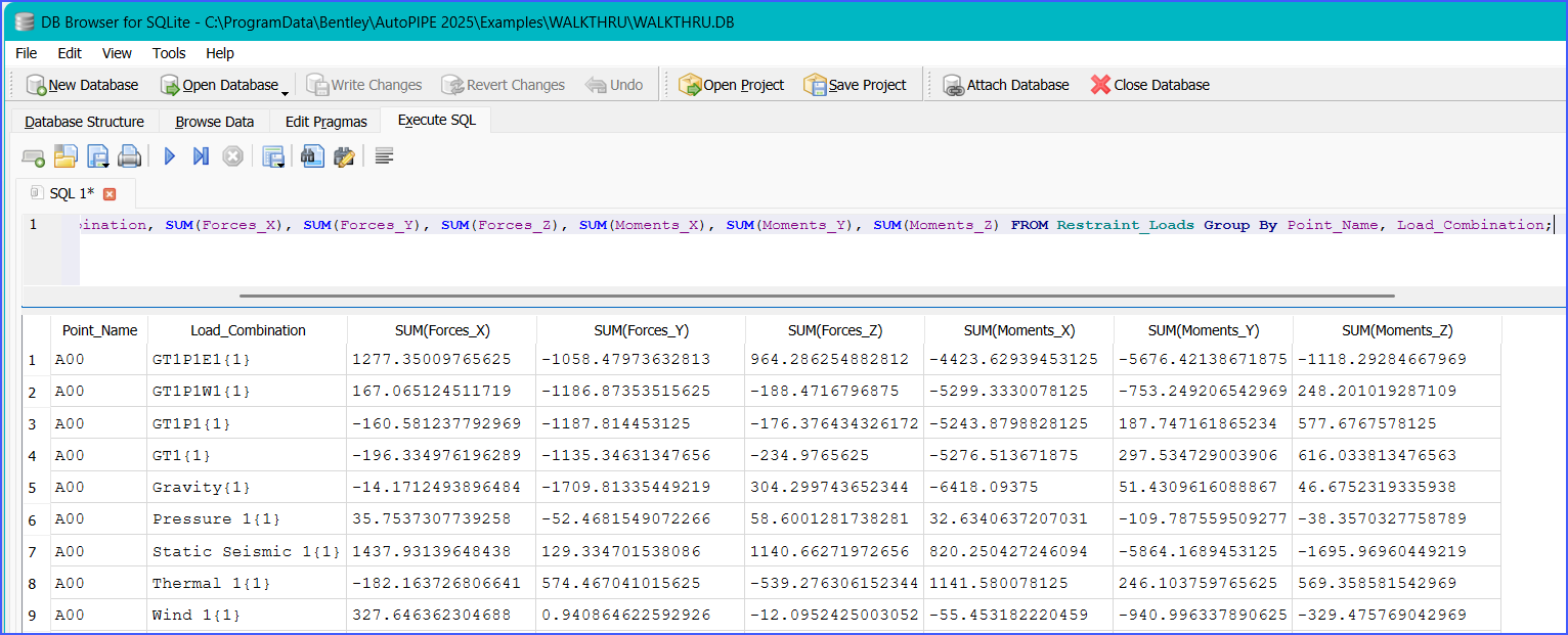

Option #2: Use DB Browser to help develop the correct syntax needed.
  1. Open DB database application (ex. DB Browser for SQLite), and open DB file in same folder as the model (note, in some instances, after opening the file, press the Refresh button in the DB software to correctly see the DB data).
  2. Pick the Browse Data tab and select the Restraint_Loads table from the dropdown listing to see the DB data for this table.
  3. When crafting a new SQL operation, pick the Execute SQL tab.
  4. The syntax will need basic information, SELECT information FROM a specific Table, and do something (ex. Group By).
    1. Example:
    2. SELECT Point_Name FROM Restraint_Loads Group By Point_Name;
    3. Pressing the execute button will show the information retrieved from the database.
    4. This small example helps confirm the database is loaded into the software and that the syntax correctly retrieves information from the Retraint_Loads table.

  9. The Syntax would appear like this:
    • SELECT Point_Name, Load_Combination,Forces_X, Forces_Y, Forces_Z, Moments_X, Moments_Y, Moments_Z FROM Restraint_Loads Group By Point_Name, Load_Combination;
  10. Executing this line displays the following results:

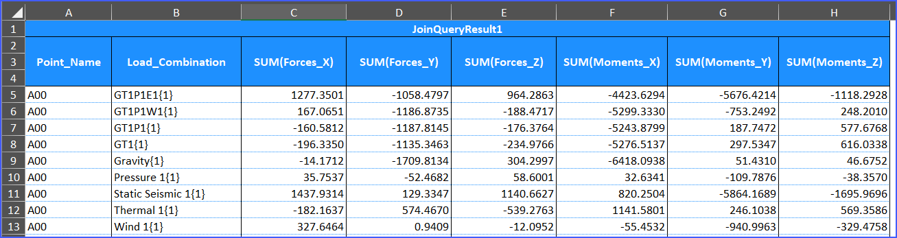

  11. Next, apply SUM mathematical expressions to this Syntax to sum all the forces and moments:
    • SELECT Point_Name, Load_Combination, SUM(Forces_X), SUM(Forces_Y), SUM(Forces_Z), SUM(Moments_X), SUM(Moments_Y), SUM(Moments_Z) FROM Restraint_Loads Group By Point_Name, Load_Combination;
  12. Pressing Execute button on this expression will result in:
  13.  Always confirm the results are correct, before using this expression in production.
  14. Assuming the summation was performed correctly, copy this expression back to AutoPIPE's SQL tab and paste it.
  15. Press "Generate report" button, and in a moment press "Open Generate report" button
  16. Done.
