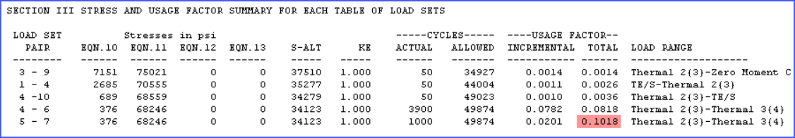

Finally, Level A/B and Level C usage factors are summed up in the output report "Cumulative Usage".
Usage Factor Summary Table
This table summarizes all the critical Load Set pairs with corresponding number cycles.

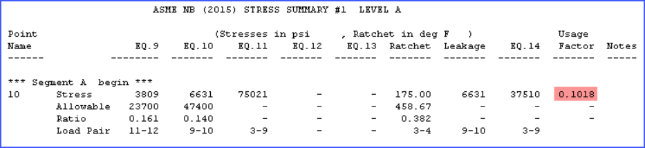

Stress Summary Table
The final cumulative usage factor from the fatigue report is added to the stress summary table as shown.
