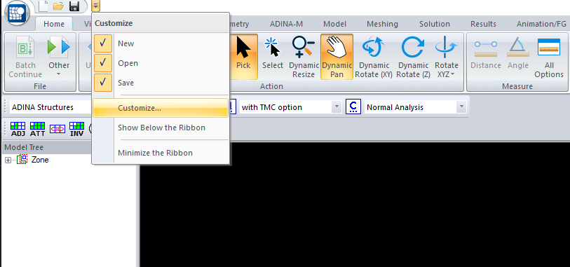

Ribbon bar improvements (Windows)

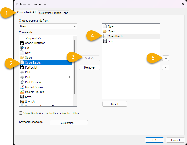

An option to customize the Ribbon menu has been added to the program. Access the customization from the Quick Access Toolbar (QAT) drop down or right-click anywhere in the Ribbon menu and choose Customize. This enables adding commands to QAT and to the larger Ribbon menu tabs.
To add a new item to the QAT select the command from the list on the left and click Add>> Then adjust the position of the new command using the up or down arrows.

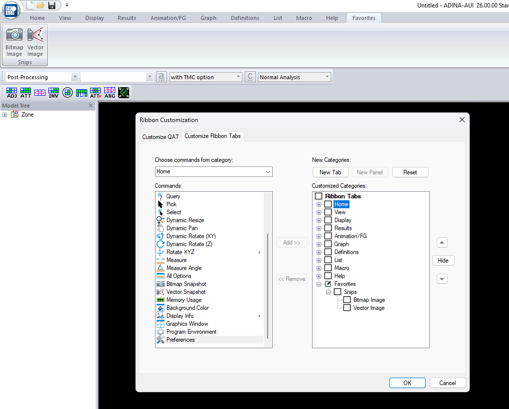

To add commands to a new menu or tab select Customize Ribbon Tabs and add a New Tab. Click once on the New Table label and then type over it to rename the tab. Then select New Panel to create one or more new panels or command groups under that new tab. Rename each panel in the same way as tabs. Finally add specific commands to the panels and adjust the order as needed.
The original installed tabs cannot be modified. To revert to the original configuration of all modules click Reset.
Each mode in the Program Module drop-down list (ADINA Structures, ADINA Thermal, ADINA CFD, ADINA EM, and Post Processing) has an independent ribbon menu configuration. If you want the same commands to appear in both Structures and Post-Processing modules, for example, repeat the same steps for each mode.
Ribbon menu customizations are saved in the Windows registry and user data file folder for the current user.
