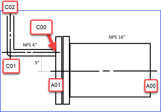

How to model a flange connection between two pipes where the 4" small bore piping is offset from the large bore piping respectively as shown below.
Suggest the following steps
    1. First model the large diameter pipe as needed (ex. A00 to A01).
    2. Insert the flanges on A01
    3. Next Insert a new segment starting at Dy=5” offset from nodepoint A01
    4. Insert bend and continue piping.
    5. Make C00 the active node point, insert Anchor/NodeLink “Connected to” A01.
    6. Lastly, insert user SIF at C00 to account for SIF connection to Flange.
    7. Done.
