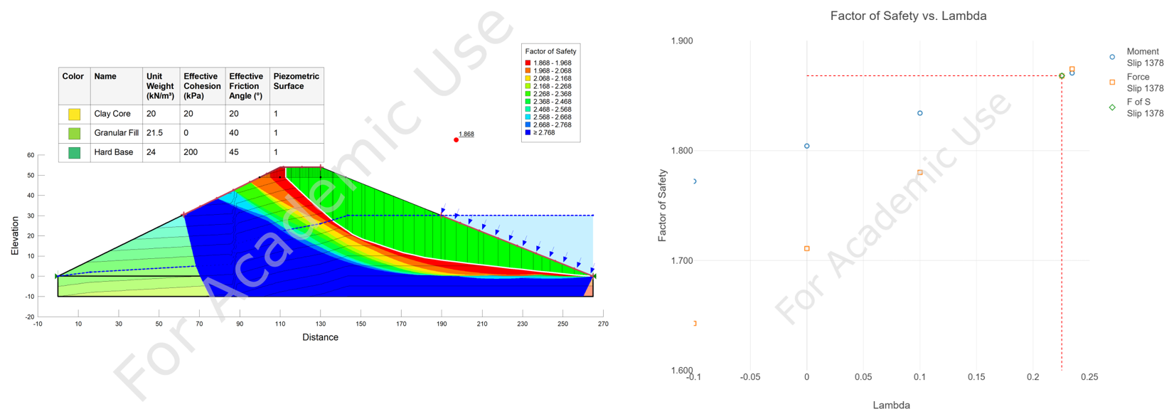

GeoStudio
Watermarks are embedded in exported figures, charts, and reports available in Results and Page Layout. They are typically displayed as a text overlay, such as “For Academic Use,” and remain visible in screenshots and printed documents.

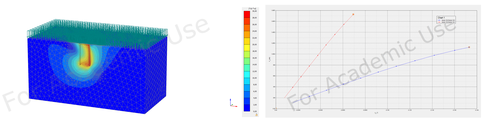

PLAXIS
Watermarks appear in the output program and SoilTest results, and are retained in screenshots, printed reports, and exported images and graphs. The watermark is usually placed in a way that remains visible regardless of cropping.

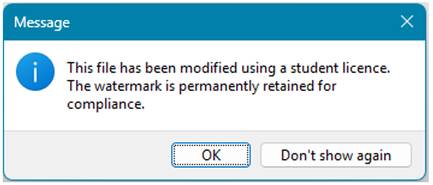

How student‑licence model Files behave when opened in professional or non‑student versions
Model files saved using a student licence permanently retain watermarks for compliance purposes. Even if these files are later opened in a non-student licence, such as a commercial version or an academic licence, the watermarks will remain visible.
Users will receive a warning message before saving a model with a student licence, and a similar notification appears when opening and saving student-created files in non-student licences, ensuring transparency about the watermark’s permanence.
