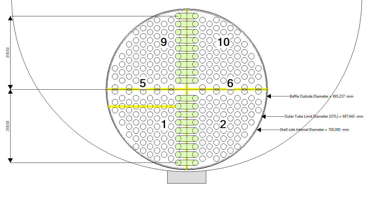

Users may experience invalid tube layouts or interference between tubes and partition plates.
In this case, when attempting to generate a 10‑pass horizontal U‑tube bundle, the computed bundle layout appear incorrect after clicking Compute, with partition plates overlapping or conflicting with tube positions.
Root Cause:
The issue occurs when the Partition Plate checkbox is left enabled during bundle computation.
In APV:
- The Partition Plate checkbox indicates a user-defined location
- When checked, APV does not recalculate or adjust the partition plate location
- This can cause tube interference or incorrect pass configuration if the location was not explicitly defined by the user

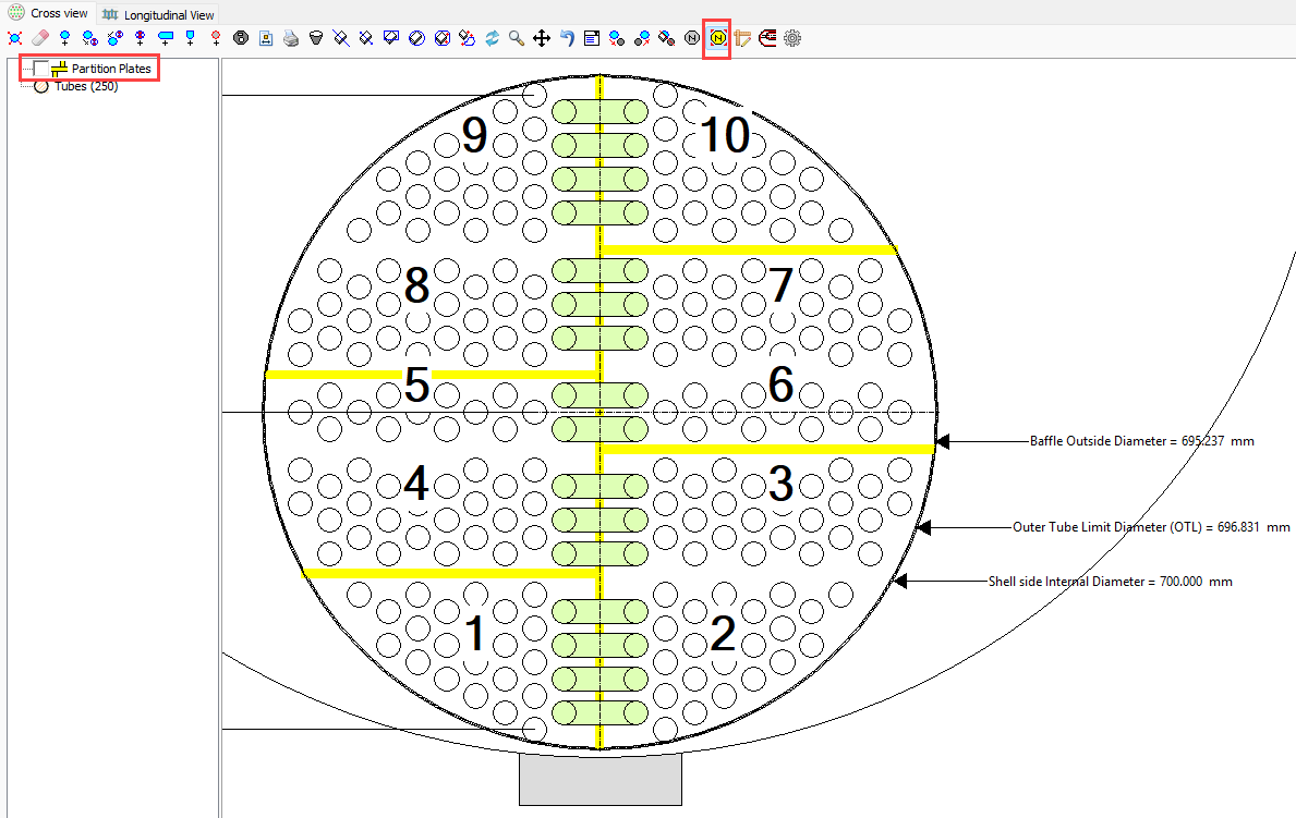

Correct Workflow (Resolution):
Method 1: Automatic Partition Plate Placement (Recommended)
To allow APV to automatically calculate a valid tube and partition plate arrangement, follow the steps below:
- Uncheck the “Partition Plate” option
- This allows APV to automatically determine the correct location.
- Click Compute to generate the tube bundle.
- APV will correctly generate:
- 10 passes
- 125 tubes (250 holes) for the U-tube configuration
- Review the generated layout.
Notes
- This is the correct and intended workflow, not a workaround.
- Unchecking the option enables automatic positioning by APV.

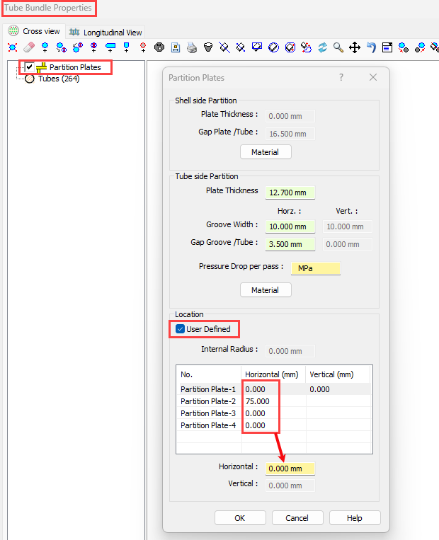

Method 2: Manual Partition Plate Placement (User-Defined)
Use this method when a specific partition plate location is required.
Steps:
- Open the Bundle Layout.
- From the Accessories list on the left side, double-click on “Partition Plates.”
- Enable the User Defined option.
- Enter the correct location for each partition plate.
- Click Compute to generate the updated bundle layout.
